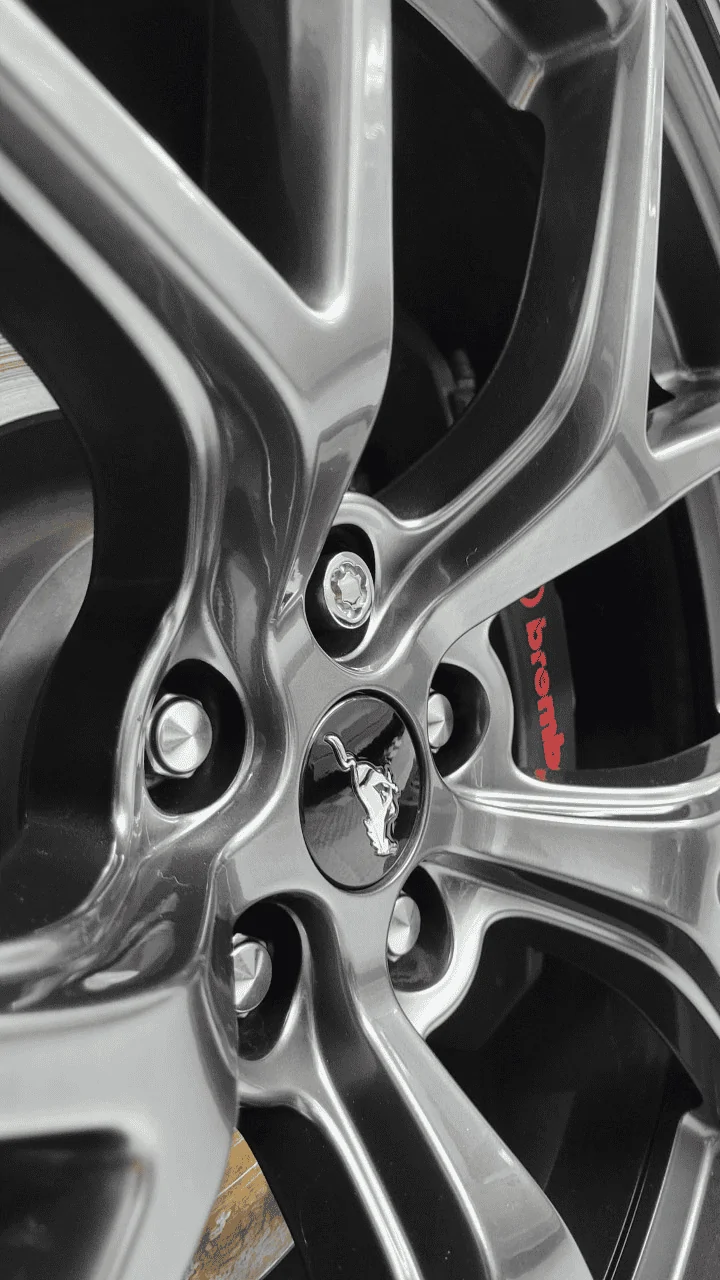

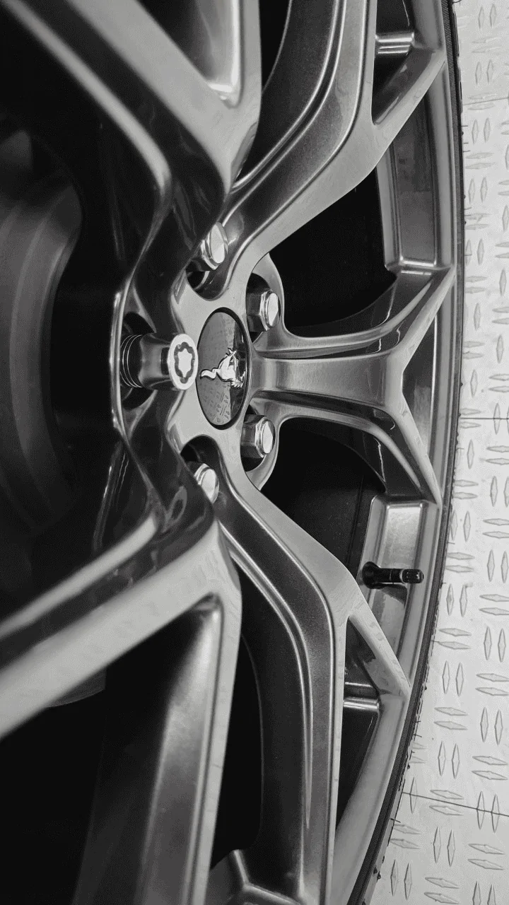

That's definitely odd.
Have you tried it in different holes?
Sure it's not cross threaded?
Nothing in the thread barrel of the lock?

Thanks . . . there's clearly a difference between the wheels as far as lug nut recess depth/lug nut flushness is concerned.
I'm not surprised, either. I have Forgestars (same width, different offsets) that do the same thing.
If you look at the back sides of the front and rear wheels together, you should be seeing a difference in the thickness of the wheel hubs - how much thickness exists behind the back sides of the spokes.

No cross thread. It might be as Norm above said. The offset? I did take each wheel off a few days ago to clean behind them. I don't remember if They were sticking out like that before. Maybe there is a "special" hole for the lock? If so, I aimed perfect on the front but missed on the rears!
No.
Look at the pictures you posted, not for the locking lugnut but for the four 'regular' nuts. They're clearly setting deeper into the front wheels.
Rear wheel - ignore the locker, the regular nuts clearly poke out a little. The lugnut recesses simply aren't as deep (any of them).
Front wheel - the regular nuts are clearly recessed into what has to be deeper holes.

Yes. I do see that the front lug nuts are set in deeper in front. The rear the nuts protrude more. So what could that mean?

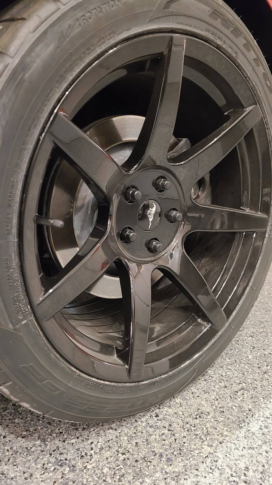

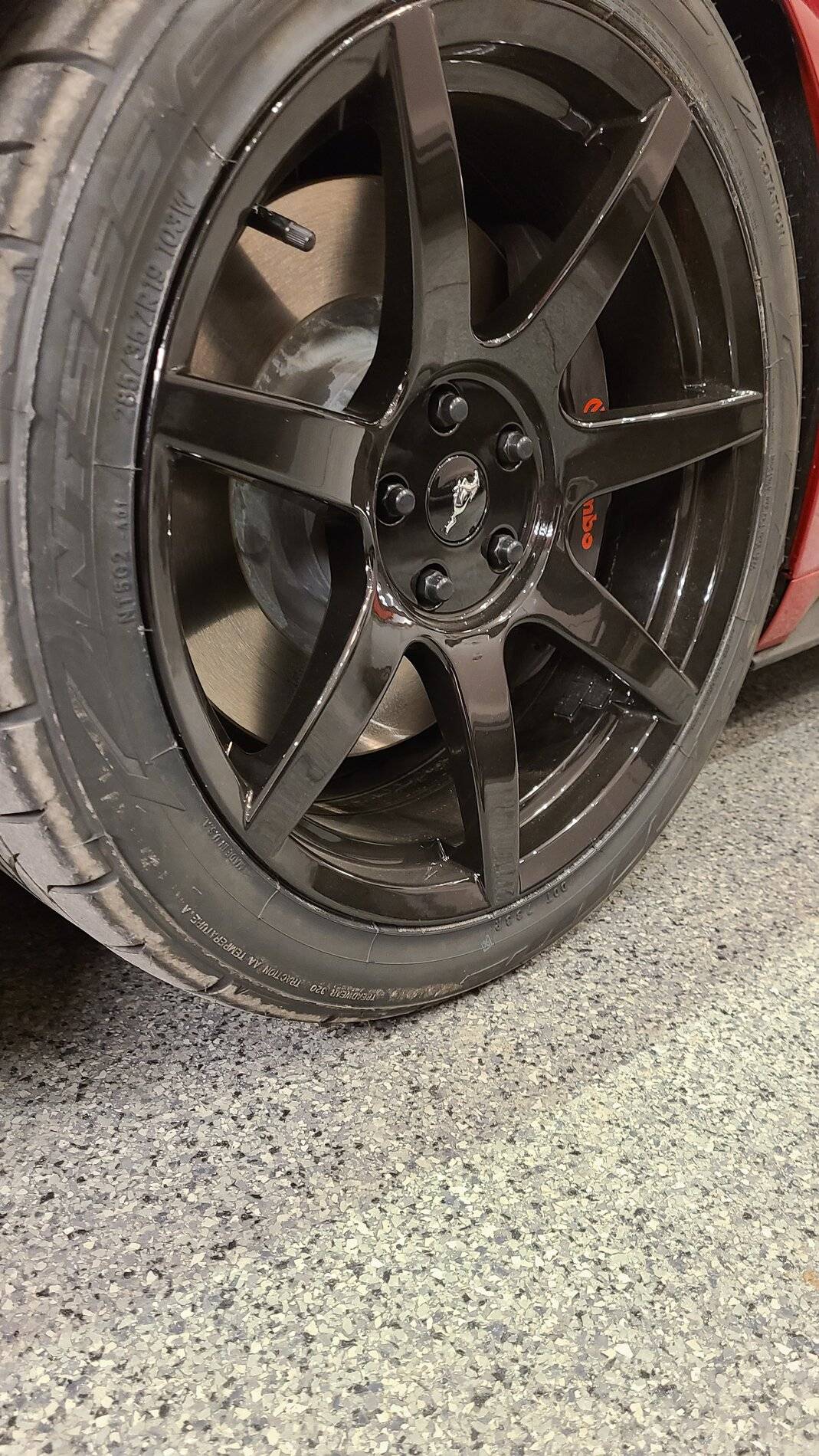

It means the front wheels have a wider offset, that's all that's going on here. For clearance reasons with how wide the front tires are on the PP2.
The wheels on the front are 10.5 rears are 11.

I have project 6gr wheels and my front lugs are more flush with the wheel itself. My rear lugs stick out much further I personally think it looks more aggressive with the rear lugs sticking out.
I have them too. I am using Gorilla lug nuts front and rear.
I put the 1.4" on rear and 1.9" on front.
They now are even (both have 1/2" of lug sticking out like original lug on rear)
Part # 41147 BC (1.4", black)
Part # 41147 XLBC (1.9", black)
