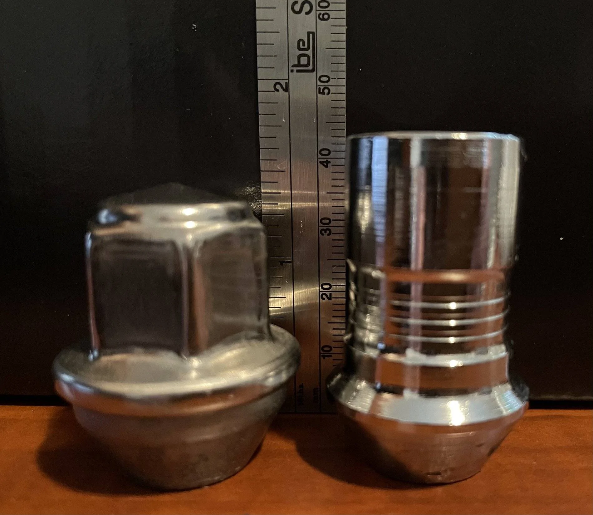

I should correct myself and say lug nut length is the same. Not sure why the depth into the wheel is different. I would guess the rear has more material from the cone of the nut to the inside of the wheel/hub. I'd have to pull one of each off and look.
The Gorilla locks are quite a bit shorter than the factory McGard brand.
Here's a picture of the stock lug and fugly locking lug.
