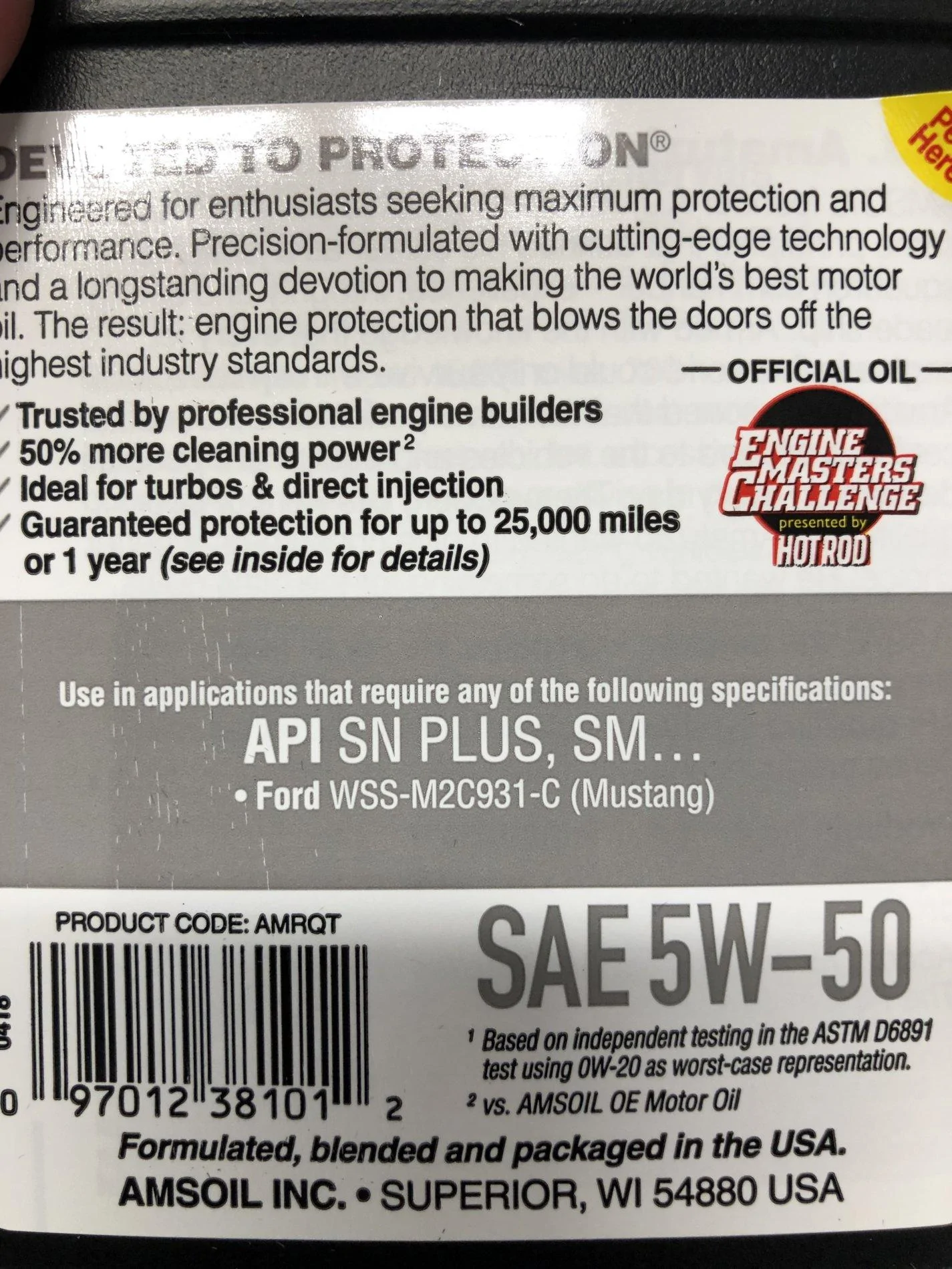

No image from the bottle (from work), but here's a link directly to the product data bulletin. Amsoil was 931-C compliant even before Ford changed the spec for the car (used to be 931-B) But it's backwards compatible if you have a '15-'16 still calling for -B.
https://www.amsoil.com/lit/databulletins/g2880.pdf
Unfortunately, that's the vague language I was referring to. It says "Use Amsoil ..." which is not a declaration of quality, it's just words. The reason i say that is that all of the Signature Series oils on the list show API SN PLUS. However, if you go to the API website and look up Amsoil products that are actually API approved, you'll discover that none of the Signature Series oils are listed because they're not actually approved. Amsoil XL and OEM oils plus some of their diesel products are listed, but that's it.
Link: https://engineoil.api.org/Directory/EolcsResultsDetail?accountId=-1&companyId=10079&resultsUrl=/Directory/EolcsResults?accountId=-1&companyName=amsoil
Similarly, even though they call out Dexos 1 Gen 2, there are no Amsoil products listed by GM as approved: https://www.gmdexos.com/owner/brands/dexos1/index.html
Hence my question - what does the label on the bottle say about Ford 931C approval? Does it do what the Lucas label does and say that it meets the Ford specification?

Hmm...after further research it does appear that AMSOIL uses some lawyer-ey language. "Use in" application vice "meets or exceeds". This is might just because they didn't get an official certification (which I assume has costs associated with it) and is probably fine. But I did find that Castrol Edge Supercar 5W50 meets the Ford WSS-M2C931-C and is recommended for the Ford GT.

This is might just because they didn't get an official certification (which I assume has costs associated with it) and is probably fine. .
This is key and happens all the time. For several years, none of the SSO oils had any certification. And like many others have stated about similar products, does it mean that the oil fails to meet the spec requirements? Absolutely not. It means that Amsoil, for whatever reason, chose not to pay for or pursue the certification for that product. And yes, the bottle has the same language as the spec sheet. Guess it's a personal choice as to the product being good enough or not. While I agree with you @JAJ, I personally will not loose any sleep over the labeling. Amsoil is clearly a quality product that I know from talking to people that it meets the spec. Labeling? Semantics? Sales pitch? Marketing? Who knows...still a top shelf product and I personally think there's enough substance there that Ford could not hold against you for using it.

... it's a personal choice as to the product being good enough or not. ... I personally will not loose any sleep over the labeling...
I actually think that Amsoil makes good products. It's just that in an age where people are constantly bombarded by internet scams and wild and baseless marketing claims, it seems odd that they wouldn't take the simple step of at least validating the performance claims that are easiest to fact check. They're selling a premium product at a premium price - folks won't quibble if the price goes up a few cents a bottle to cover licensing costs. Besides, I'd like to think that they actually tested this stuff using industry standard tests - from there it's a short hop to getting recognition from the standards bodies that they passed. The whole thing makes no sense to me.
