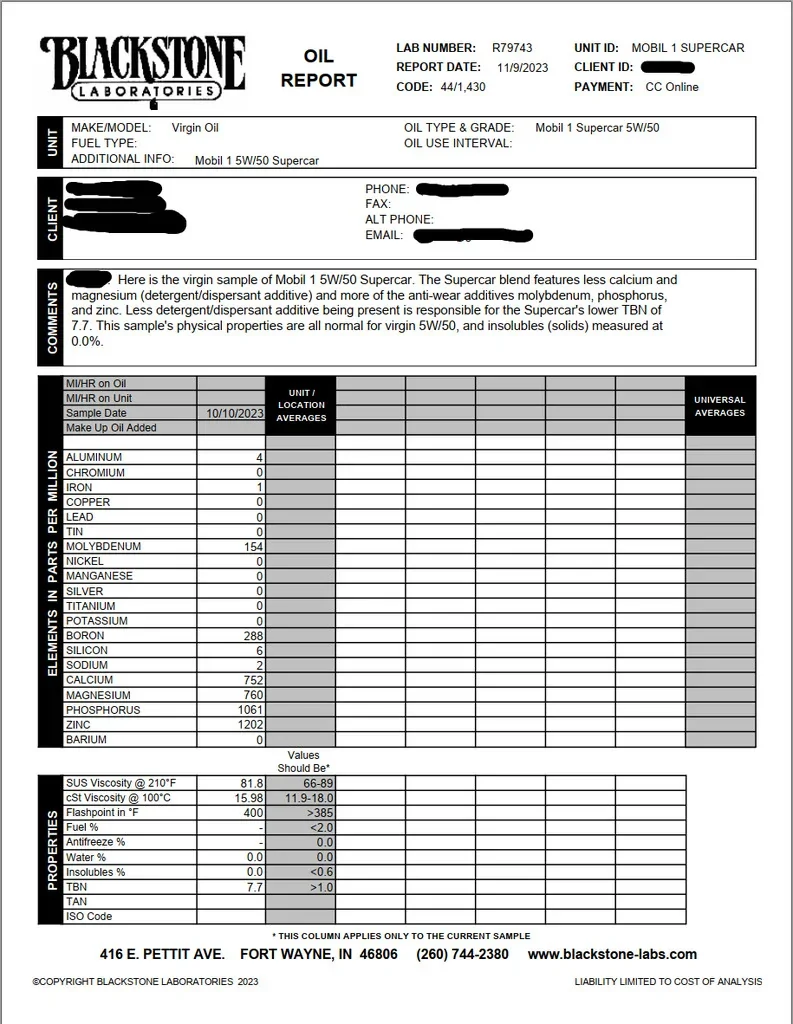

I know oil as a topic has been beat to death. I got a fresh oil change from Ford when I recently purchased my GT350R, and I've already purchased a spare oil change kit for when I'll do it in the future (in about a year). I will be going with Mobil 5w-50 Supercar. From my research, GM went with a really high ZDDP additive package but low detergent levels. I think this fits my usage case of not driving often, but when I do, I get it to temp and tend to drive it "purposefully." I also like the price at Rockauto.com (under $7 per quart).
Anyway, I'm a mechanical engineer and can't help but research this topic more... I just noticed that Lucas 5w-50 actually puts the GT350 on their bottle! Anyone using the Lucas 5w-50?
If anyone is curious, here's a UA from the Mobil 1 5w-50 supercar... Found here

Only thing I will say. The Blackstone analysis is all but useless. Use anyone else. As far as oil is concerned. Use what your engine likes. Turns out mine really liked Castrol, and loved eating Motorcraft. The shear values were terrible on the motorcraft in my car, and it would start consuming oil after about 500 miles (back when it was a road car too). The Castrol never was consumed.
By way of example. I could see particles in my oil and knew the bearings were letting go. Sent a sample just to see what they would said. "Engine looks great, keep doing what you are doing". I asked why they didn't comment on the particles in the oil, which are visible with the naked eye. "Oh we don't measure particles that big". Well I am no idiot, but I understand standard deviation, and know I should see higher levels of small particles too. But no. None. Engine was perfect according to them.
