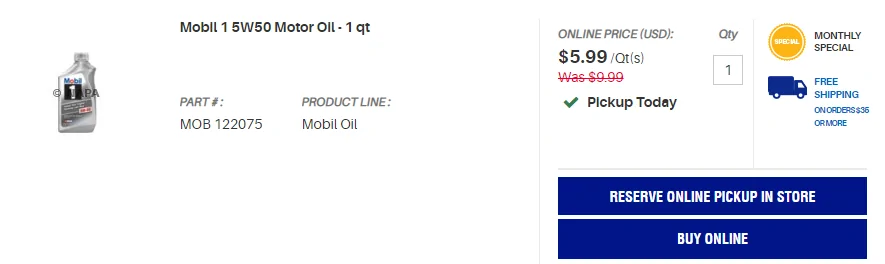

I have been buying Mobil 1 5W-50 in bulk from Napa Auto Parts stores.
It's been on sale for $6/quart for about a month now, however, ymmv.

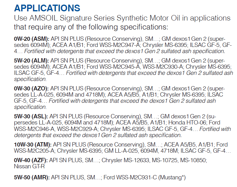

I seriously doubt that the Ford dealer is going to do enough analysis to figure out what brand of oil you are running, however AMSOIL does get the Ford 931-C stamp.
https://www.amsoil.com/lit/databulletins/g2880.pdf

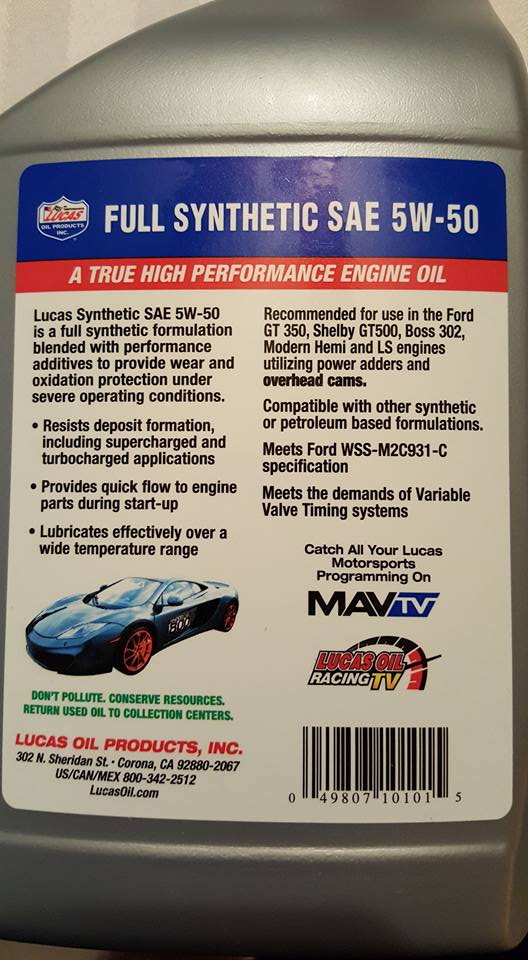

Going back to the OP's question, I found this in another thread on this forum:
That pretty much settles the question about Lucas meeting the Ford spec.
Note that it says "Meets" as opposed to the rather vague "Recommended for" or "Use where". That vague language is often interpreted to mean it meets a spec, but really it's just an instruction to the consumer rather than a statement about quality and performance.
Does anyone have an Amsoil label picture they can put up?

No image from the bottle (from work), but here's a link directly to the product data bulletin. Amsoil was 931-C compliant even before Ford changed the spec for the car (used to be 931-B) But it's backwards compatible if you have a '15-'16 still calling for -B.
