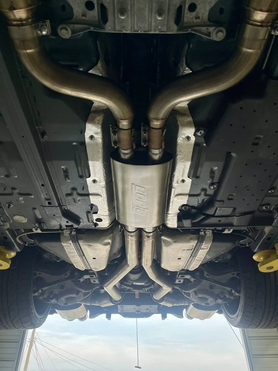

Just be forewarned, with the cat back setup you have currently, if/when you do headers whether catted or not, it will be STUPID loud and you WILL draw attention from LEO... Ask me how I know. I put the Borla resonator on mine (Texas speed catted with active S type) and it is much more tolerable...
Do you happen to have a vid of your setup good sir? This is the exact combo I was looking at getting.
When you say the borla resonator, which one are you referring to?
on my 17, I also did a resonator delete/x pipe, and ford racing sport mufflers by borla and it was stupid loud. so on my 23, I left the factory resonator there along with the factory active exhaust. so now it's only loud when I put it in track mode.
Here is the last cold start I did with mine after the resonator installation. Again, Texas speed, catted, S Type active with Borla 60661 resonator (Resonated H Pipe style resonator)... I don't have any good driving videos though, I need to make some..
