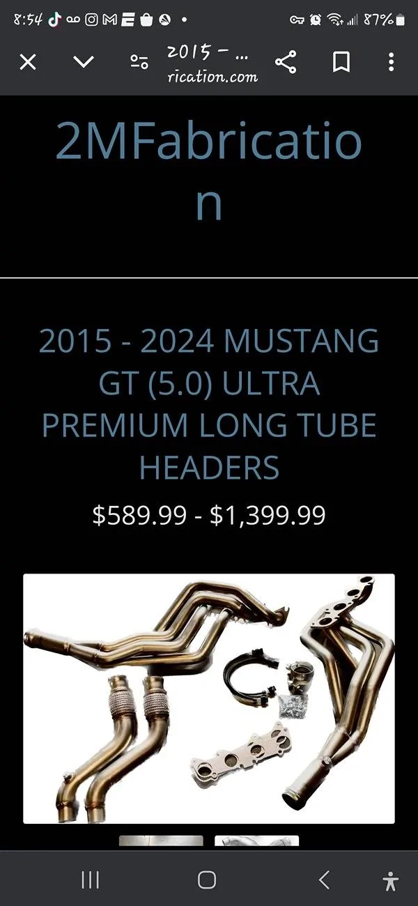

I run these with no cats I live in fla, easy install b issues
