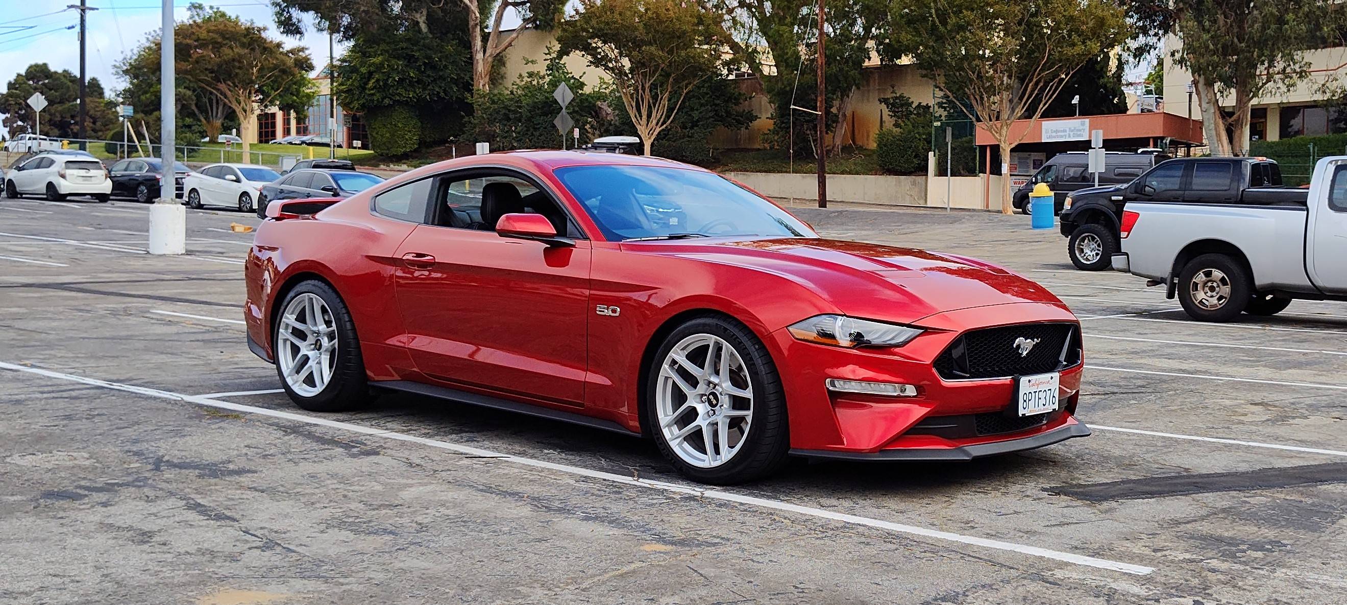

I didn't need camber plates nor the bolts to get my car dialed in to the recommended alignment specs for the Ford Racing Track kit. Beyond that then yes.
To the OP there is a lot of options from FP, Steeda and BMR. I went with FP as a whole kit. I wouldn't do just springs. I think coil-overs are more for the track crowd. I am running the Ford Performance Track kit and IMHO this is how a PP1 car should have came.

MIne was right on the money of the recommended specs of the FP track kit.
