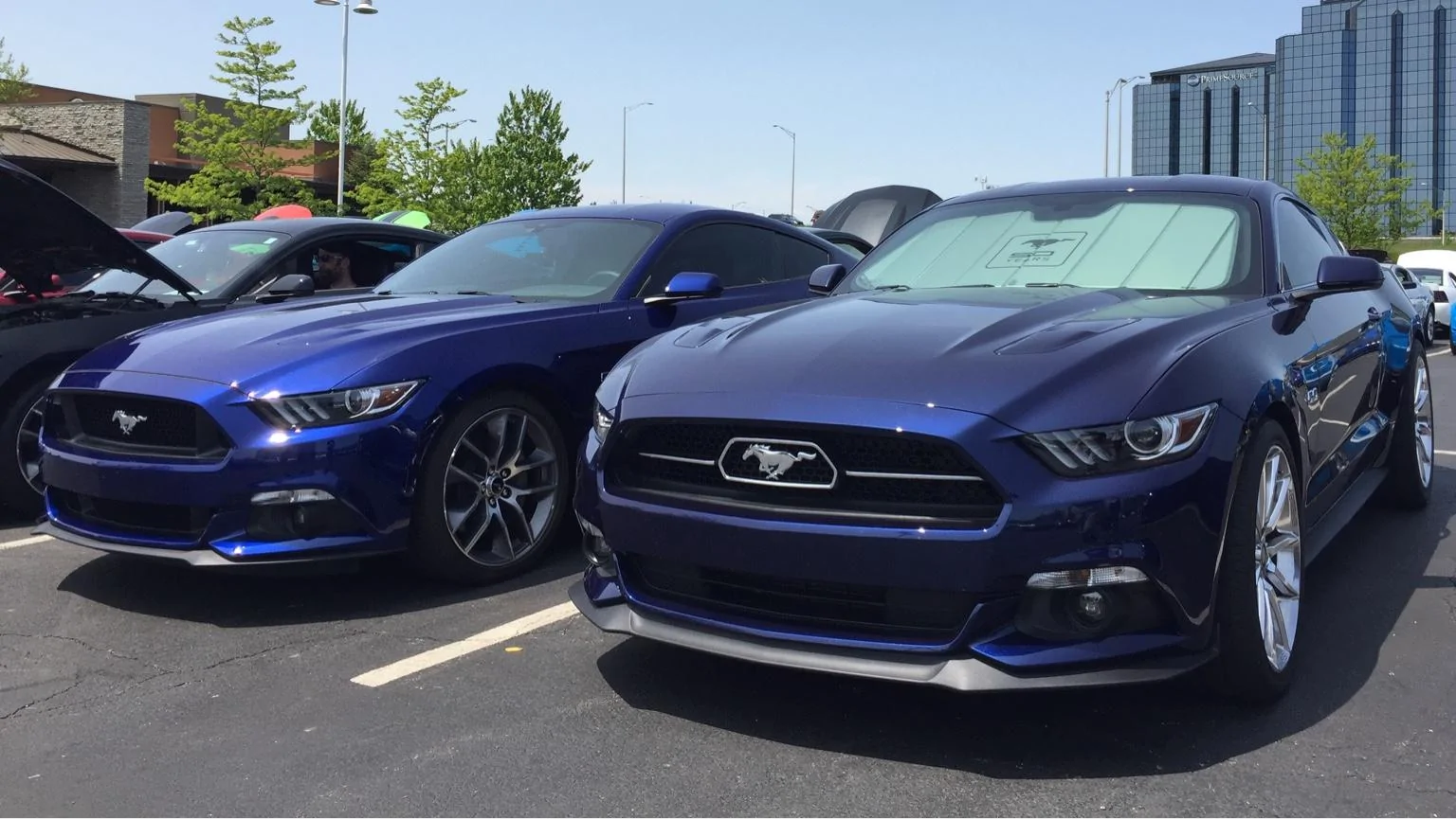

There's more to filling a wheel well than just the height. Don't forget to push those bad boys out to the edge of the fenders too. The offset on how far the tires / wheels stick out really makes a big difference. Look at the two pictures below. Both are GTs with 20" wheels. The DIB car's tires are almost 2" inside the fenders while the tires / wheels of the kona car sit right at the edge of the fender lip. Definitely makes a big difference in the way the two cars look.
Looks good. The DIB looks like it has camber plates and likely running 2-2.5 up front. You can really mess with a cars balance doing that, especially something factory setup like the GT350. I do like the flush look however.
