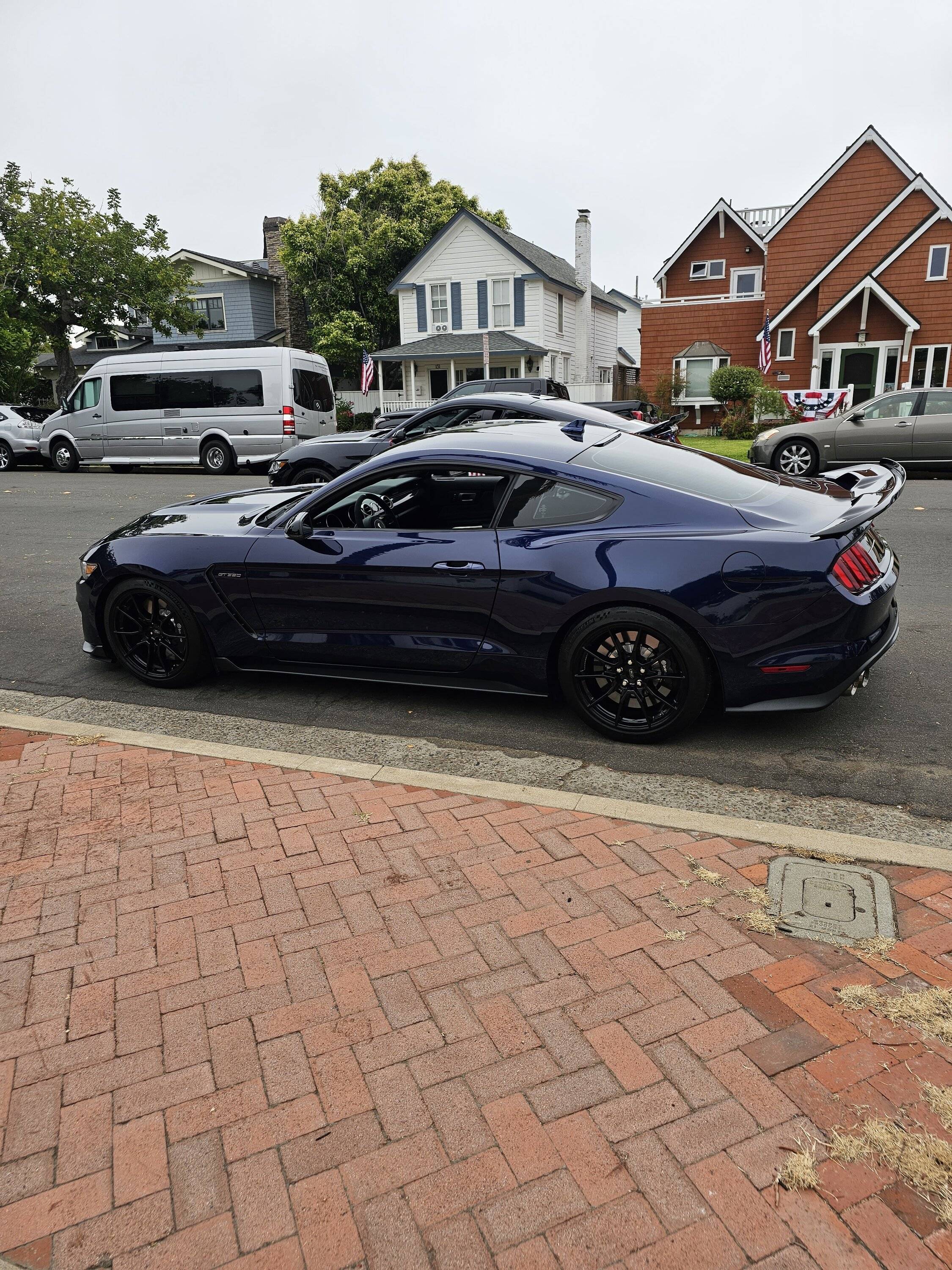

Installed FP lowering springs on my 2020 Gt350.. Love the look (with the stock 35 series) and no penalty on ride quality from my seat. Lowering it was a concern as I was scraping a bit on roads in SoCal. Going 20mm isn't going to help, but I'm even more cautious when driving to limit as much as I can. No regrets.

are those the frpp x street springs?
