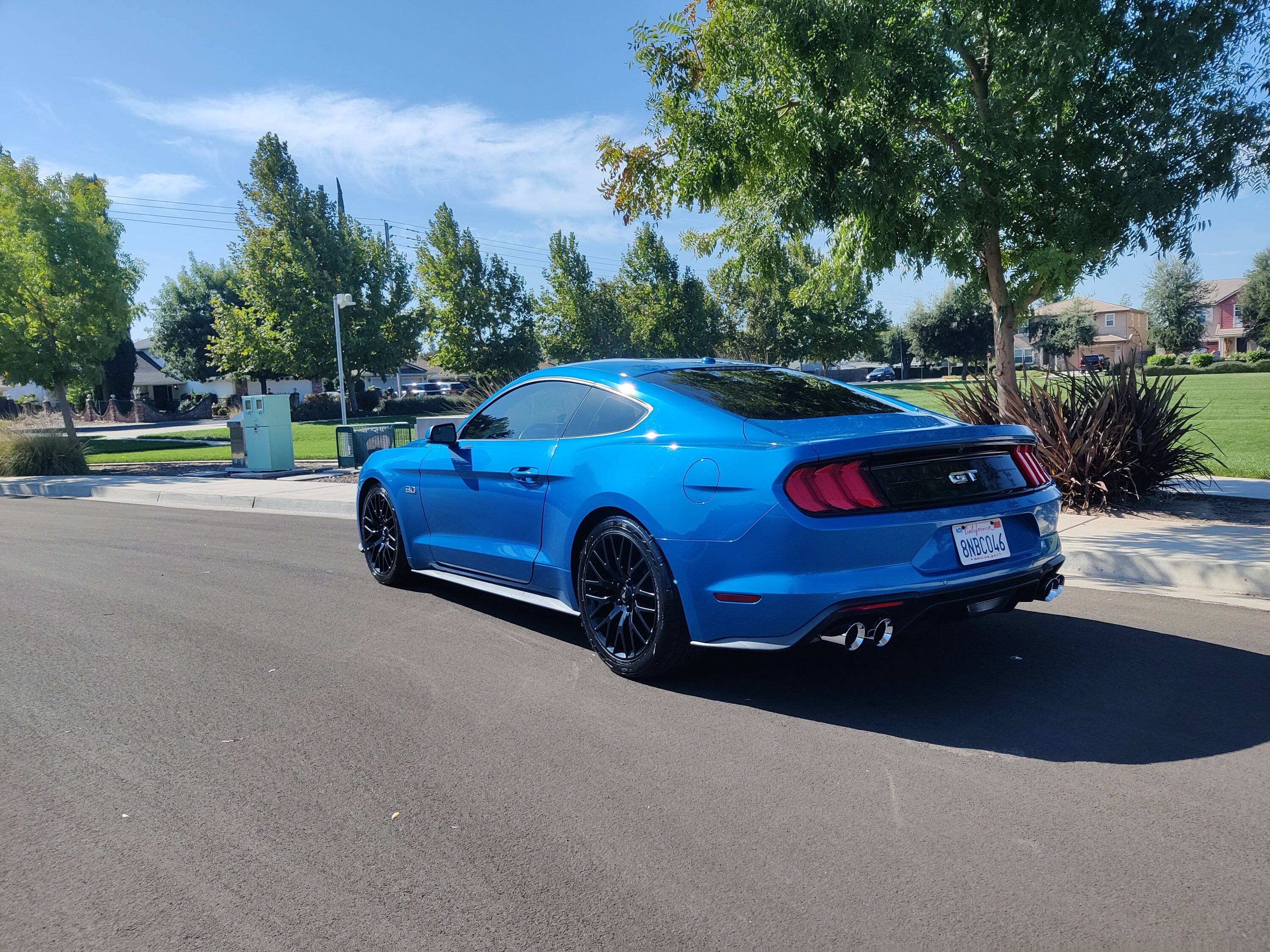

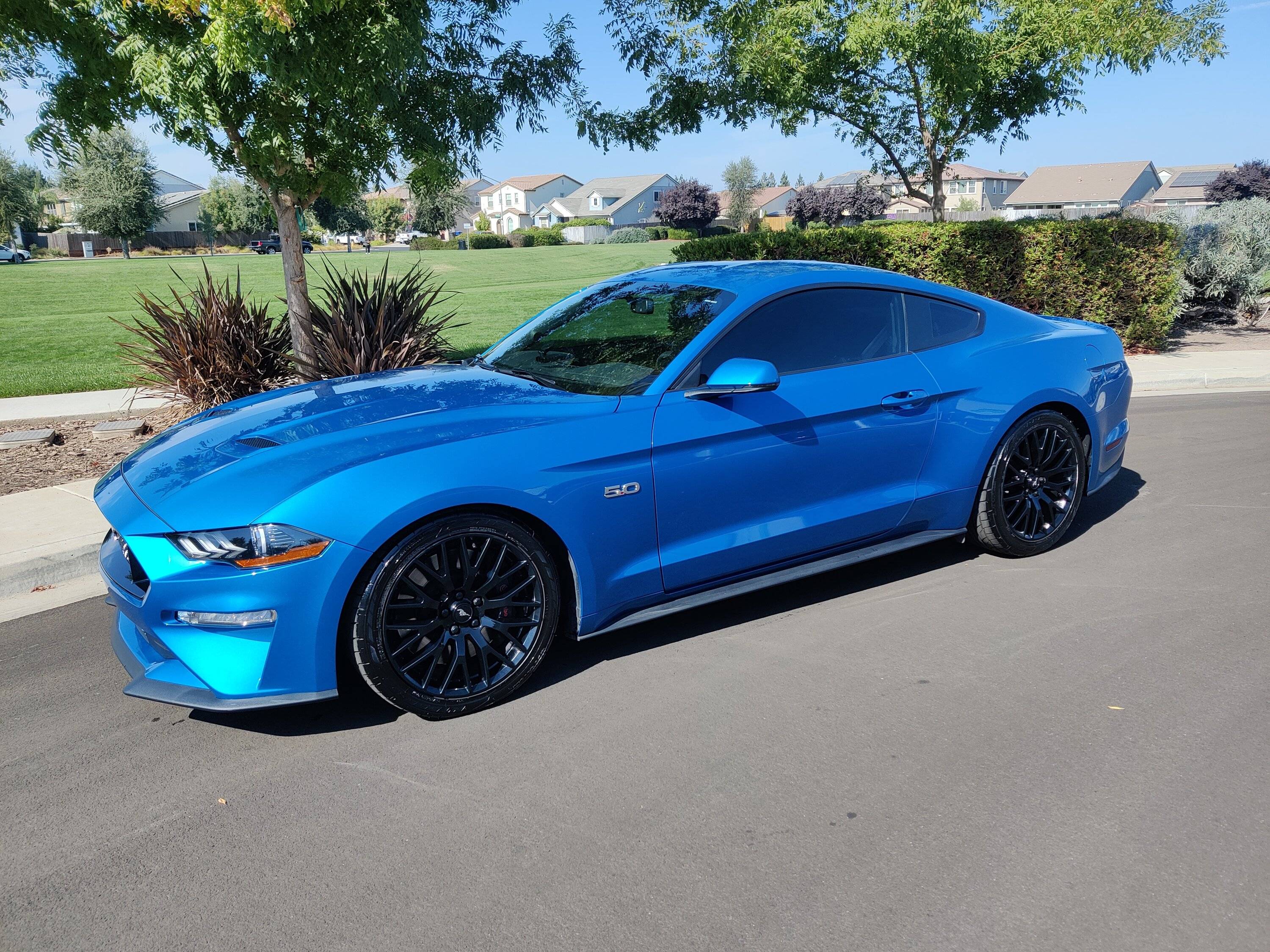

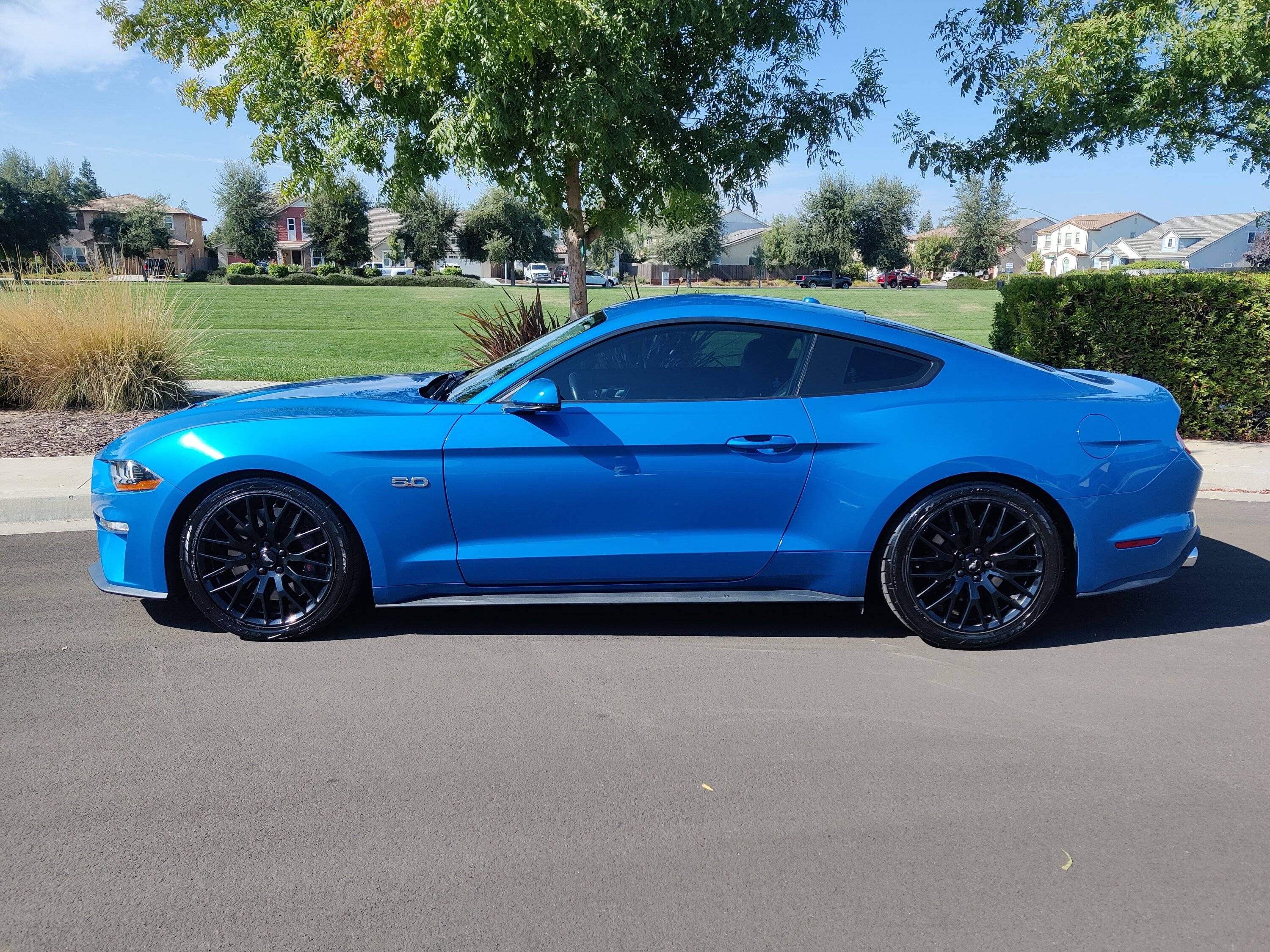

If you are looking for lowering, Ford motorsport springs will give you a .7 inch drop. I think that is the same spring they used on the PP2 track pack cars. Camber plates work but will add NVH to the car. And unless you have the tools to do adjustments yourself, it may be difficult to find a good alignment shop that will touch them. I removed my camber plates for camber bolts. Most alignment shops can make the adjustments. Also there is a small level of adjustment that will allow for a more aggressive negative camber setting. I have done several track days without any issues. Just FYI.
I have a 2020 GT, PP1, Ford lowering springs, Magneride, with Nitto Summer tires, and exhaust.
