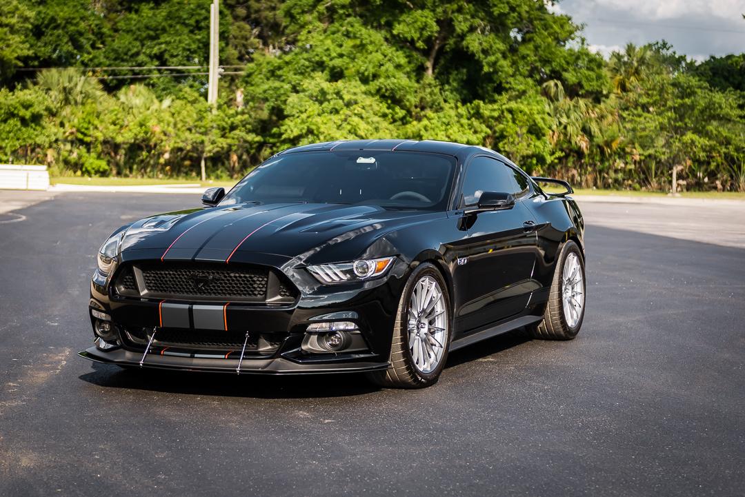

[MENTION=24290]RoushStang[/MENTION], car looks great! are you on stock struts and shocks? I on Koni yellows and BMR Performance springs, the car rides awful, Im thinking about removing the Konis and going with the stock struts and shocks, how is your ride? is it bouncy?

@RoushStang , car looks great! are you on stock struts and shocks? I on Koni yellows and BMR Performance springs, the car rides awful, Im thinking about removing the Konis and going with the stock struts and shocks, how is your ride? is it bouncy?
Feel free to call me to discuss.
This is something you will see more and more of in the future once hundreds or thousands of cars are equipped with those dampers. (regardless of springs)
Their valving is very aggressive. It always has been.
When you have aggressive valving with spring rates that are on the lower side of the spectrum, your "comfort" zone becomes much smaller.
On the SP080s, I typically do not go much higher than 1/4 to 1/2 turn on the rear and 1/2 to 1 full turn on the front. More than that, and I am not a fan of the ride, in terms of specifically comfort. :thumbsup:
