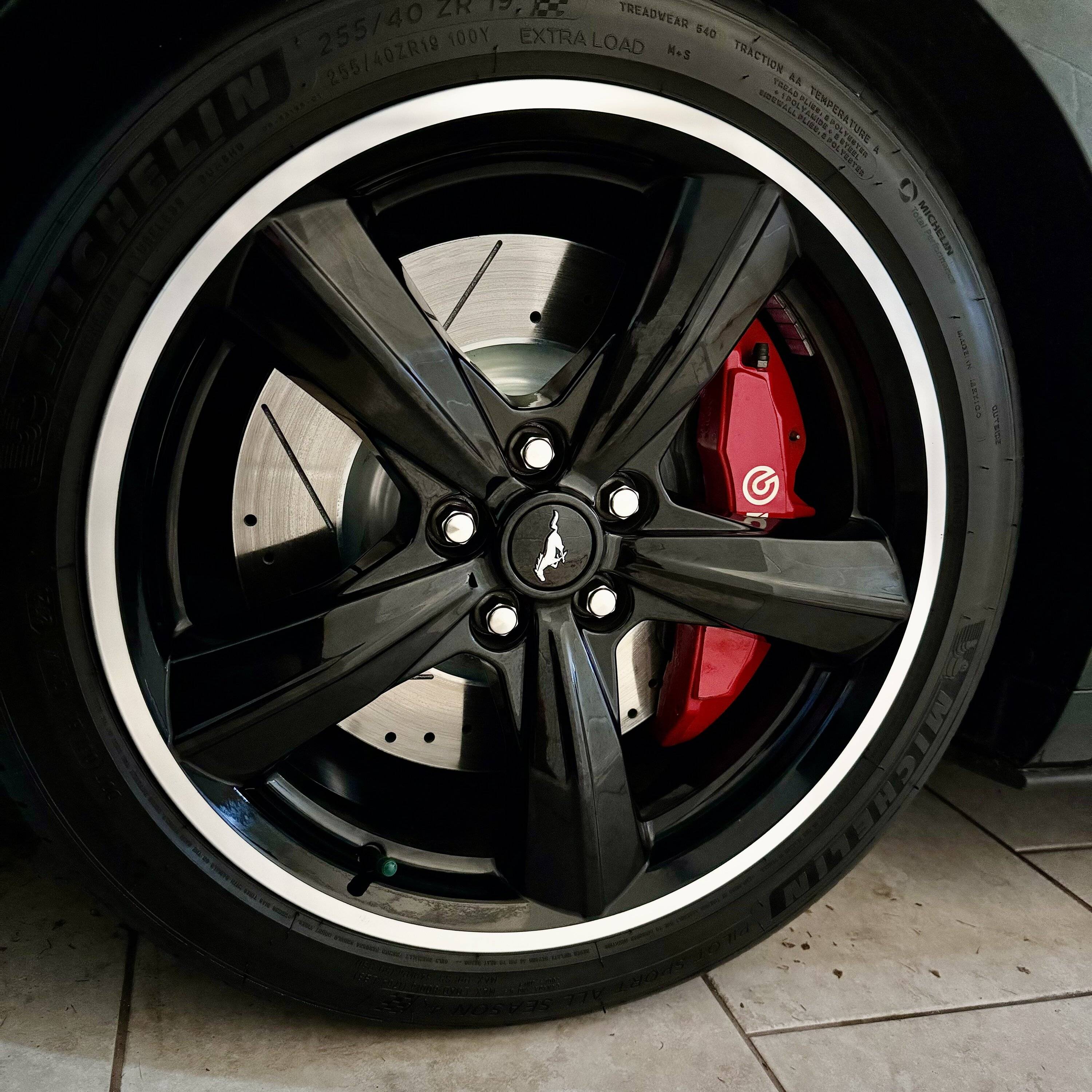

I replaced rotors and pads with the Z26 kit in October and have been driving as usual (~500 mi/mo) since then. The initial bite with the OEMs -- which I liked -- is basically gone. That said, for a weekend driver (or even a daily driver) that is not put on the track, I think the Z26s are fantastic. The rotors look so much tougher and the dust is reduced significantly. I'd say by like 70%. It's not zero dust, but much, MUCH, less. I'm very happy I did the swap. Thanks for all the great comments on this thread.
Feel free to ask questions -- hope this helps!
