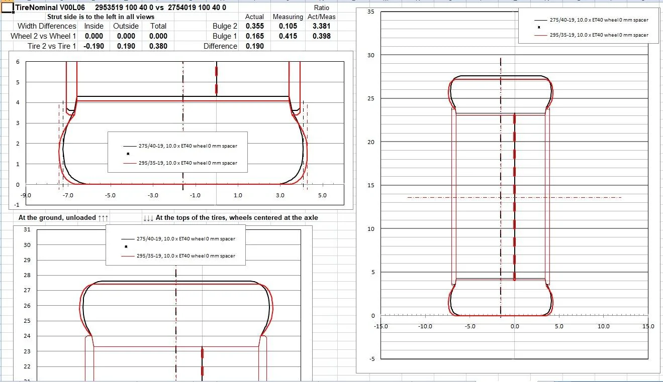

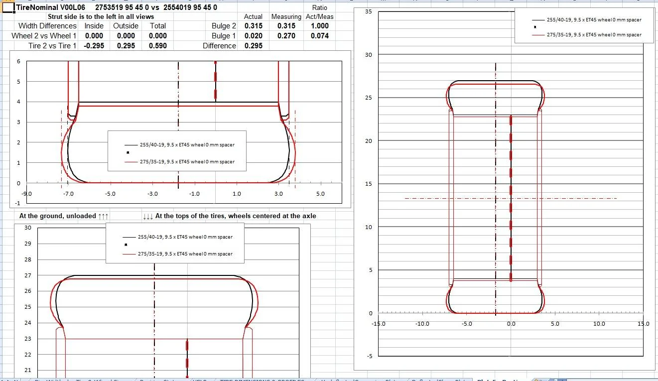

275/35-19 and 295/35-19 will work on the base Mach 1 wheels, but there will be a bit more sidewall bulge (around 0.2" - 0.3" more on each sidewall). Do you currently have more than that much clearance on the inside to things like the struts? Cornering may feel a bit 'softer', though I suspect that probably won't matter to you (else you'd have sprung for the H/P in the first place).
Front comparison (ignore the offset references):
Rear comparison:
Norm
