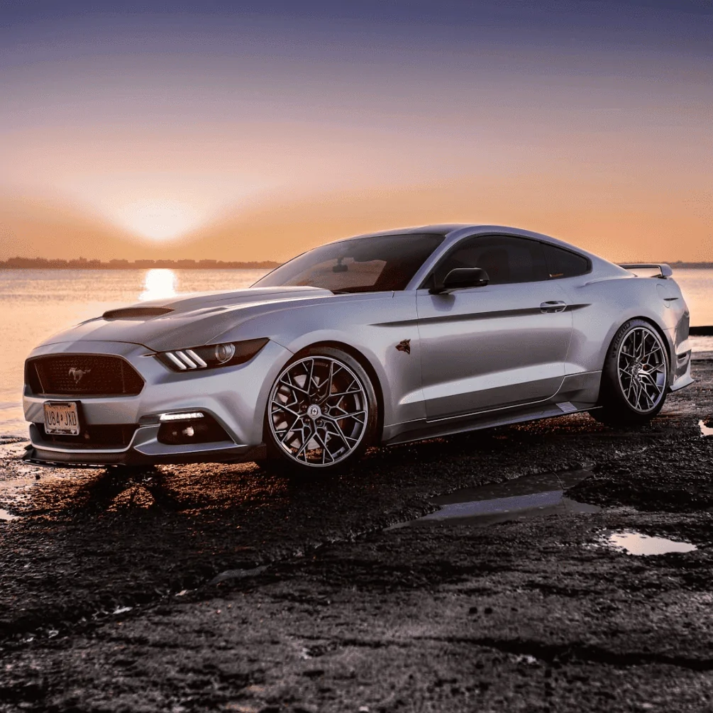

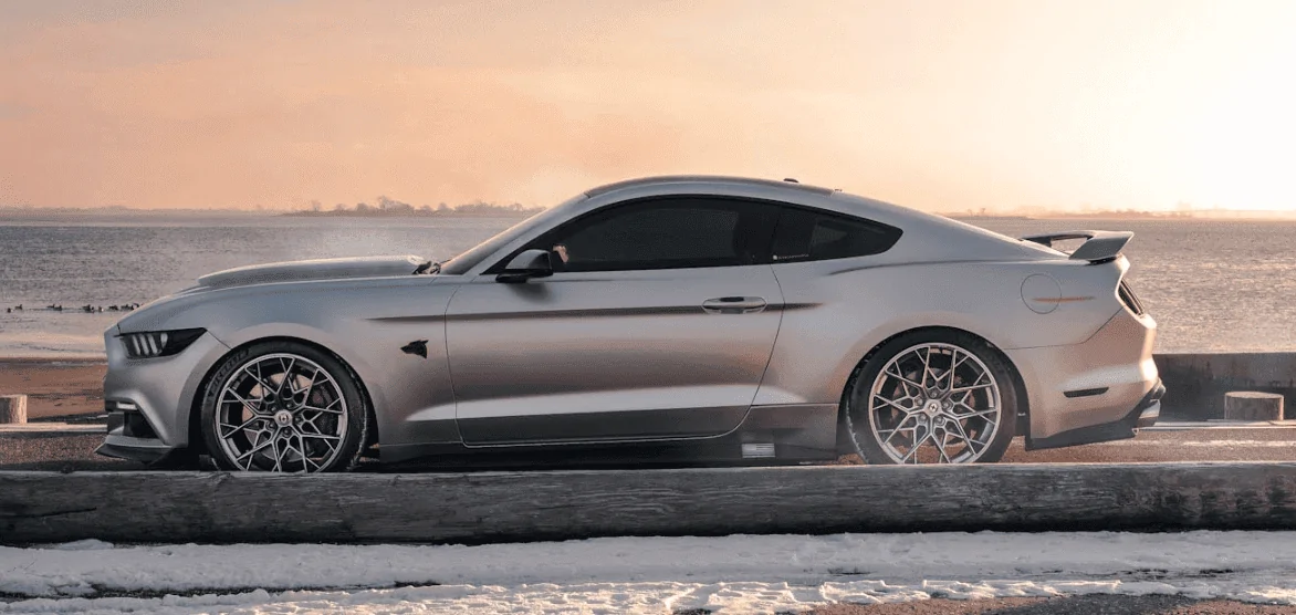

I was looking for 10-11" wheels locally available with TÜV certificate for Europe. So far I found only HRE (Flow Form) which have 1 option in 285/35 R19 and 305/35 R19 (sadly no PS4s in this size, only old Super Sport) and more options in same sizes but R20 (available PS4s). Price should be similar to imported PP2 wheels.
And funny thing, specifically HRE FF10 looks pretty similar to HP bird's nest wheels imo.
https://www.mustang6g.com/forums/th...s-vibe-motorsports.126685/page-8#post-3196752
Those look good. Very similar to the HP wheels

I was quite surprised, yeah, at least on first look from distance. With similar local price as importing Ford Performance PP2 wheels, similar oem diameter with small enough error and local legal papers for 285/305-30 R20 it sounds as a great deal, glad I found this option. Quality of them seems to be on high level. With ceramic coating these FF10 should be easily cleanable too and provide look similar to HP bird's nest if I won't chose FF04 instead.
Great video from their production too.
