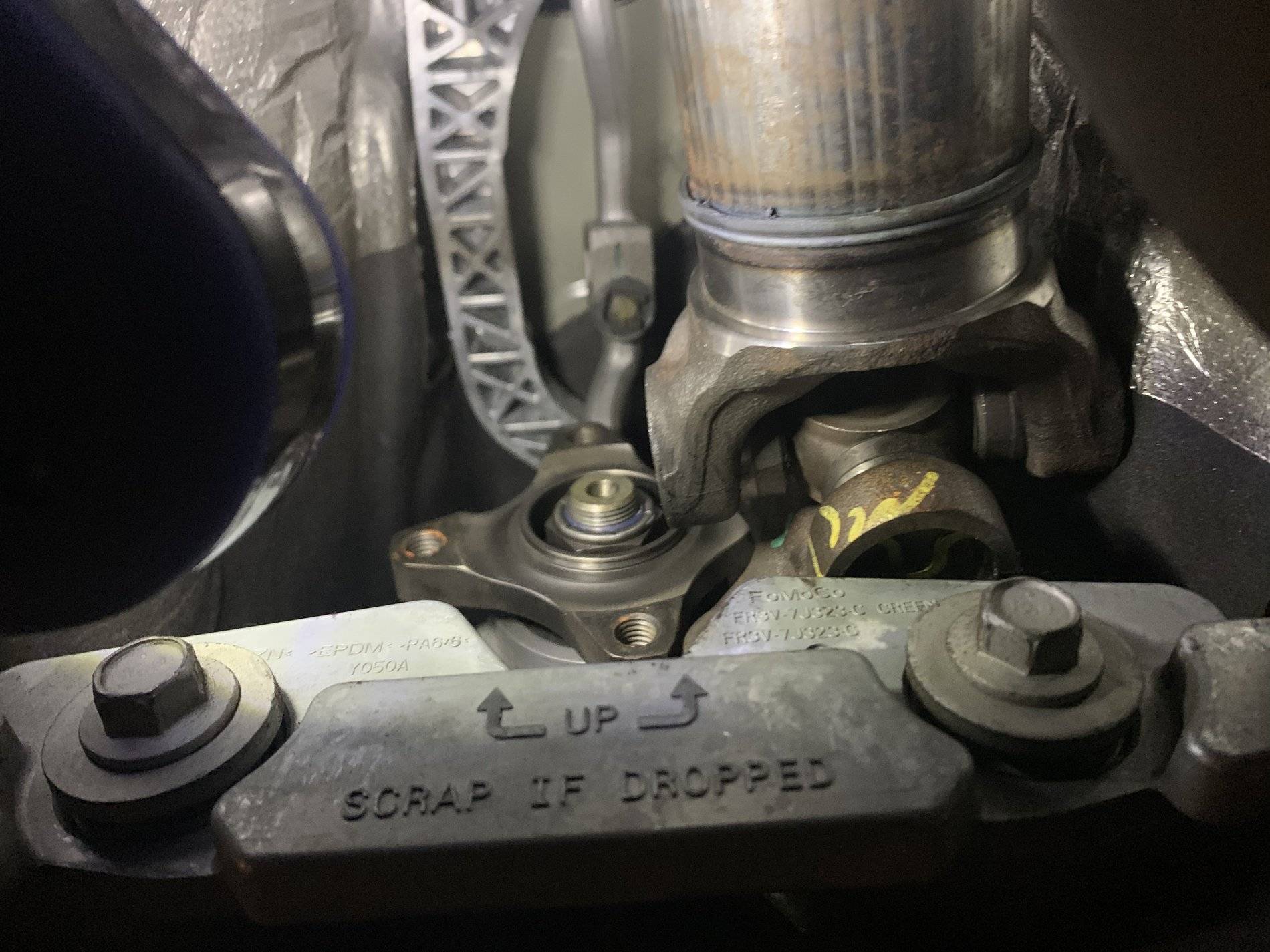

I had that exact same problem. Hesitations with bursts of revs during freeway cruising speeds but my cruise control would still be functional. It turned out to be the output shaft but was loose. I tighten it to 105 ft/lb with thread lock and the problem was gone.
Thanks for the input and photo. The car's still under warranty so I'll take it in and mention the TSB.
How loose was your output shaft? Was it loose enough that you could feel it with your hands or only when you put a wrench on it?
It was loose enough to spin it with a socket by hand. I was surprised to see how loose it was with only 15k miles on the odometer.
It turns out mine was the same way. I've been chasing a problem and thought it could be it. Turns out it wasn't but I'm glad I caught it anyway. I put mine back together with a little blue Loctite.
