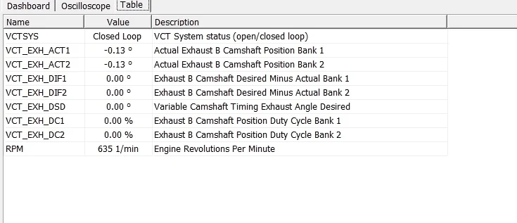

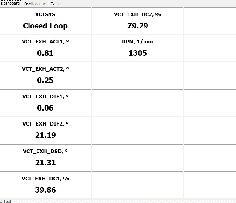

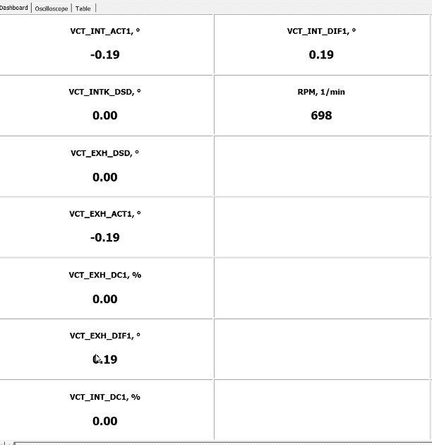

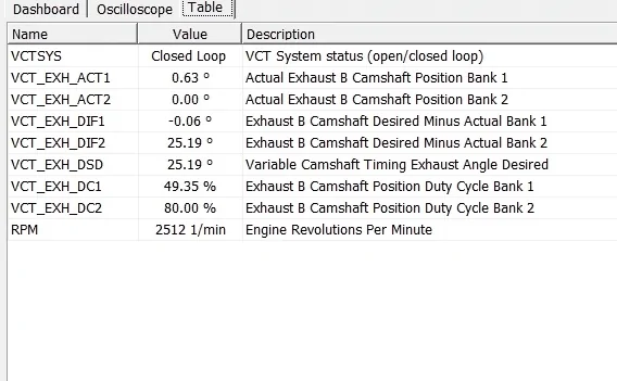

had another look at the files i took in forscan and from my limited knowledge it looks like my exhaust cam in bank 2 isn't moving that much? VCT solenoids were apparently swapped over in Bank 2 so original exh now in the inlet cam but same p0024 as before the swap (if they actually did it and that's an open debate) Out file is going to shops and in file is coming back home, funnily enough.

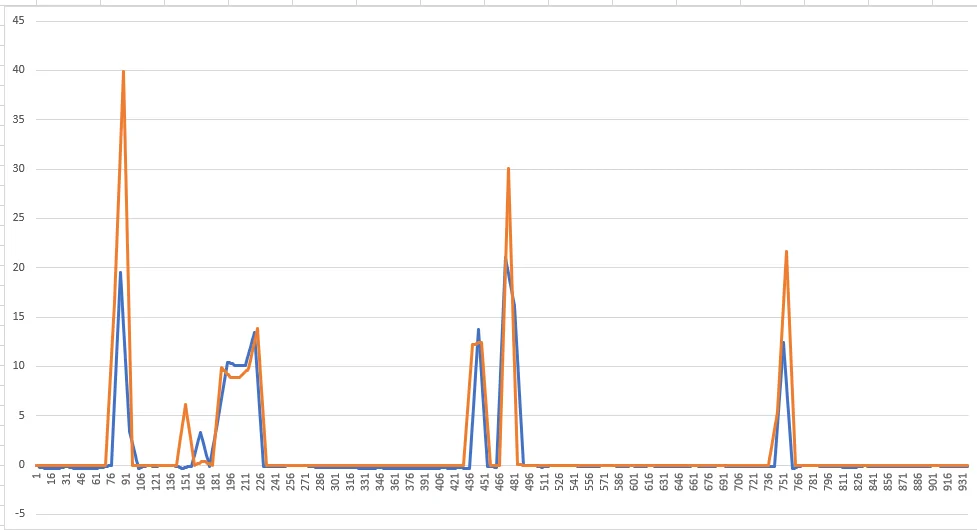

i added all items from forscan regarding VCT, recorded a datalog, exported a csv, imported into excel, added graph of desired exhaust angle vs actual exhaust angle.

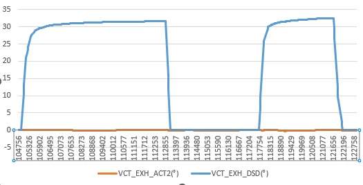

many thanks for your pictures, i tried something similar today and got this
hot idle looks like yours
hot engine rev blip
cold engine
this is EXT_ACT2 versus EXH_DSD which um doesn't look great
