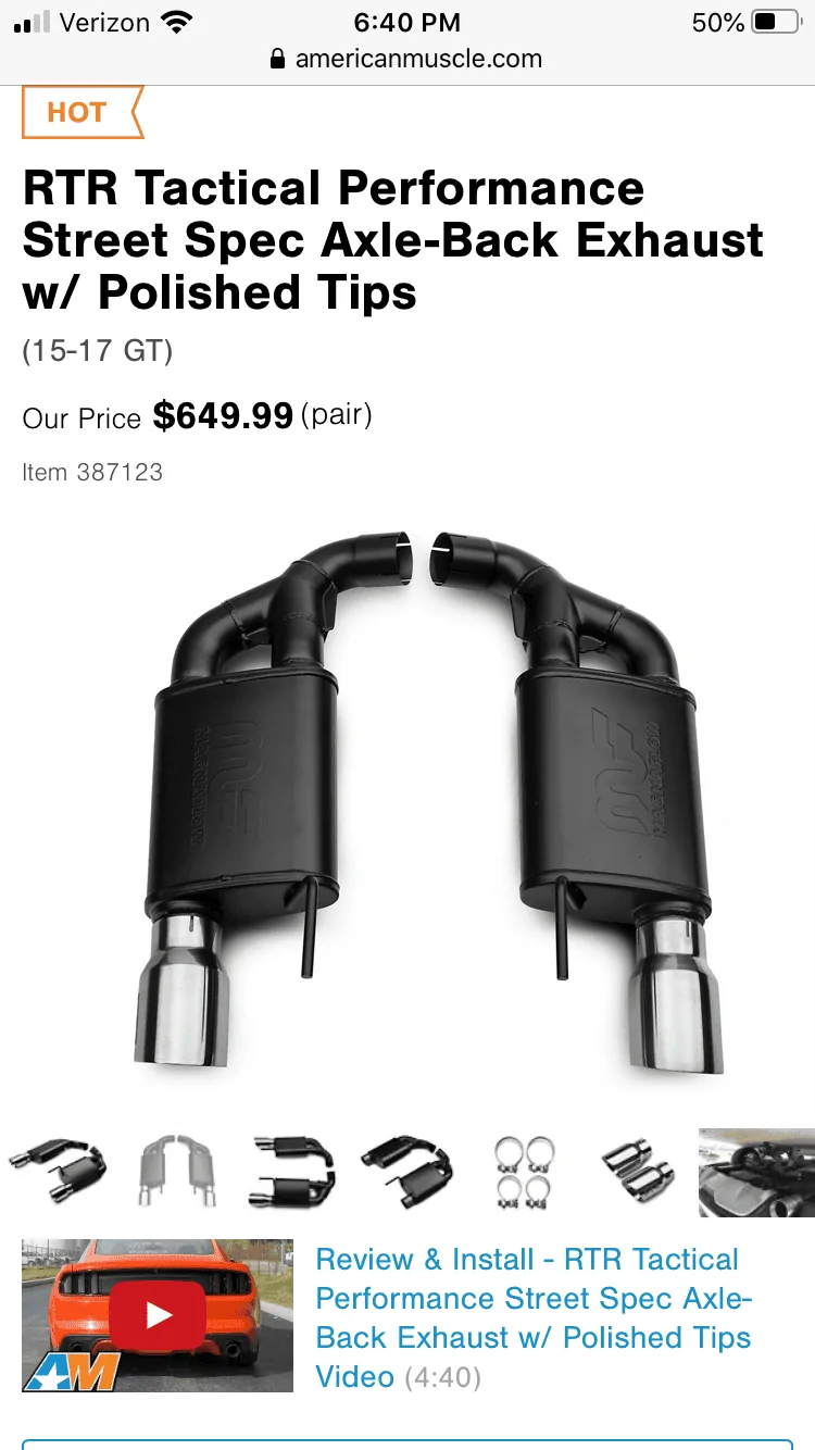

I have an extra RTR tactical axle back exhaust for sale cheap if you want...great condition...
The deepest tone on the market is the full 3 inch Gibson I believe, but it has some drone at 2000 rpm. Best muscle car sound I have ever heard, low deep sound, a LOT of volume...
