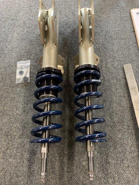

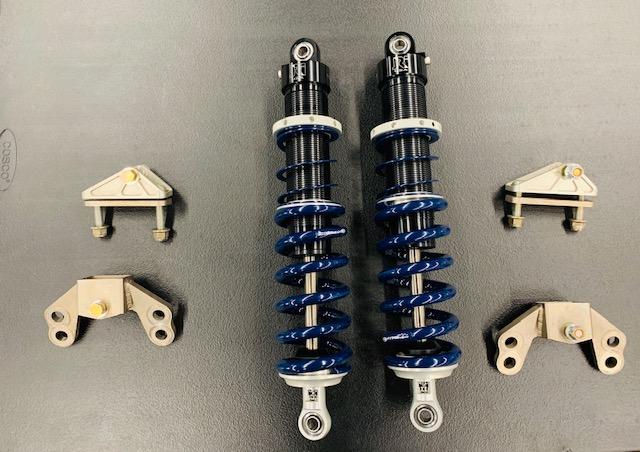

I have Cortex JRI double adjustable setup for sale. $2500. Over 5k new! Only on car for short time.
