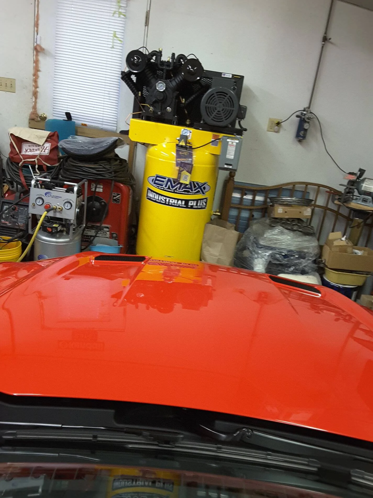

If you want a serious compressor i highly recommend the EMAX line of USA made units. You get what you pay for and they're fairly quiet. I sold my 60 gal Sanborn and that too was a very durable unit.

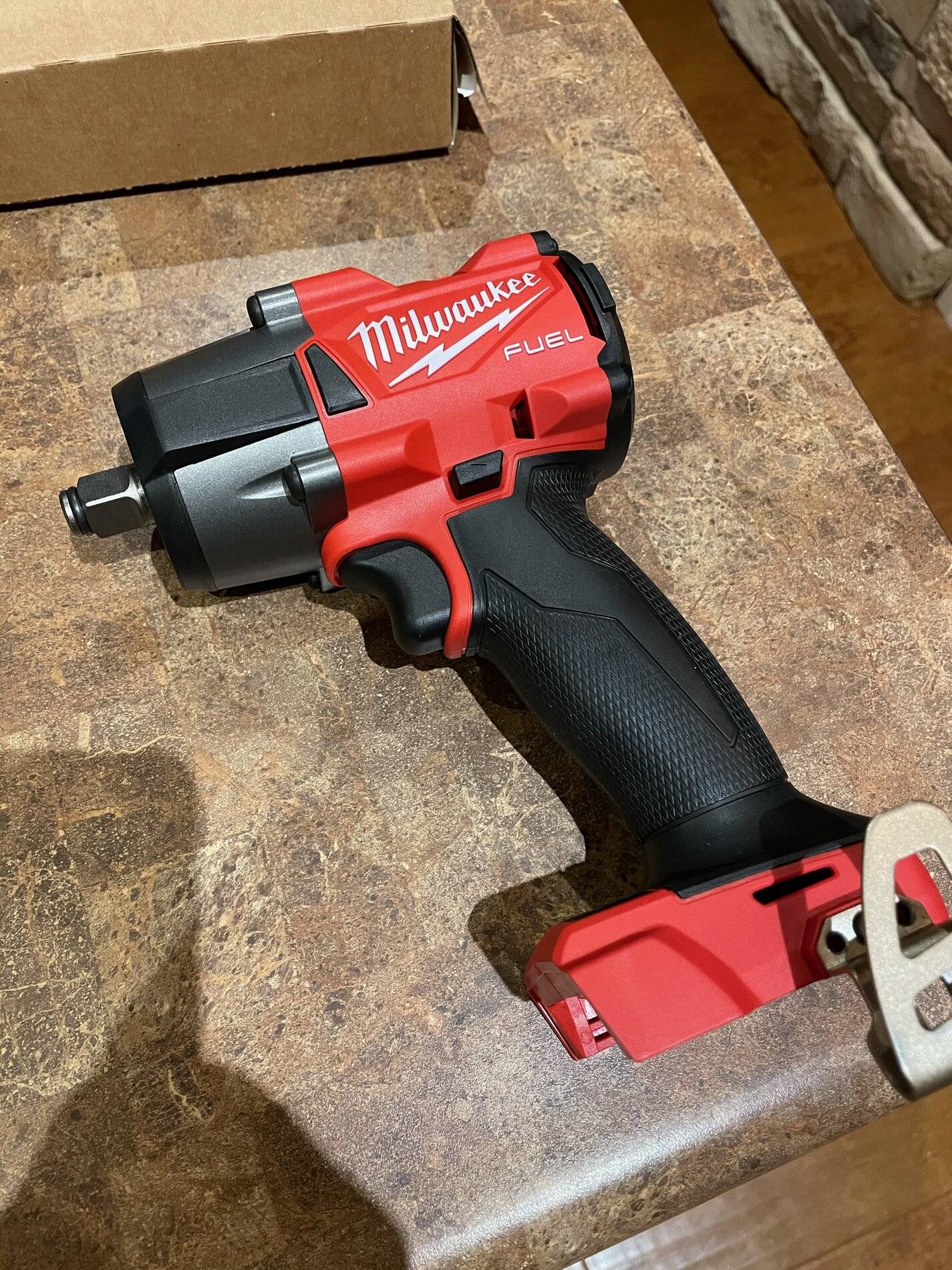

Milwaukee M12 and M18 tools hands down. Air is old school. My best friend turns wrenches for Mercedes for a living and has no air tools; all Milwaukee M12/18 stuff, including impact guns. If they're good enough for him to make a living with every day, that's all I need to know. He guided me towards this one; 1/2" drive, medium torque. Has four settings and it'll drive lug nuts right off on setting 2. Model 2962. It's impressive.
And as others have said, you'd never finish torque lug nuts anyways. You need a torque wrench regardless. Period. I don't even use this to drive lug nuts on. I have a 1/4 impact/driver that just runs them down, and then over to the torque wrench.

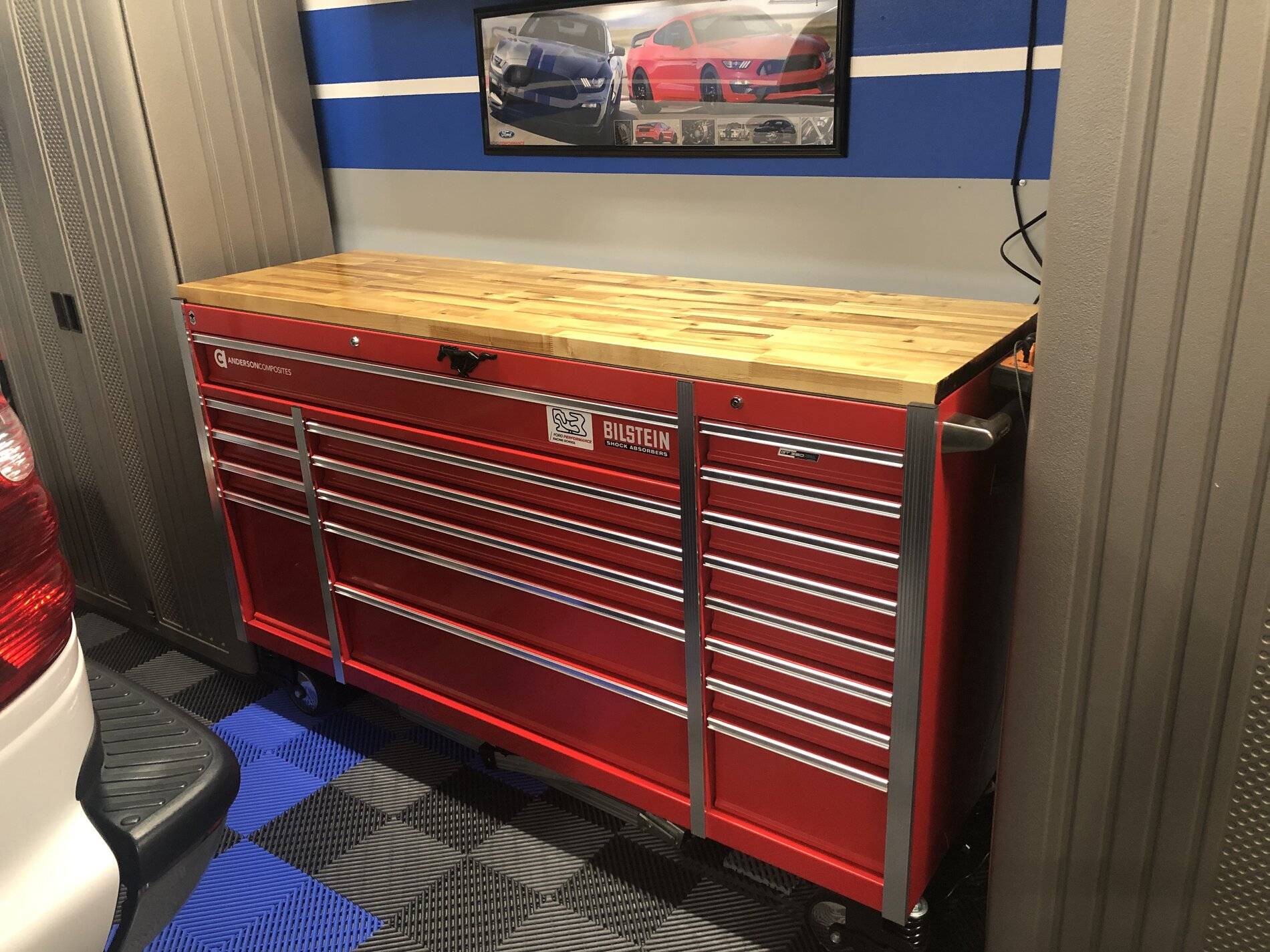

Also agree; the General line of boxes from Harbor Freight cannot be beat in the bang-for-the-buck category. This 73" chest is sub $1K on a sale.

How do you like that flooring? I’m in the process of building a new garage and have considered this type of floor, but I’ve heard a rolling floor jack or roller stool can dig in.
