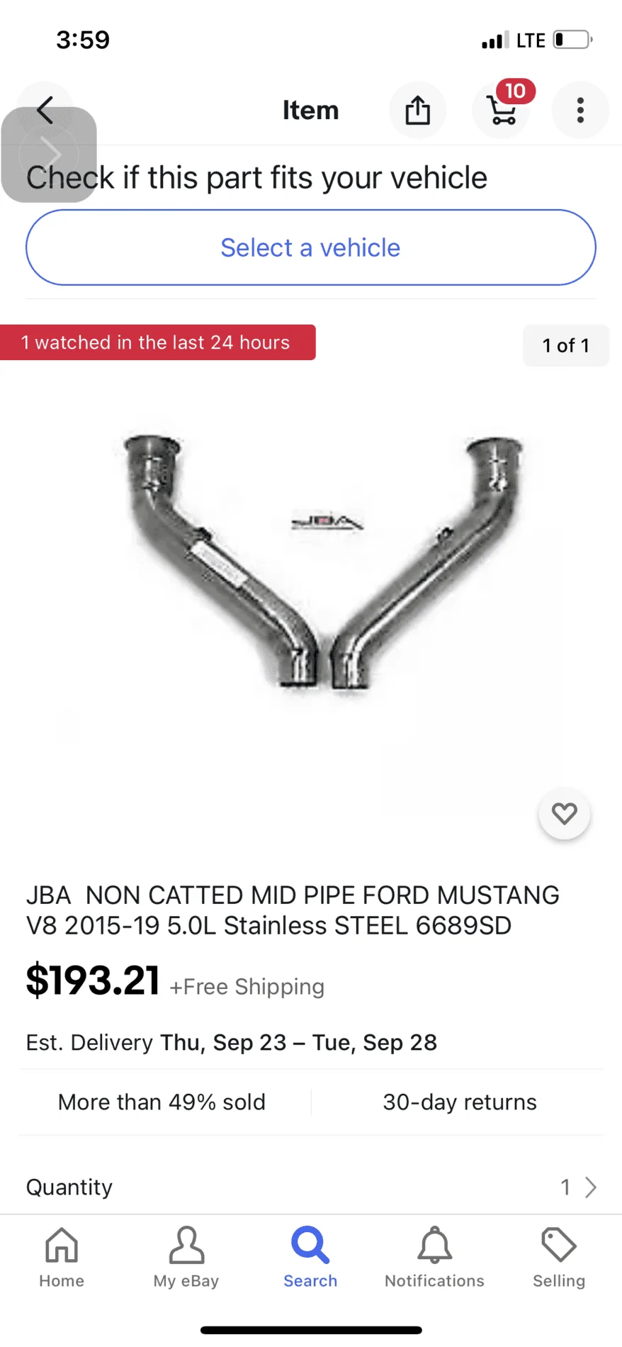

You can get some on eBay
OMG exactly what i was looking for. Thanks so much.

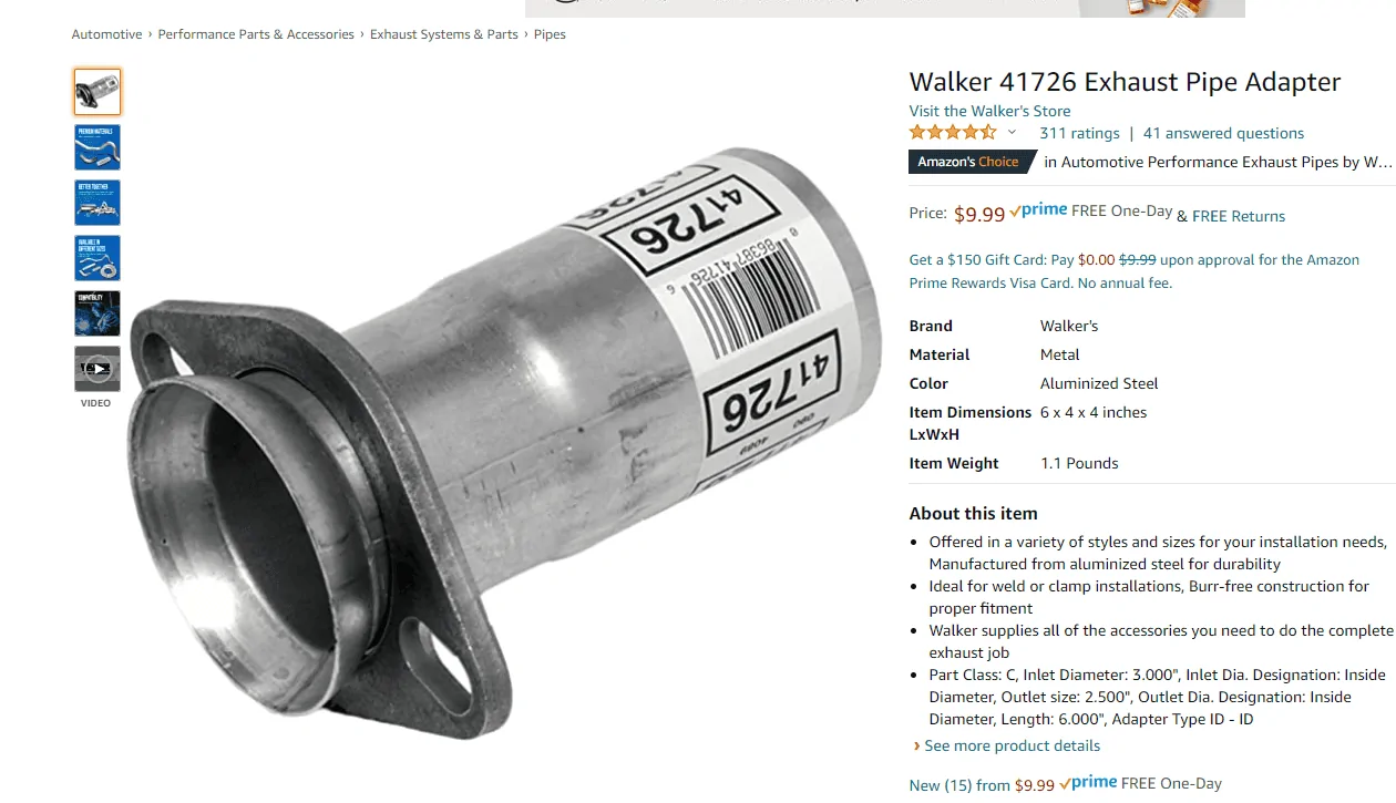

Nevermind, I checked the connection at the header and it won't fit with what i have. i need to get something like the one in picture and get it welded on. which means i wont be able to do it myself.
