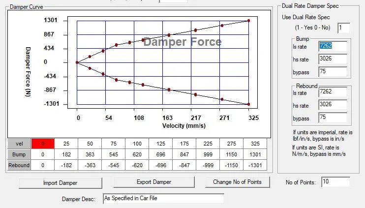

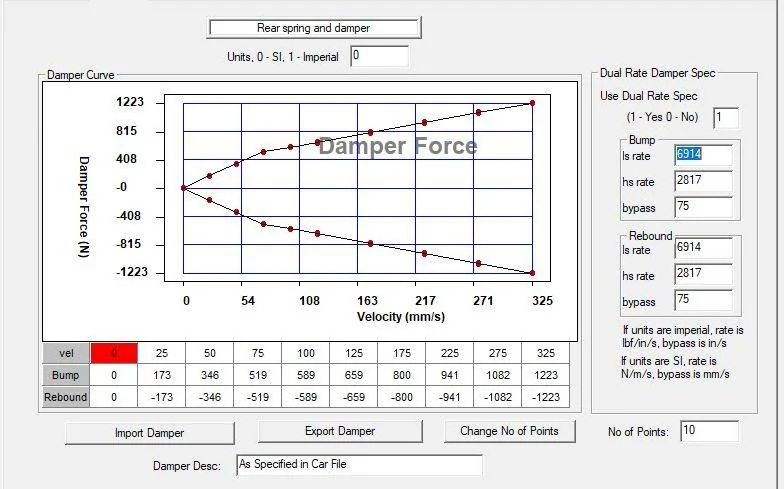

So with the springs chosen for the desired frequencies I need to obtain shocks that are able to dampen the bump/rebound with said springs. Using resources like milliken & milliken among the info posted above I plotted out a damper curve that I will result from custom valving performed on 2 way adjustable dampers.
These are my current plots, there is some small revision I will be making for a more flat blow off for a more digressive curve. I have not decided if I am happy with what I have right now.

I have calculated:
66lbs/in = critical damping for the front
72lbs/in = critical damping for the rear
I have settled on a low speed damping rate of 0.62 or 62% of critical for the front you can do the quick maths like so:
182/.025= 7280 (convert from si to imperial) 7280*.2214*.0254 = 41.49
41.49lbs/66lbs = .62
For the rear I have about 11% less damping so a low speed rate of 54% This is to accompany the higher spring rate and to control the weight transfer to the front under braking or other maneuvers. LESS damping = a faster damper = a tighter car (within reason of course)
I have chosen 3inches per second as my bypass or knee / transition point. The reasoning is a large majority of city driving and even tarmac racing for that matter the shock experiences 2-4 inches per second. A digressive damper is desirable so that you can have sufficient low speed damping but then an amount of blow off for pot holes, kerbs, or bumps. The blow off to less damping saves on the shock's lifespan while allowing for the chassis to not become out of shape over a moderate bump.
Like I said the jury is still out on the high speed section... I will update as I make up my mind where I want to start.

You will notice that I have a force matched damper curve. That means my bump and rebound are identical. It is perfectly fine to do this for a street car, and as I am learning takes some additional understanding to employ on a track car. The general rule is that cars with heavier sprung masses you want 2:1 or even 3:1 rebound to bump ratios. Rebound controls sprung mass, bump controls unsprung mass. This will result in a harsher ride when COMBINED with lowering your car from OE. This is because ANY bias in the R:B ratio will cause jacking. For rebound biased setups the end of the car will jack down onto the bump stops which act as an infinite spring rate. The opposite for bump biased setups, you will jack the end UP or cause it to launch over bumps. This of course happens over a series of bumps, OR a single large impulse.
With softer springs you can close the rebound to bump ratios as the bump setting is basically an inline spring with the rest of the system. Drivers also usually prefer the feeling of an over-dampened roll mode and so to combat that I will possibly be adding a larger front sway bar to balance that out. I have heard from a couple engineers that the 350 has terminal understeer and there is not a lot that can be done about that. It is an inherent "feature" of the chassis.
After having driven a car with force matched dampers I am inclined to believe that a slight rebound bias would be best for how I like the car to feel. I am not even sure what it would translate to around a track. I will find out in December when I get out to COTA. I will data log the OEM setup, repeat this a few times and then switch to my custom setup and data log some more.

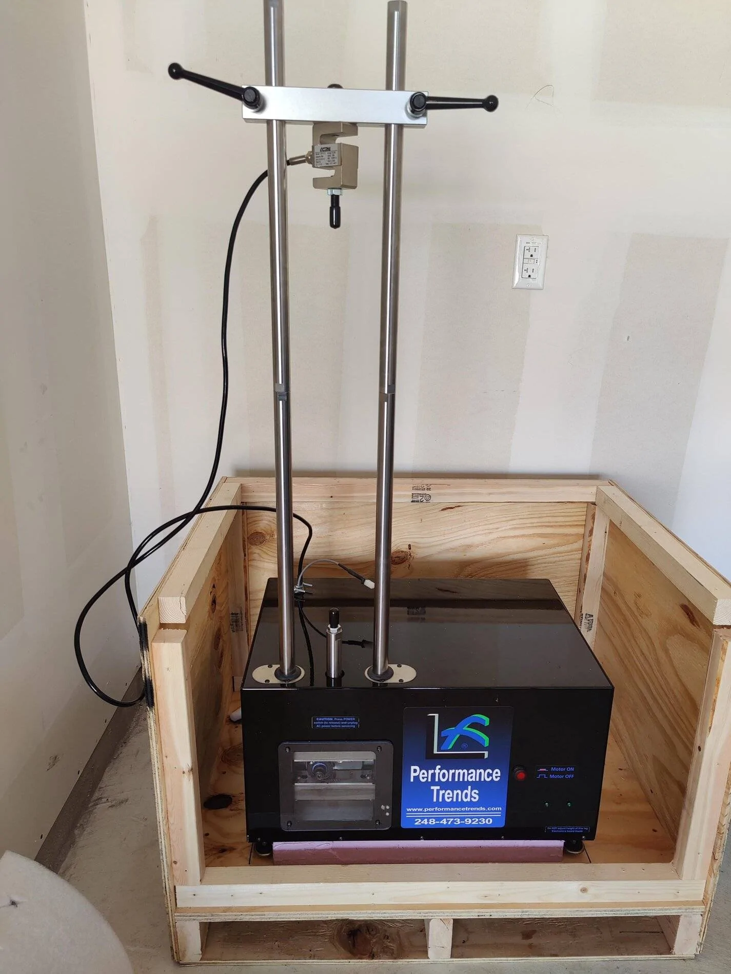

I wanted to give an update to this post. I have the shock dyno and I have been tinkering with how I want to achieve my goal. Some of my initial numbers were off by a small amount and I needed to revise how I was calculating the changes to the damper curve. My main hangup right now is getting a strut body that I can easily place a take apart shock insert into. Pictures, updates, progress, videos, etc to come.

how much for the dyno? What is the size (dia) of the piston you're using?
what software is the screen-grabs from?

Dyno info:
https://www.performancetrends.com/Shock-Dyno.htm
  • 2.0 HP, 110 VAC motor
  • Stroke is adjustable for 1 and 2 inch strokes.
  • Up to 14 inch/second shock velocity.
  • 2000 lb load cell.
  • With standard 36 inch masts and 2 inch stroke and the load cell adjusted to maximum height, the eye to eye distance of the shock will cycle between 23 inches to 25 inches.
