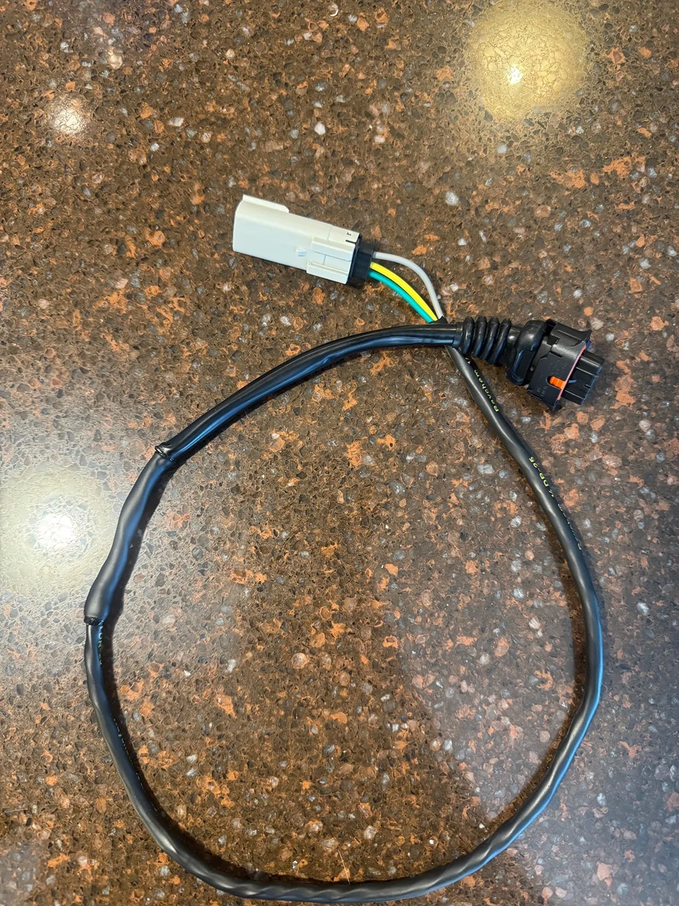

I ordered this Bosch TMAP sensor and cable from Amazon for the experiment.
https://www.amazon.com/dp/B00BL75RX6?ref=ppx_yo2ov_dt_b_fed_asin_title
https://www.amazon.com/dp/B07TNJB9SJ?ref=ppx_yo2ov_dt_b_fed_asin_title

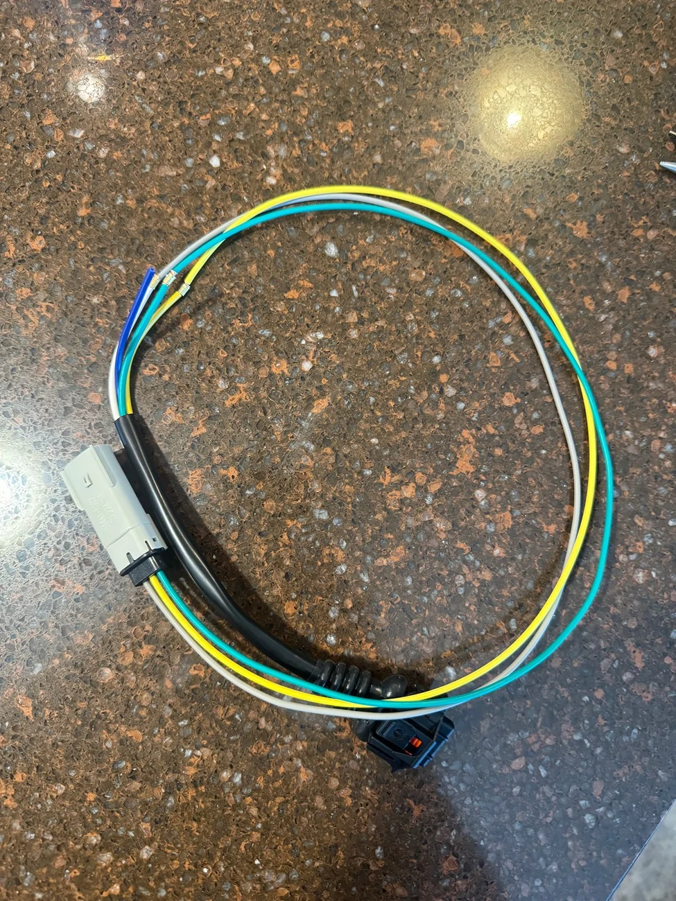

Now the trick is to get the connector that plugs into the IMRC connector on the engine harness. In the case of the GEN 2, I could not find just the connector so I bought this complete cable set.
https://www.ebay.com/itm/384947067105
This is a VERY low quality kit.
I should have bought the VMP harness. I had to cut the keying feature off of the cheep kit as they were wrong. But I wasn't sure this was going to work and I didn't want to cut up an expensive harness just for the experiment. If I did it again I would buy the VMP harness.

Here was the result.

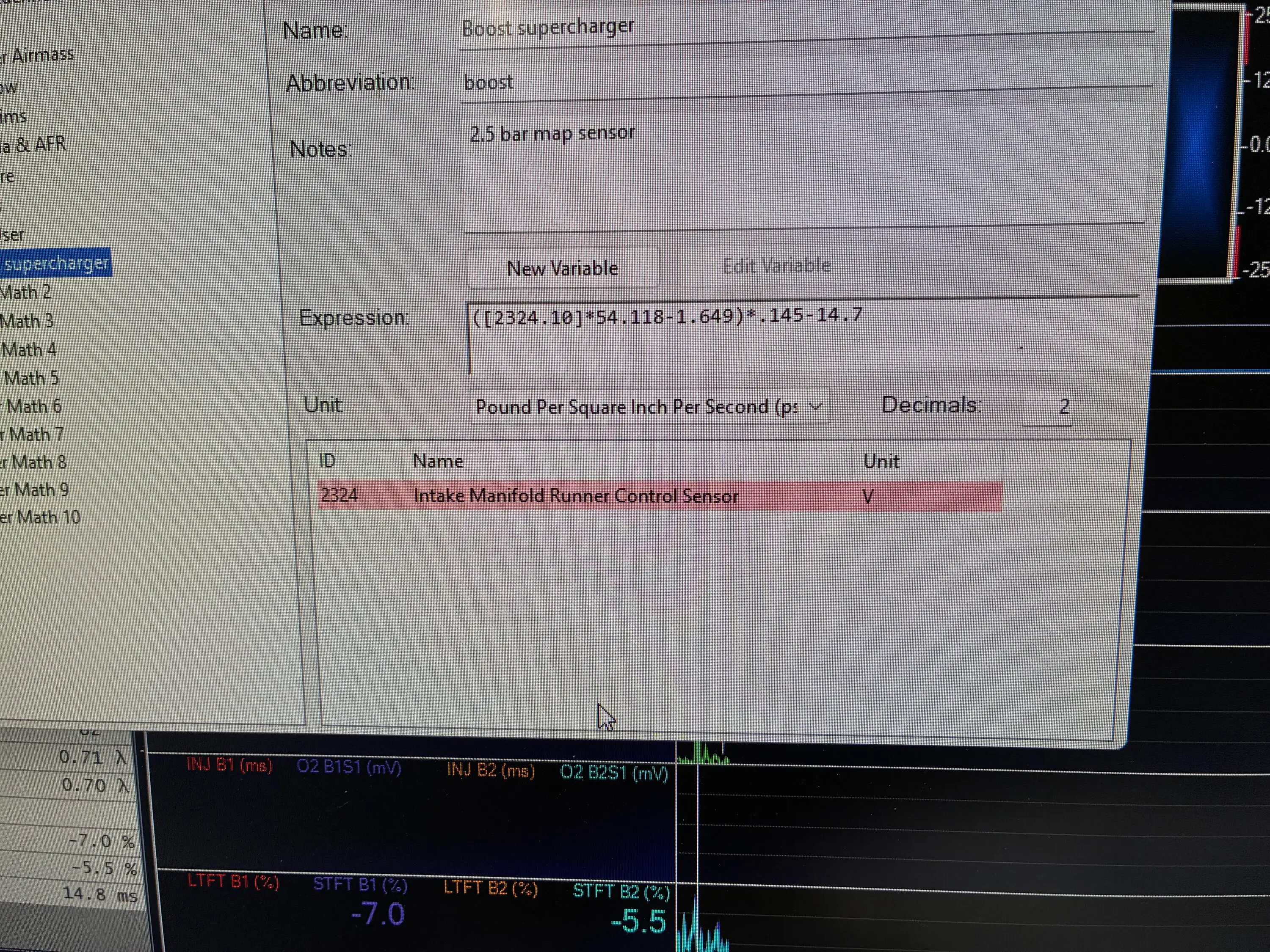

I then went into HP tuners and setup the channel.
I have not driven the car much for other reason, but on my short test run it seemed to work great.

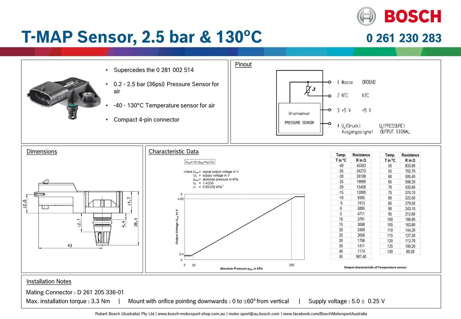

Going to purchase this exact mapt. Info about connectors and mapt voltage below.
Just for reference for those wanting to make their own harnesses/connectors. The bosch sensor OP references is PN#0261230283. This uses the Bosch Kompakt (Compact) 4-Way Connector. I believe it is code-1 (The code is the slot/grove pattern that is used to allow/prevent the same connector from connecting to different codes). Chief enterprises is a bosch sensor/connector dealer I have used before and they could probably get you more info on the connector.
As I already mentioned IMRC is a 3-pin Molex MX150. It is keying option B. Molex website has lots of info on the connector and you can find all the part #s for pins etc.
If you are diy-ing this I highly recommend getting pre-assembled connectors as every connector pin uses a different crimp tool and the proper tools are expensive. Also when assembling use crimps (brass u ones) and don't soldier.
Attached is the official Bosch info for voltage to pressure and temperature conversion so you can get the values.

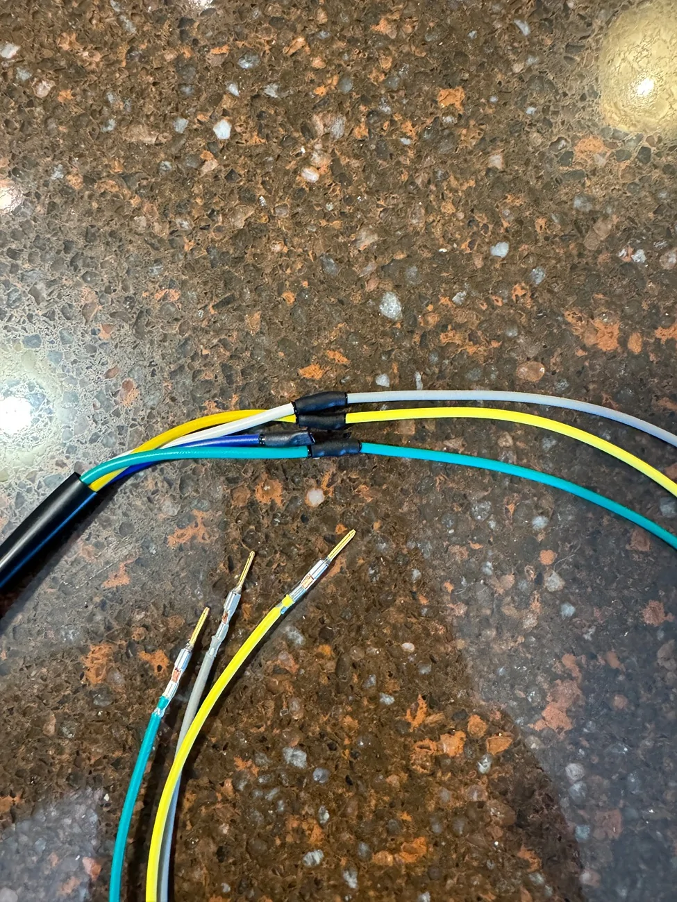

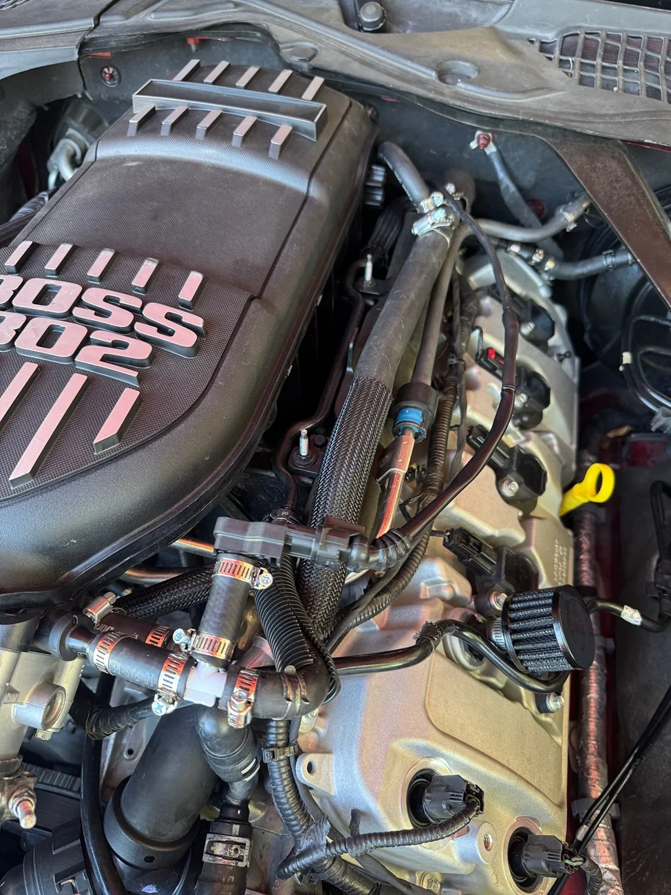

Got it wired and working. Not my best wiring work but I didn’t have a wire shrink sleeve that was big enough so I had to improvise.
Pro tip, download a barometric pressure reading app on your phone. All (newer) iPhones have barometric pressure sensors. I was wondering why the map sensor was off from what the weather app said my local barometric pressure was, downloaded an app to pull the phones reading and it was spot on with my new map sensor.
Photos of the wiring and sensor install.
