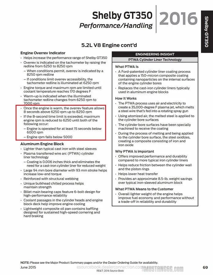

I'm not sure what publication this page comes from, it's an "RE&T 2016 Source Book" dated June 2015. Does anyone know if the 8-second Overrev cut-off was involved in any of the reported track limp mode events?
Anyone run at over 6250 rpm for more than 8 seconds on track? Anyone experience any Overrev warnings on the dash?

Cool. Thanks.
