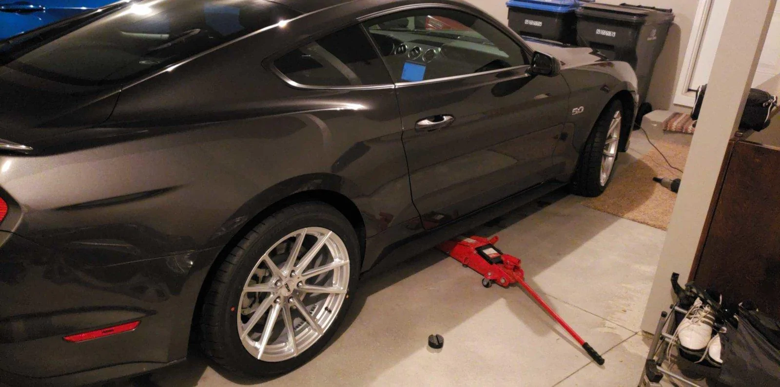

TSW Bathursts are super light. My 19x9.5's weighed in at 19.8 lbs each on my scale when they came in. I haven't driven on them yet because of the snow here, but I do have an on-car pic from when I test fit them. If you go 19x9.5s squared, you'll have to run a small spacer up front

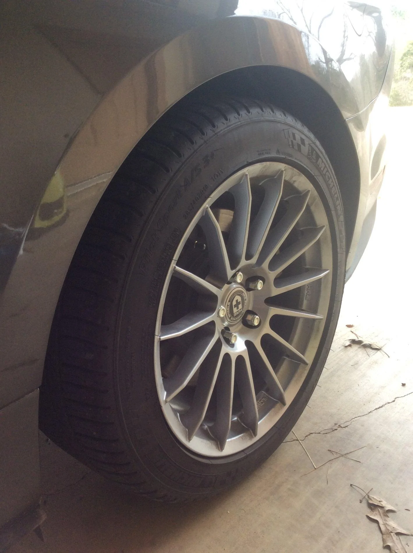

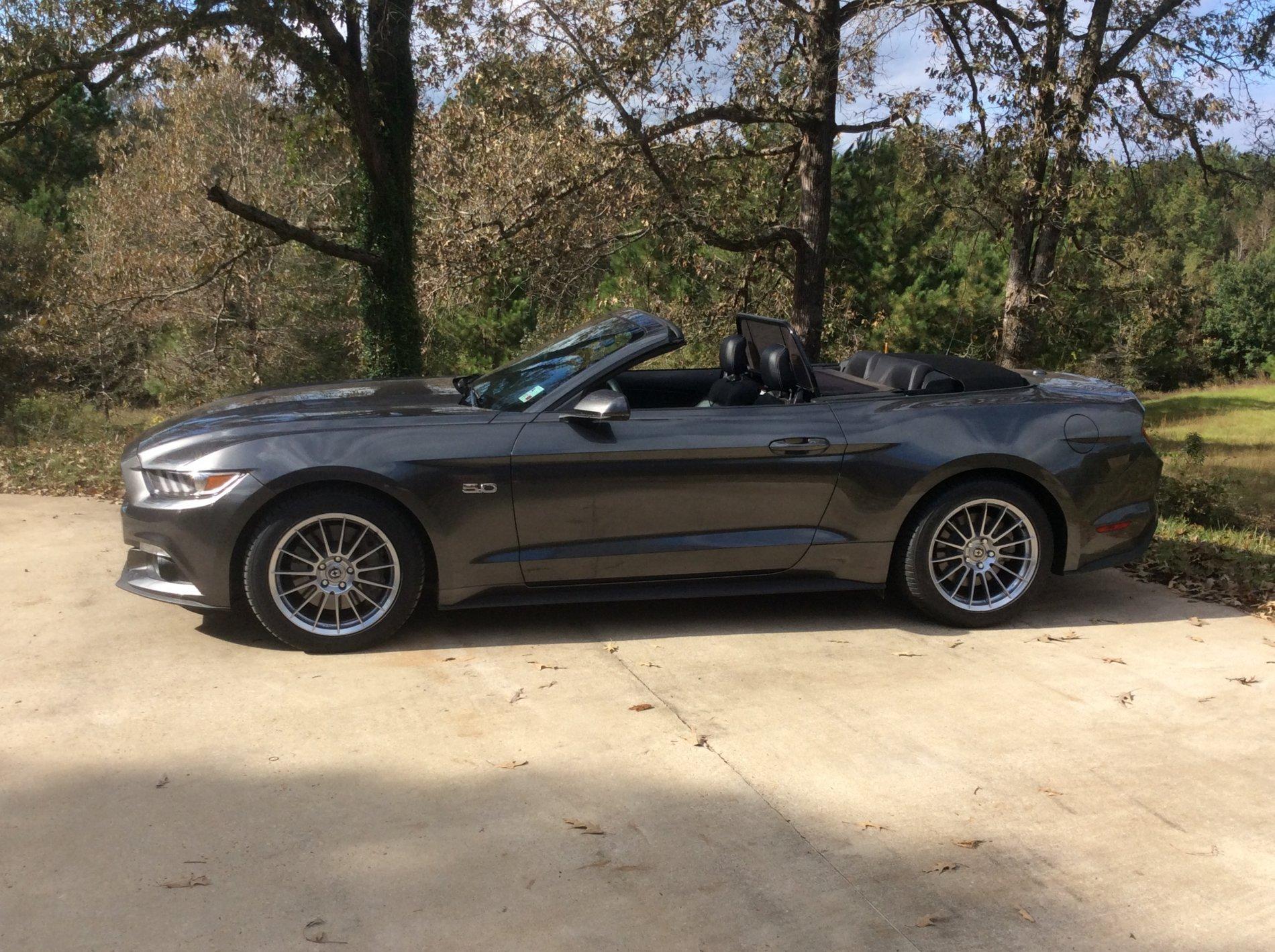

I went with HRE’s in 18 x 9 front 18 x 10 rear.. I think I read they’re in the low 20’s in weight. I’ve been very pleased with them.
