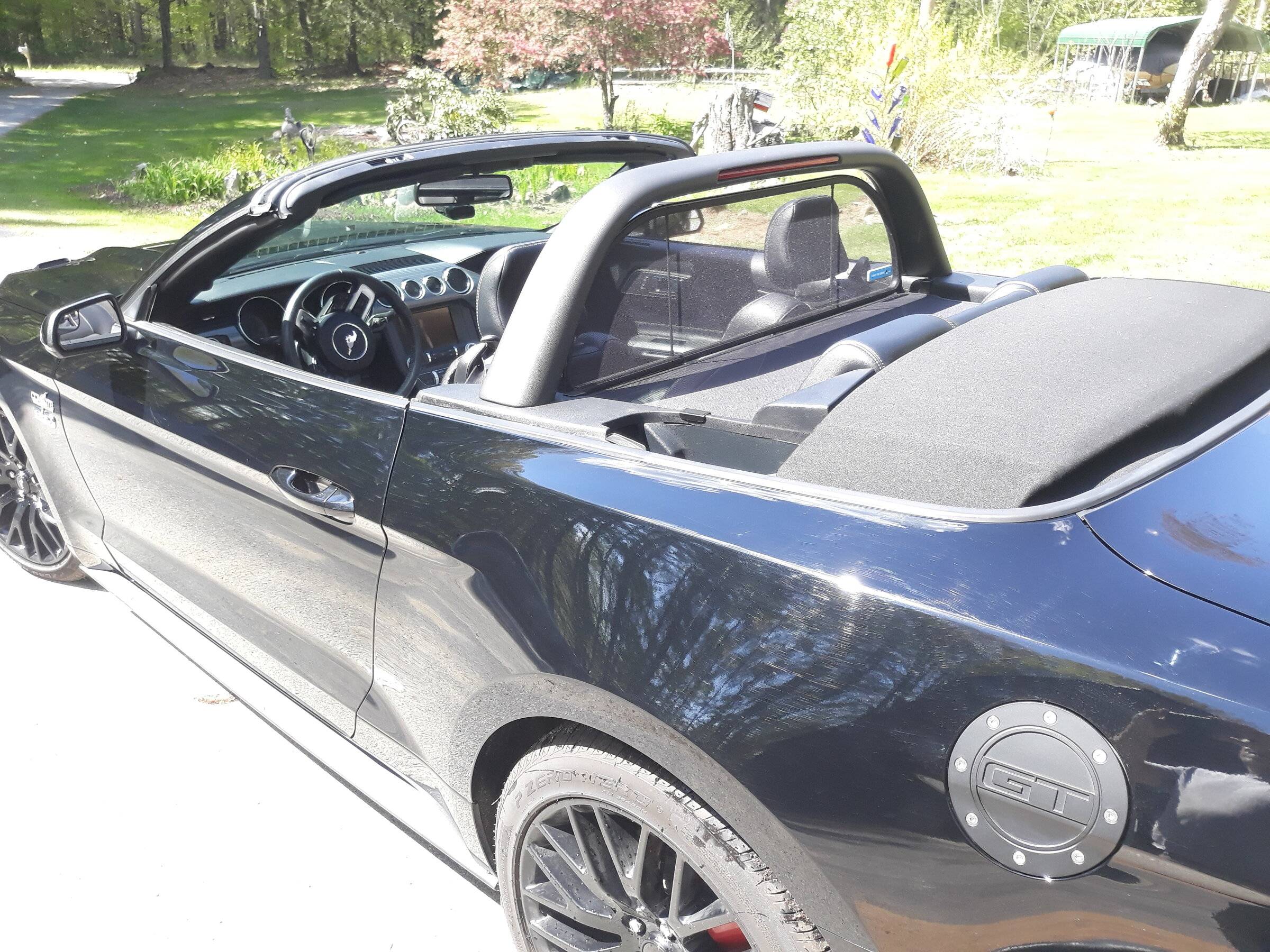

Well decided to go a different route instead of the light bar. I love how it turned out.
I’m assuming that when you put the top up, it lifts up until the top clears and then drops back in when the top is halfway? All electric I’d imagine.
I bet wind buffeting is better, like the windscreens maybe better even as is this solid.
I wish it was electric. :frown: It is just attached via wingbolts to the car but the two outer pieces are able to be removed and can be stored in the trunk, the middle sections can stay and the top will go up over them. The wind is better for sure!!

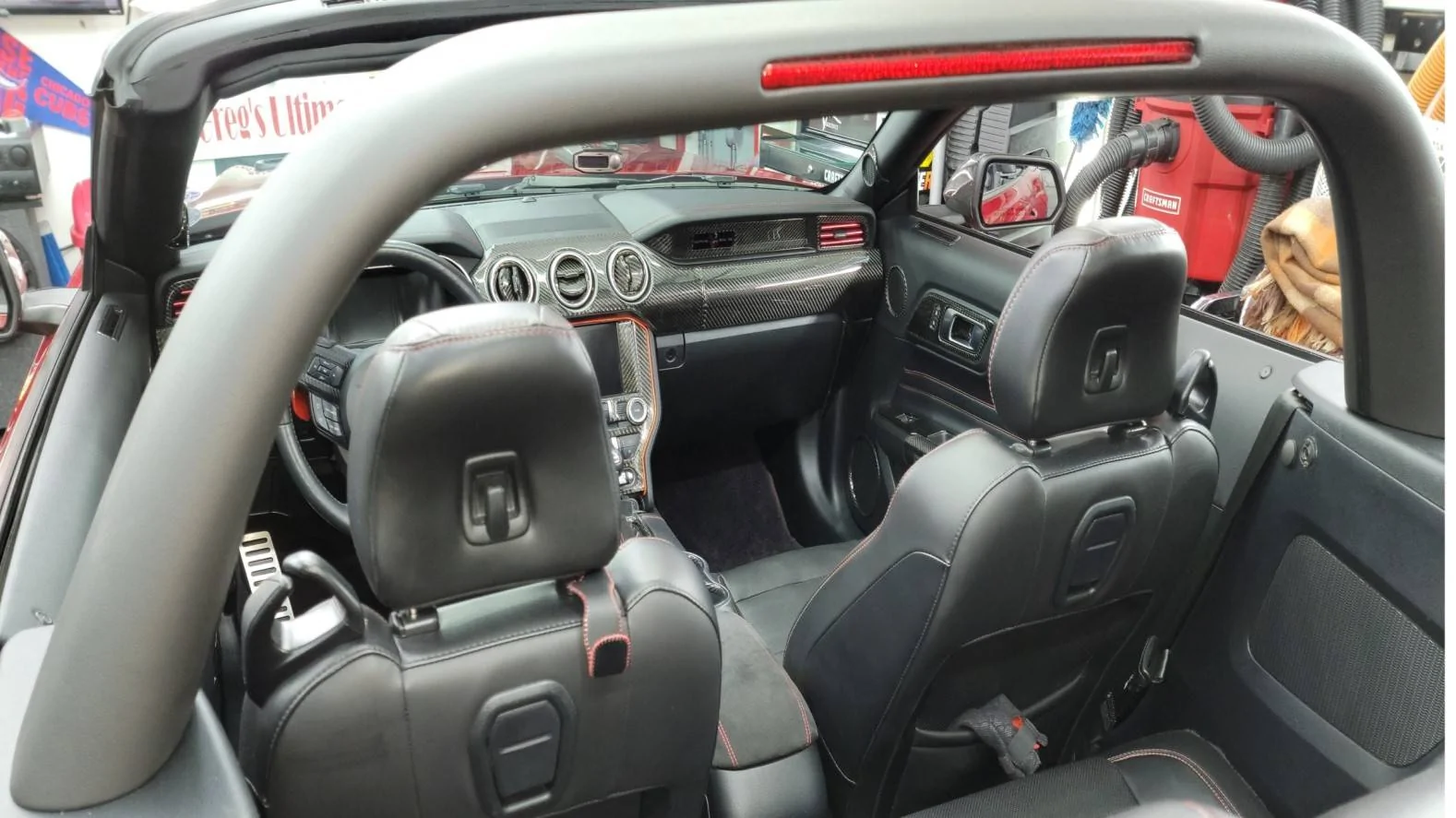

Finally took a photo of mine....now all I need it the wind deflector. Anyone got a good source for the wind deflector???
