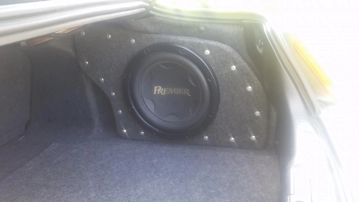

I wanted the jl stealth box but went the cheap route and made my own with fiberglass and a removable front panel.
Mine is tapped into the rear speakers and rolls off horribly at high volume have to get a loc with bass restoration I guess.
How much you want for a box with shipping? :D
