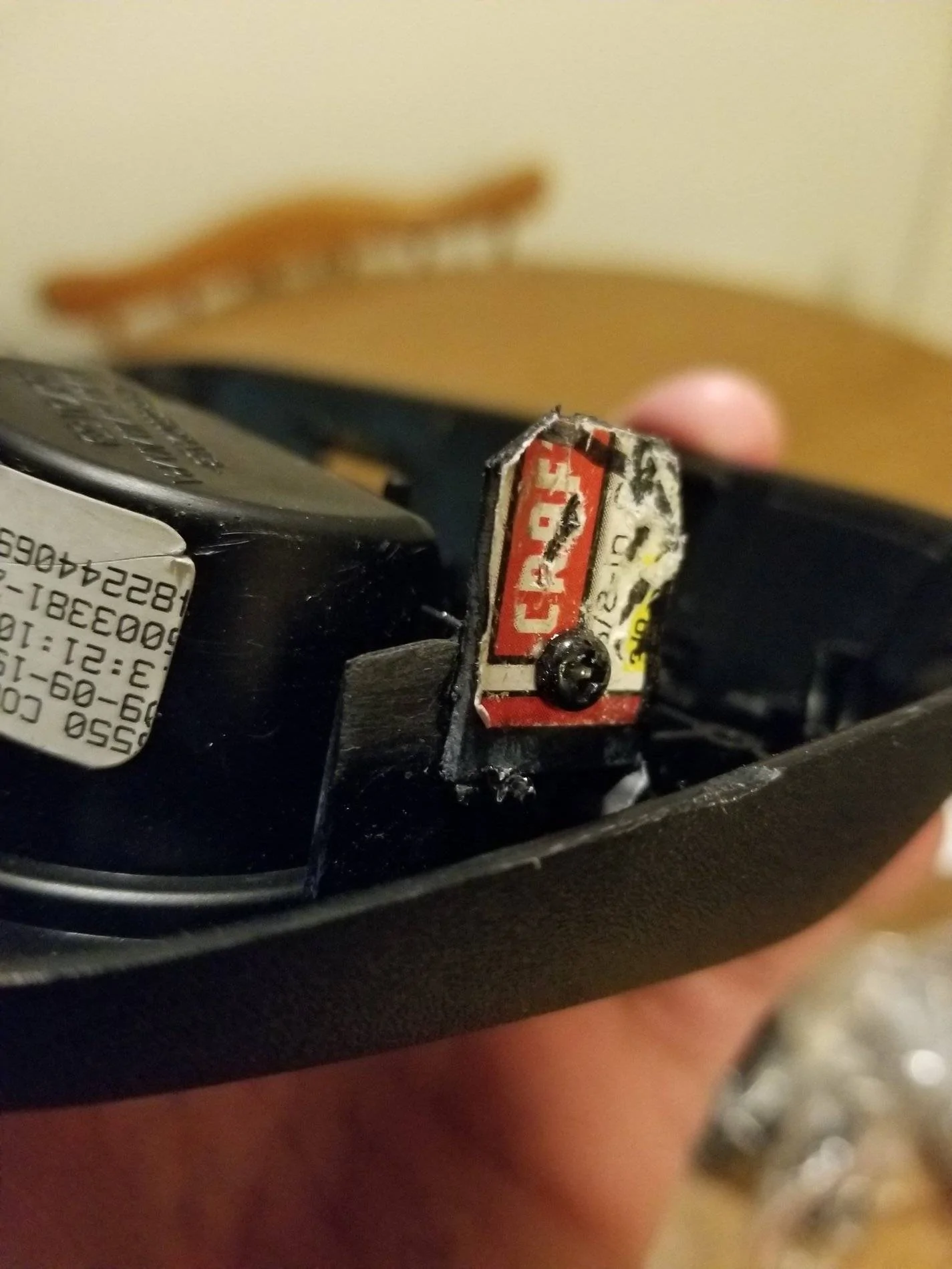

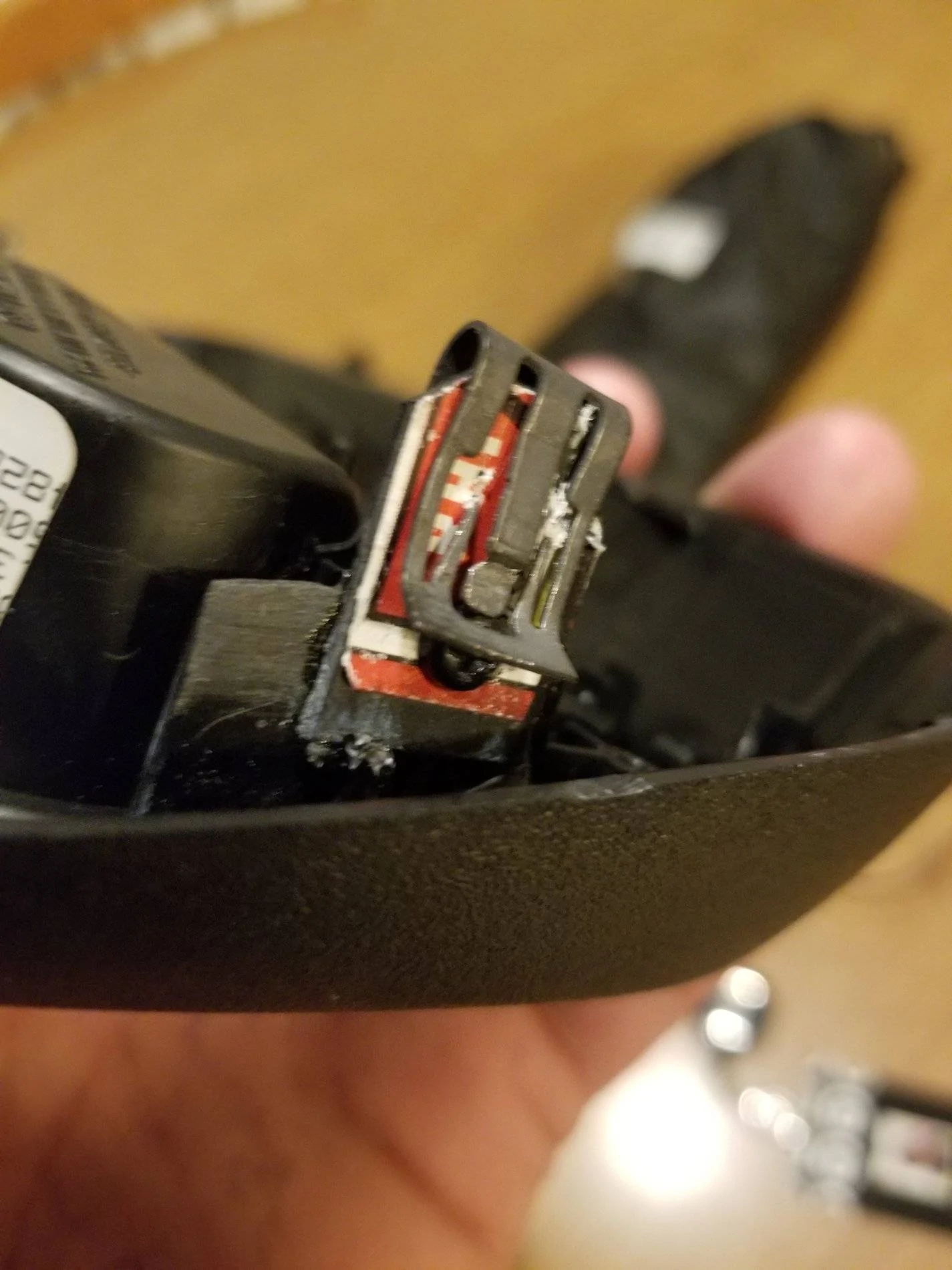

I had it happen to me too today. Used some gorilla glue and let it cure. The key is to make sure the little ears are extended out to the sides properly. It seated with a nice click and so far so good.

I was going to quit on mine but I’d yanked on it so hard at first I had a damn gap and it wouldn’t go back flush. So I kept going. I superglued it and I’m gonna order the whole new part.

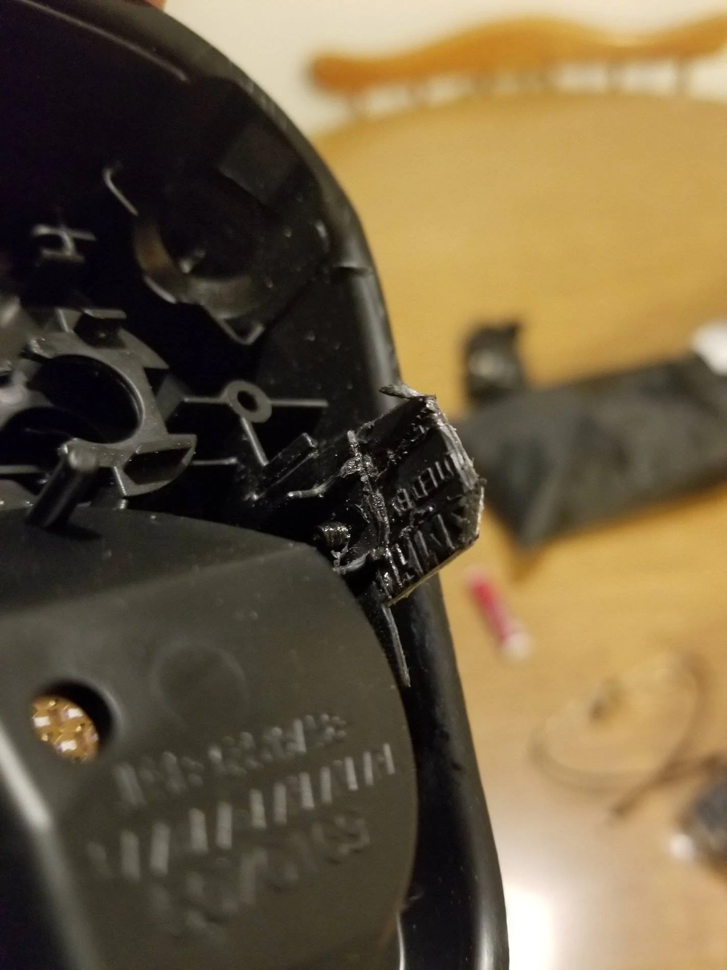

Just got my 19 GT today and went to replace the dome lights to LEDs and guess what, the plastic piece broke and the dome housing won’t stay up anymore. Does anybody know the part number or where to get a replacement housing?

Like others have said I seriously believe that there is something different with the overhead console in these '18 models. The '17 models came out without issue and it took all of my strength (and some broken tabs in the process) to pull down the console in the '18.
After all the ways I tried to get the metal clip to grip into the plastic again there was still a small gap and a new rattle. My solution was actually to buy a slightly used overhead console from eBay, remove all of the lights and electronics, and swap in all of the things from my car. All I really needed was the plastic housing with tabs as opposed to all the extra stuff ford includes. I actually purchased a few of these that would work and will be posting them in the for sale section soon.

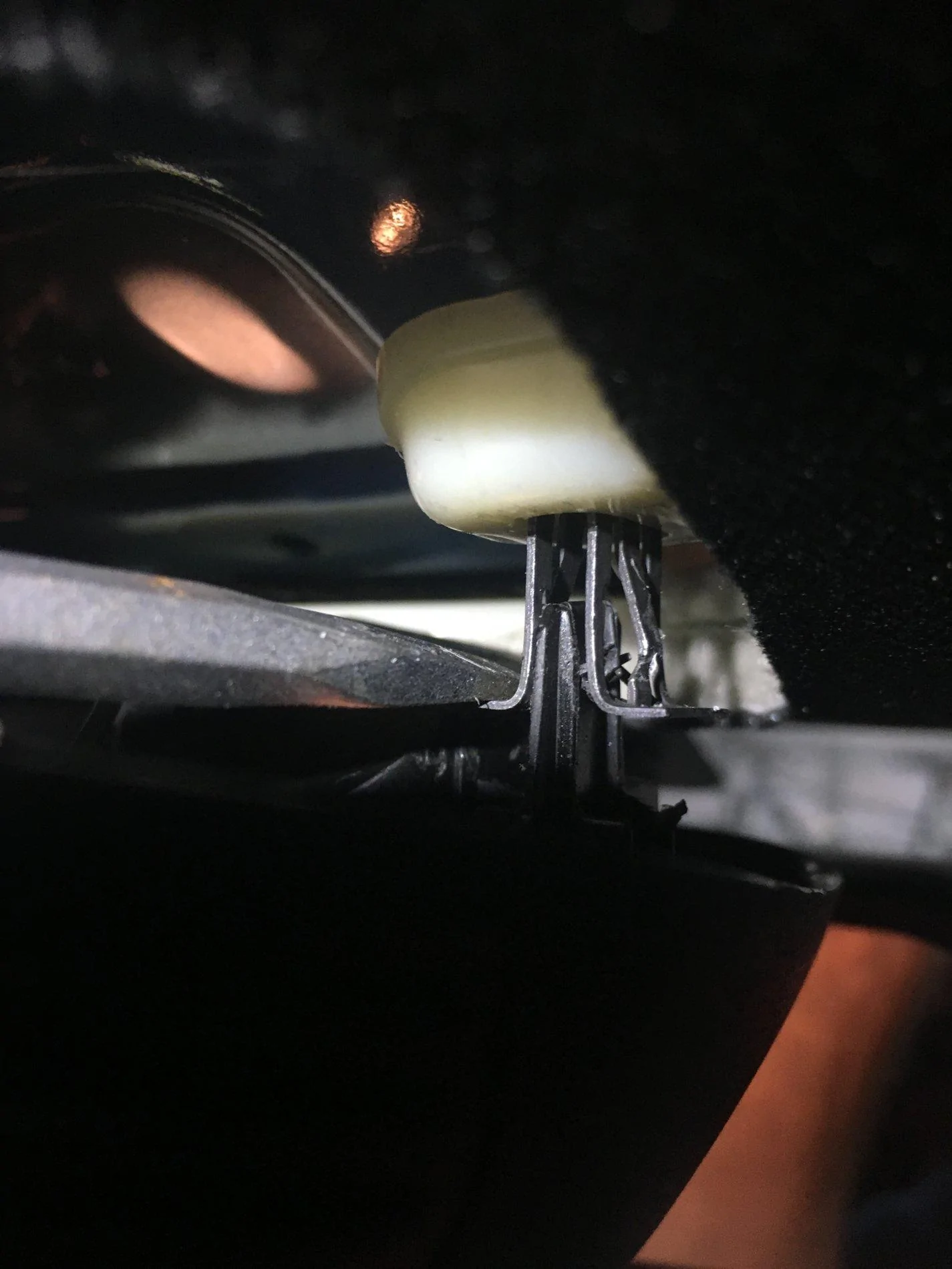

... Driver side the bulb housing pushed into the console housing. Spent 30 mins pulling the overhead console off.. Scared to death it would break . After much pulling it came loose.. Clips slightly damaged. Anyway pushed the connector back thru the gap and fitted the led...

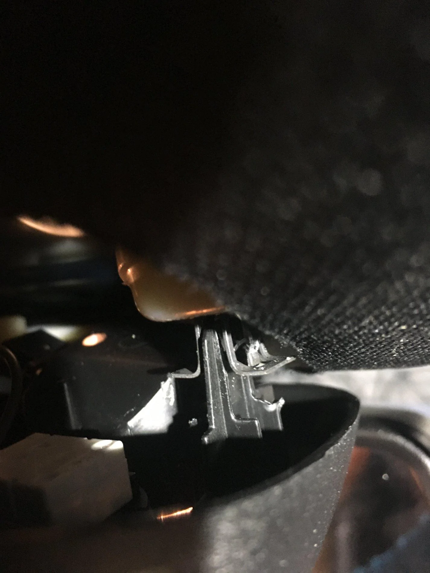

This happened to me when changing out my LEDs. More trouble than I recall when the kit was installed in my 2016 car. After the bulb holder backed out of its mount, I tried to pull the housing down, but was afraid to have to break something just to learn the trick. So the first thing I did was search the forum and found this thread.
I put a headlight on my head and angled the light to the gap above the housing. I even had to raise the seat to get my head up to the roof and peek in there. I saw the two clips and instantly recognized the Jaws of Death metal clips. I remember how these don't release properly from when I was working on my dash.
I inserted a regular #2 screwdriver and pried the metal tabs away from the plastic slot, working both tabs of each clip evenly, and on both clips, until the housing came loose with no issues.
Then I pushed the driver's side bulb holder back in place, followed by the DD LED, and then pushed the assembly back in place.
And all this from using the pry-the-lens-out method from the outset!
Here is a photo of my technique for the clips.

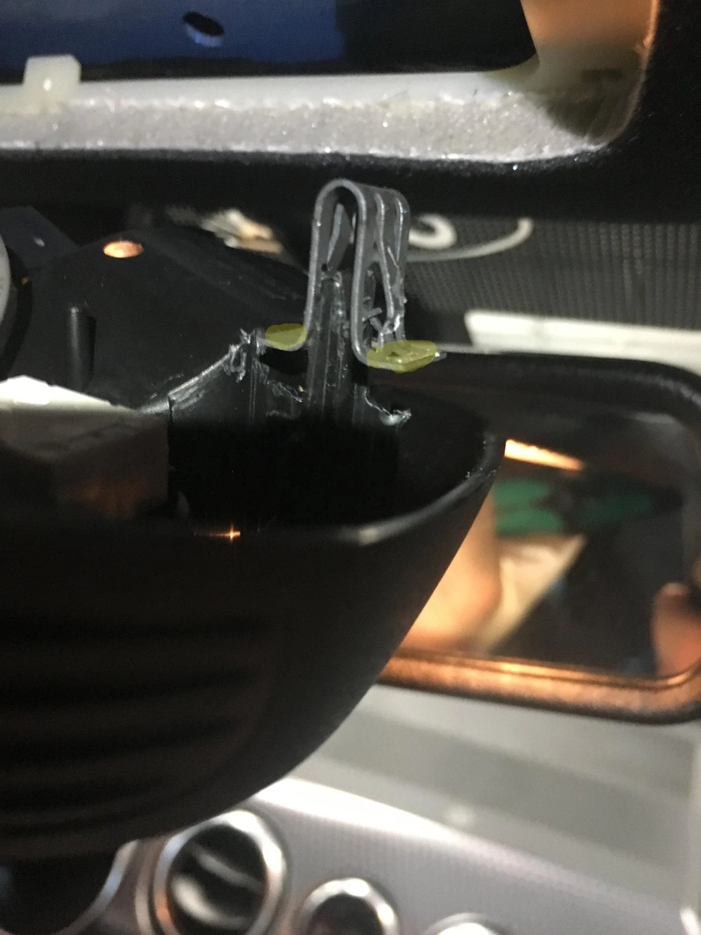

I've got a second chance at this as I now have a 2019 Mustang (RIP to the 18). Anyhow, I figured I'd go with the method above, and it worked great!
It will pop out, and everything will be intact, there may be some slight marring off the plastic prongs from your initial pulling, but no actual damage. Rejoice! Now you can swap your map lights and then push both metal clips back down onto the plastic prongs as far as they can go. Pop it back in and you're golden.

what about actually changing the bulb? I broke my dome also, and got frustrated so I decided to just give up and I’m going to try to get it back up into place tomorrow. Thanks for the post. I’m going to try to pull the clips and open them back up a little so it sits back snug.
