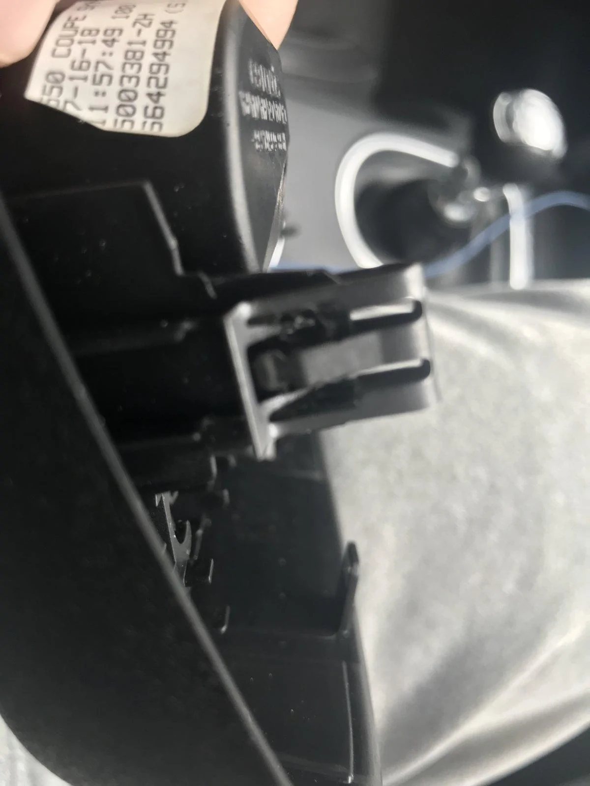

For whoever does this mod in the future the way I did mine on my 14 was pulling the whole thing down then after that my leds didn’t fit I can’t quite remember why. Point being I just pryed the lenses off which was much easier.
The lense has three tabs I believe you can see them from the outside but take a long knife with a thin blade and slowly pry it out being careful. The lense is pretty sturdy so you shouldn’t have any issues but still be careful it does scratch sort of easy and you will put a small nick in the black housing plastic for sure not something huge but if you’re ocd then heads up you might wanna do the side towards the windshield if it’ll bother you.
This method is usually better for me since I don’t break any tabs on the housing and if anything I’ll go to a junkyard and pull a lense rather than a whole housing. Not to mention the led usually fits better going in this way because the thin part is all you have to get through. If you have a fatter led it won’t fit through the hole it has to if you take off the housing.
If by chance the leds don’t work it’s pretty easy to blow a fuse. I did on my 2014 and all the interior lights after weird so be careful of that.
