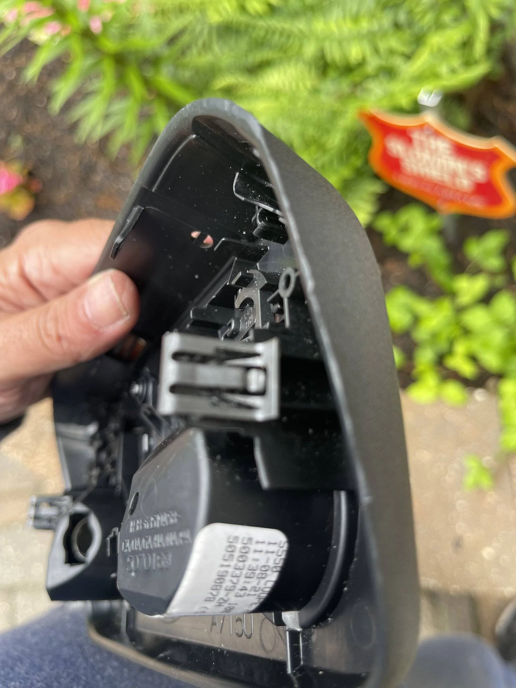

You have to pull the housing down enough to get in there with a pick or small tool to depress the tabs on the clip. You can try pulling down as hard as you can and it may come loose, but you risk ripping off the clip towers or breaking the tabs on your headliner. Those clips are definitely a PIA.

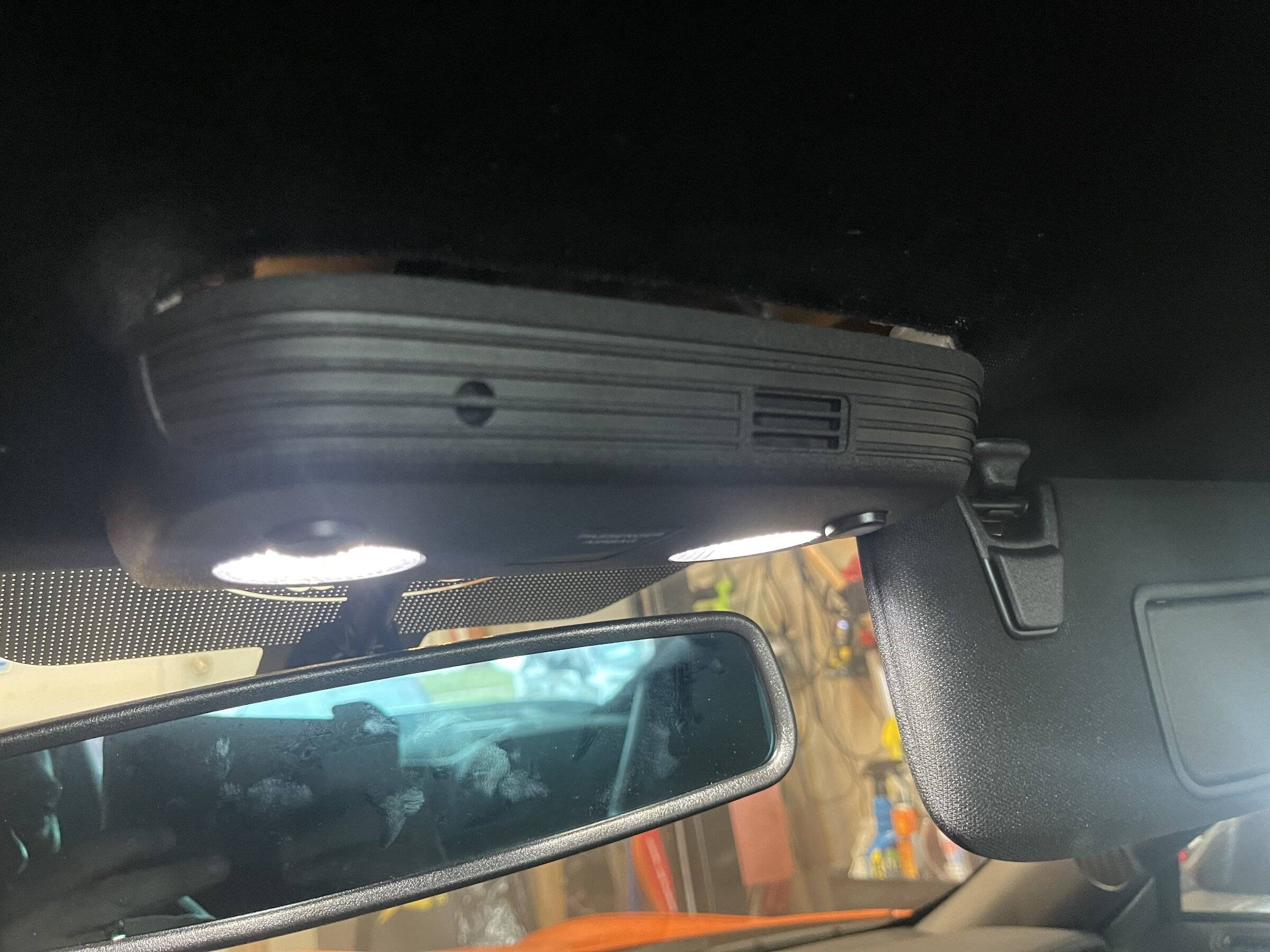

yup i did when i posted this. i was able to get the passengers side clip undone, not hte drivers, but it was enough to pop the bulbs out and pop my new ones in no problem!!! then when i put it back up, it was totally loose and wasn’t as tight as factory was and i was mad…but no joke after a day, it somehow settled, and now it’s as tight as it was from factory!

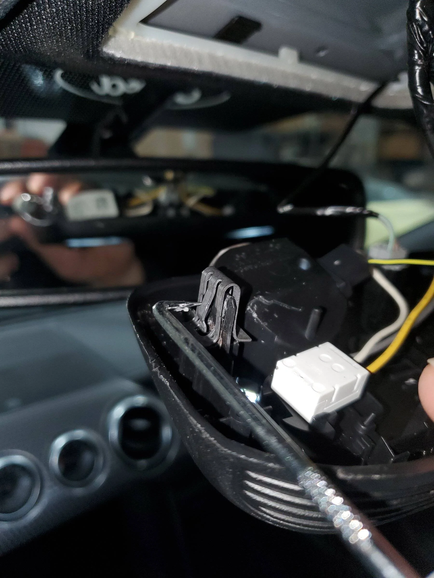

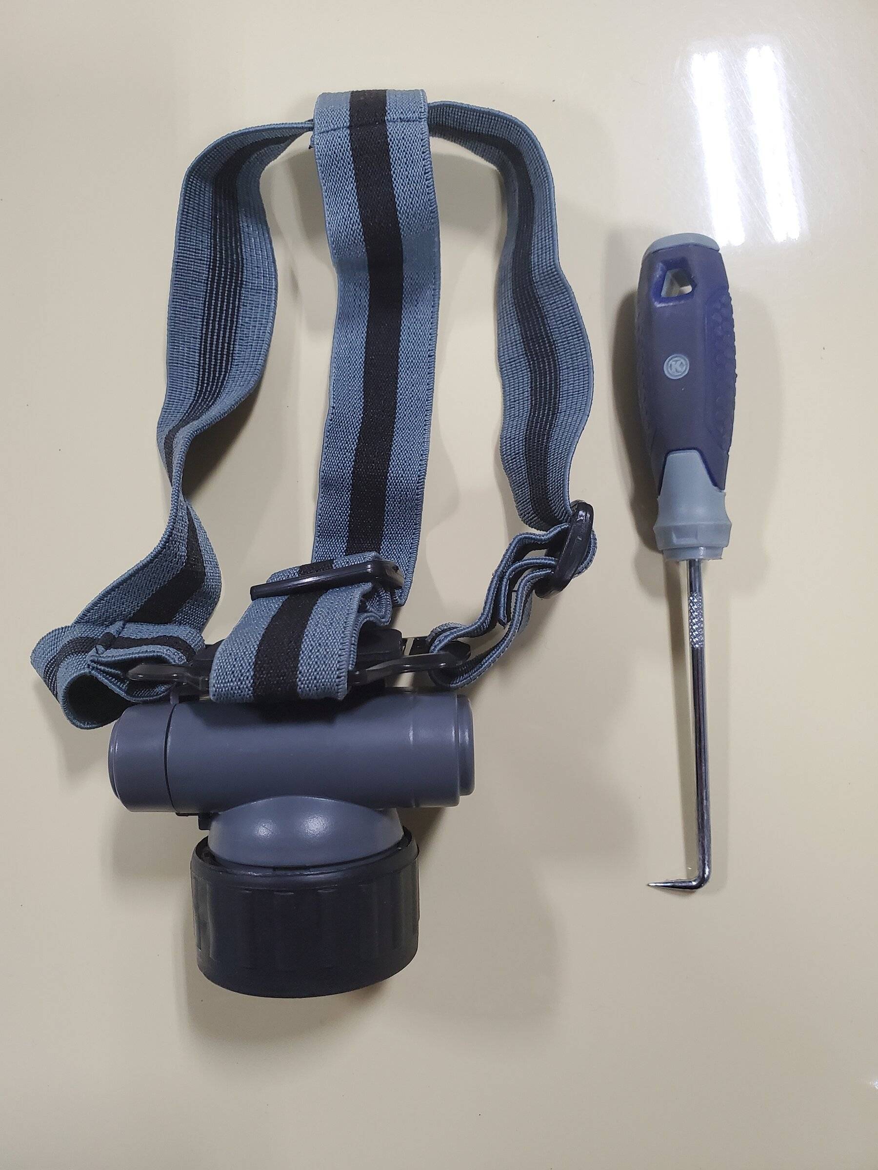

Use a head mounted light and a small pick. Depress the center of the clip on each side. It will come right off with no damage. It only takes a few minutes.
I wish I could double like your post. Thank you for posting.
This is the absolute correct way of removing the housing with lowest risk of damage to the headliner or housing.

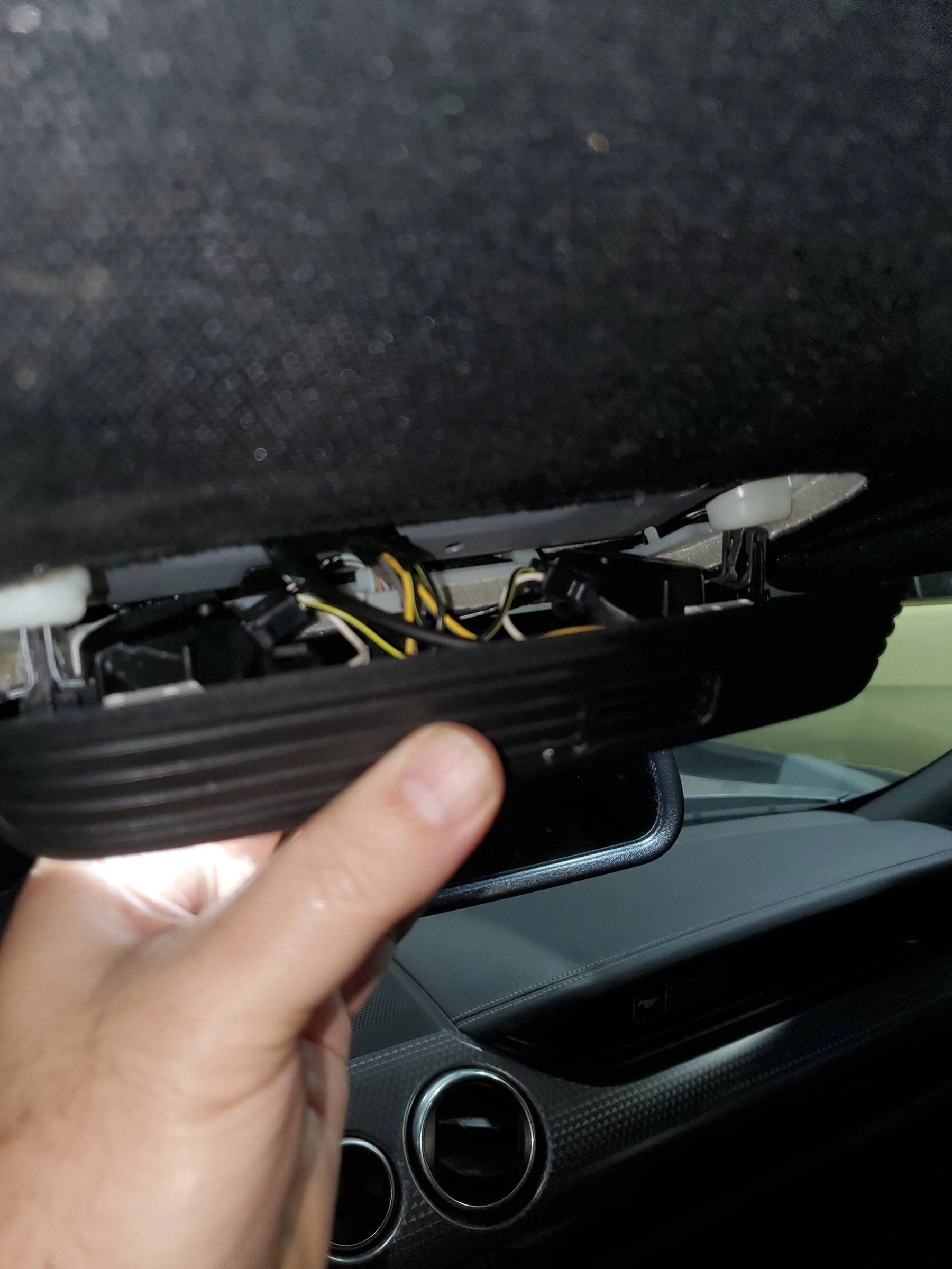

Man, I had to pull the assembly down a 1/2” so I can put the blue connector back in place as it pushed through. I didn’t brake the clips but when pushing it back up it doesn’t want to go back up and sit flush with headliner . What do I do ?

Never mind , I figured it out. I need to take the whole thing down and push metal clamps down to the base of the unit.

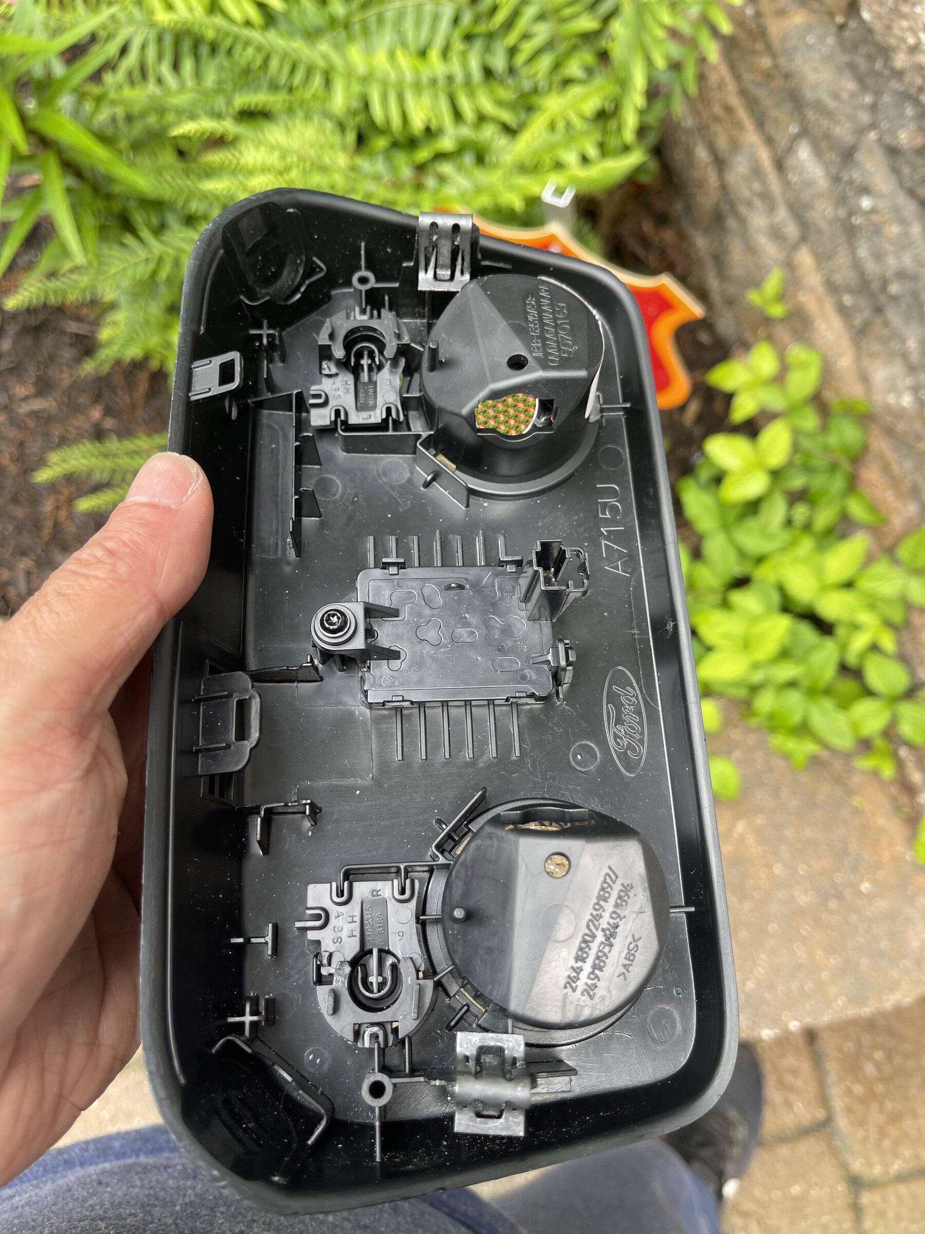

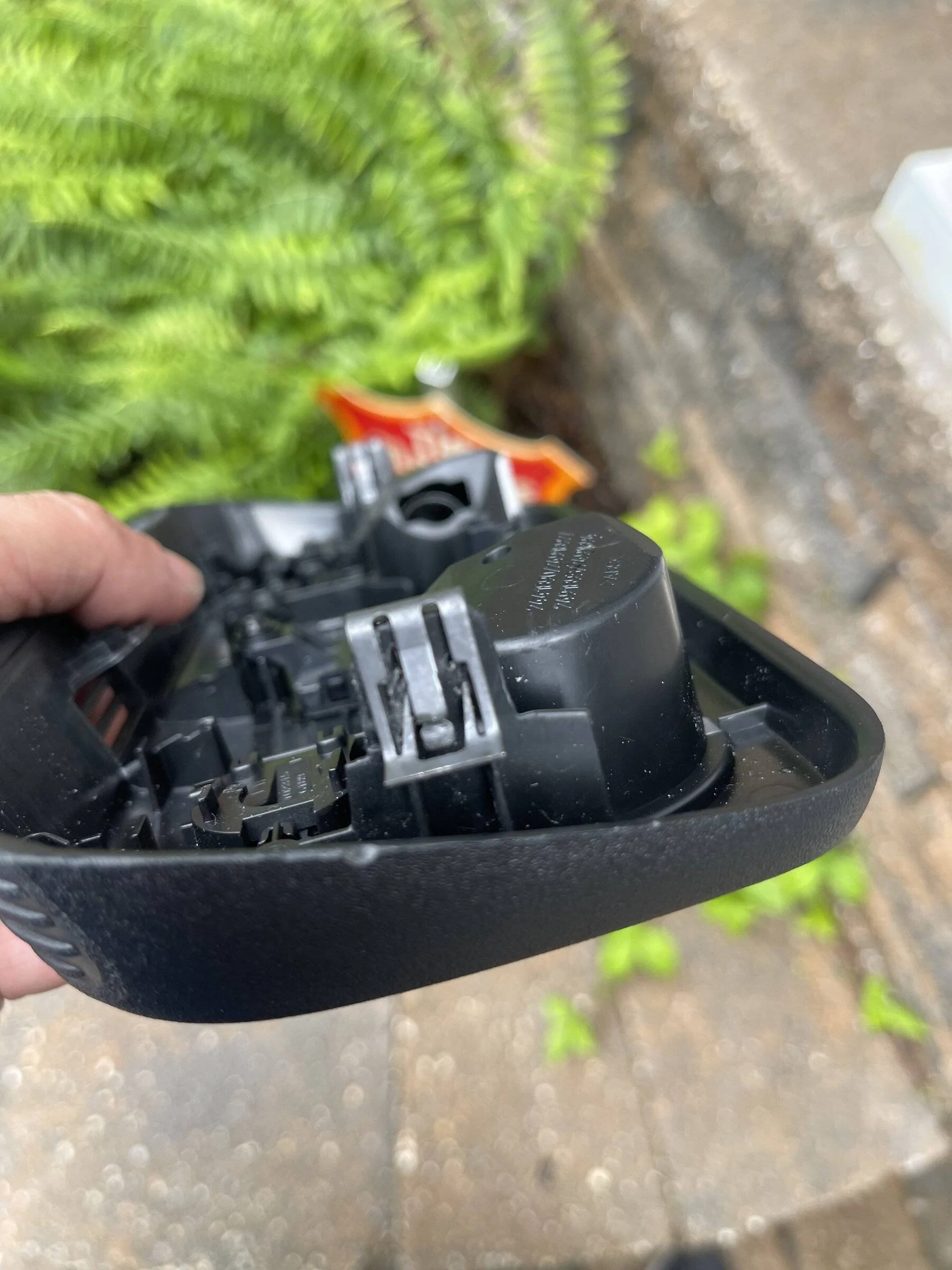

Exact same thing happened to me 🤬 left side went in fine, right side pushed the whole assembly into the housing. Had to pull the whole compartment out and broke the left clip. Time for some superglue and duct tape.

I was able to superglue the clip that broke off back to the housing to the point where it's flush now
