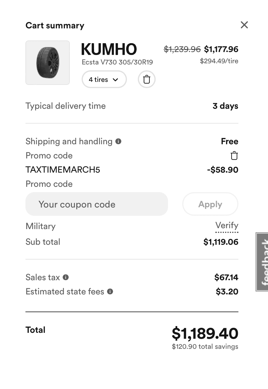

Anyways, there is a code now to get them less than $1200 shipped. Would like to know what others think of it as a track day tire. The only other Mustang I know is a GT350 that does autox.
