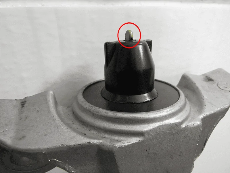

For anyone doing the Koni rears, I found that you can still use the factory dust cover by drilling a small hole in the top of it. And it still allows you to make adjustments with the tool.
