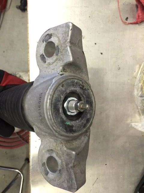

I had to ream out the hole in my rear top mount for the threads to fit through. Only managed to get one on in about 2 hours. I will post pictures whenever I get Tapatalk to work.
Not sure if my mounts are just a tighter fit, but I couldn't see how this would get past all the testing.

On the other side... The rears aren't that bad of an install. The second rear I did went much faster since I know what I needed to do. I just used a circular metal file to open up the hole and then finished it with a dremel grinding wheel to smooth it out. A drill bit would work as well.
It's just that they didn't clearly state anything about opening up the hole. If I would have had the details up front it would be a fairly simple install.

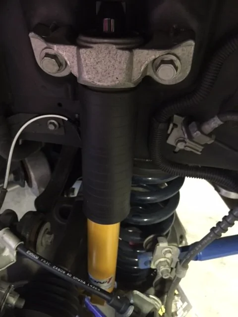

I got the shocks installed. Thank you David@Steeda for getting me these so quick and the recommendation! This is the ride I've been looking for since I bought the car, finally got rid of that dang bounce! Maybe the struts will further improve it but I'd be happy if I didn't even notice any more difference. For the struts, I'm more looking for the improved performance. For the rear I wanted proper dampening for the spring rate so it didn't feel like I was riding on springs alone.

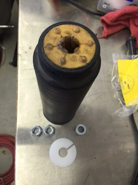

I'm no mechanic and have never replaced shocks before so take these comments with that in mind. These come with NO instructions. Replacing shocks on this car couldn't be easier though. Literally jack it up, take 4 bolts out remove shock and put the new one in. Quick and easy except for some of the details. You have to take parts off the old shock and assemble the new but there isn't any instructions to tell you how to assemble it and it's not like the parts are all the same as stock. I'll tell you what I did, maybe I'll learn I messed it up and maybe it will help others.
After removing the shock, again, that couldn't be easier, pull the dust cap off the top. It literally just pulls right off. I put a 15mm ratcheting wrench over the rod nut at the top and stuck the top of the shock into a vise to hold it still while I loosened that nut. Remove the nut, then remove the top shock mount, then pull the dust cover and bump stop off the shock. Then put the dust cover back on the bump stop if they separated. You will need to enlarge the hole in the top shock mount. Make sure you have a good quality 1/2" drill bit. I'm fortunate enough to have a drill press which made this very easy.
For assembly, I put the bump stop with dust cover on the shock. Then I put the spacer which rested right on top of the shock and then 1 nut and tightened it the best I could without spinning the shaft in the shock. Then I put the large white nylon washer over it, then the top shock mount, then the final nut. At first I tried the 2 nuts on the top in a jam nut configuration but there was a little slop in the shock mount and I didn't want noise so I changed it.
Then installing it was easy. Set it in on the bottom mount and put those 2 screws in, tighten to 35lb ft. I reused all the bolts although Ford identifies these as 1 time use. Then compress the shock a little and position the top shock mount just under the 2 guide pins and put the top bolts in. Tighten to 66 lb ft.

From DickR's post linked above :
"For those of you planning on installing Koni Sport shocks in the rear be prepared to enlarge the nominal 10 mm hole in the oem upper mount to nominal 12 mm. A 1/2" drill worked fine today for me. Koni indicated that the 12 mm shaft is needed since it is hollow for the internal adjustment shaft which therefore requires greater outer shaft diameter for sufficient strength. The shocks do not come with bump stops or dust covers so you will need to transfer those."

Did you have to bore out any holes like above posts? Confused how that could have happened when Steeda was evidently involved in the testing/design of these...
Yes, mentioned in the 3rd paragraph. You need to enlarge the hole to 1/2" in the top shock mount for the shock rod to go through. Thanks to DickR who shared that in the other section. As he said, the reason is because it's adjustable, they needed to make it a little larger because of the internal adjustment.
