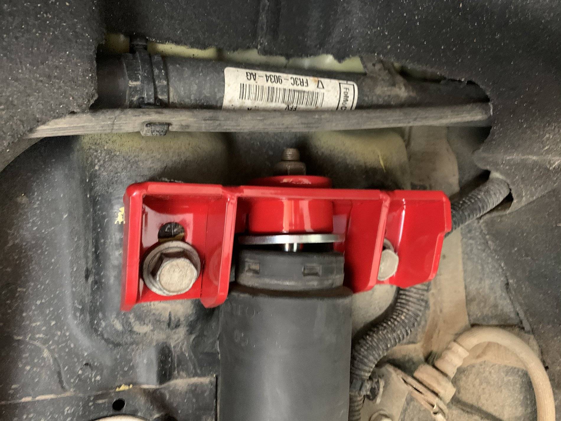

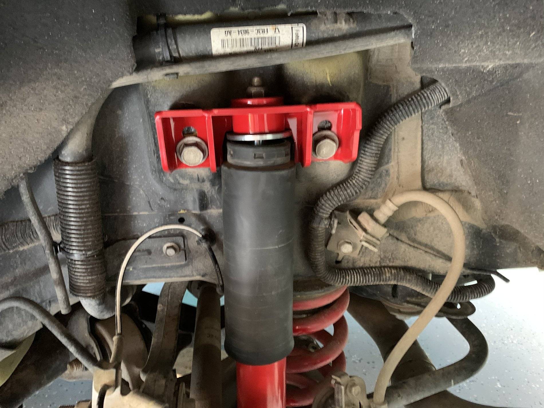

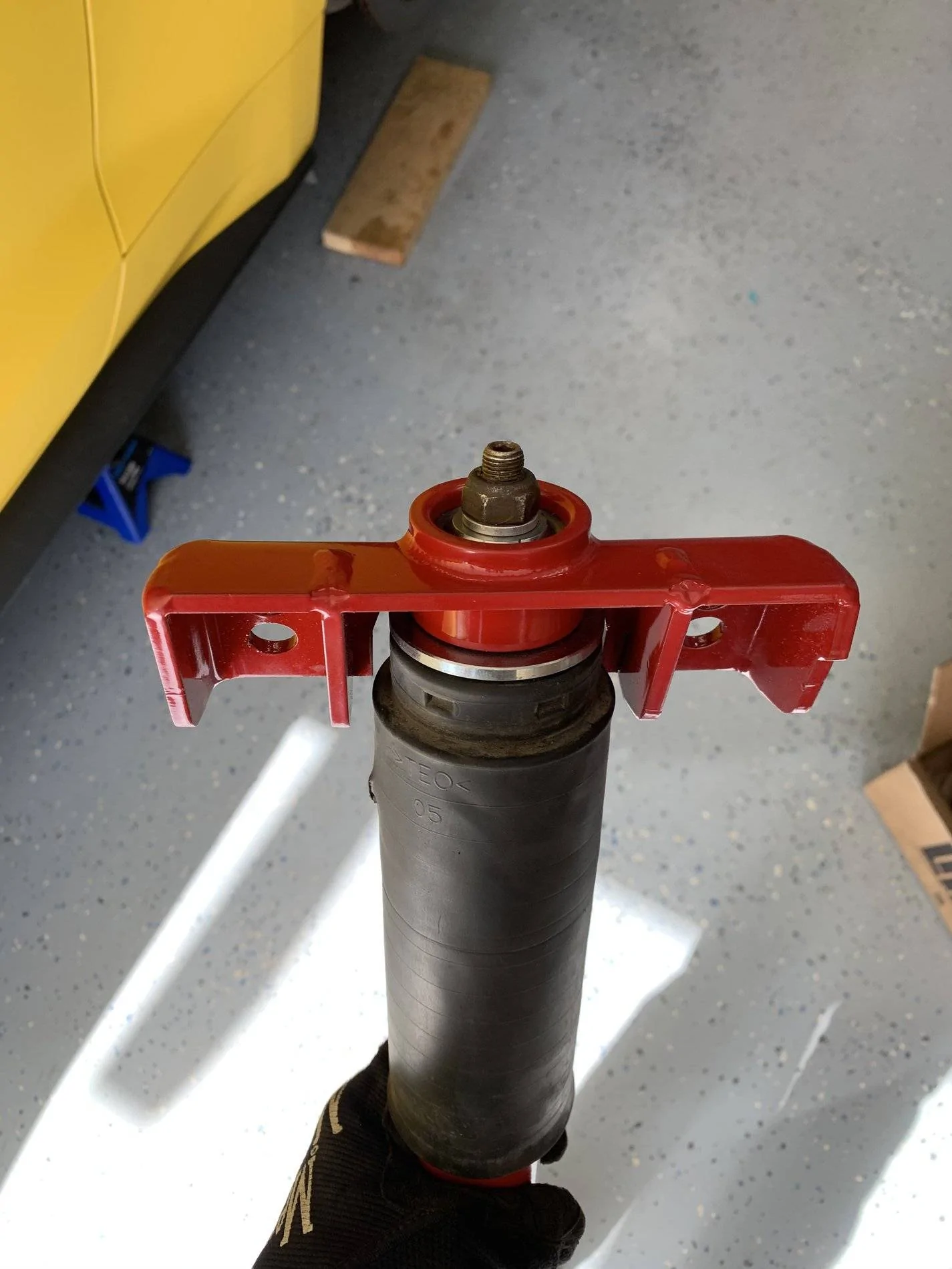

J&M shock mounts finally installed! Used the lower mounting holes after cutting off the sheet metal alignment pins.
Consensus: been for 4 different cruises to enjoy the car and feel these new mounts out and I’m pretty happy. The have some minor noise over repeated broken pavement but it’s imperceptible with music or windows down, even with the rear seats down. Overall I appreciate the additional bump travel that allows the Konis to work properly. The bearing performance is solid, ride is a little better with a firm stable feel and rear grip/handling is planted.
The gap is only there because suspension is at full droop. Had to raise the lower control arm/spring perch with a jack to mount the shock on the lower mounting holes. No issues with install of the mounts.
I plan to look for some dust caps for the top of the mounts because I can’t have winter grit and shit getting in the bearing and ruining everything.
