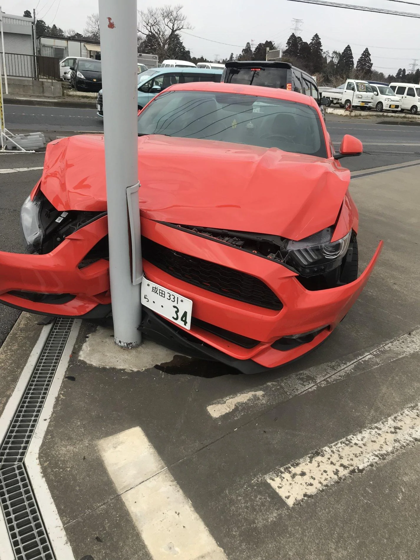

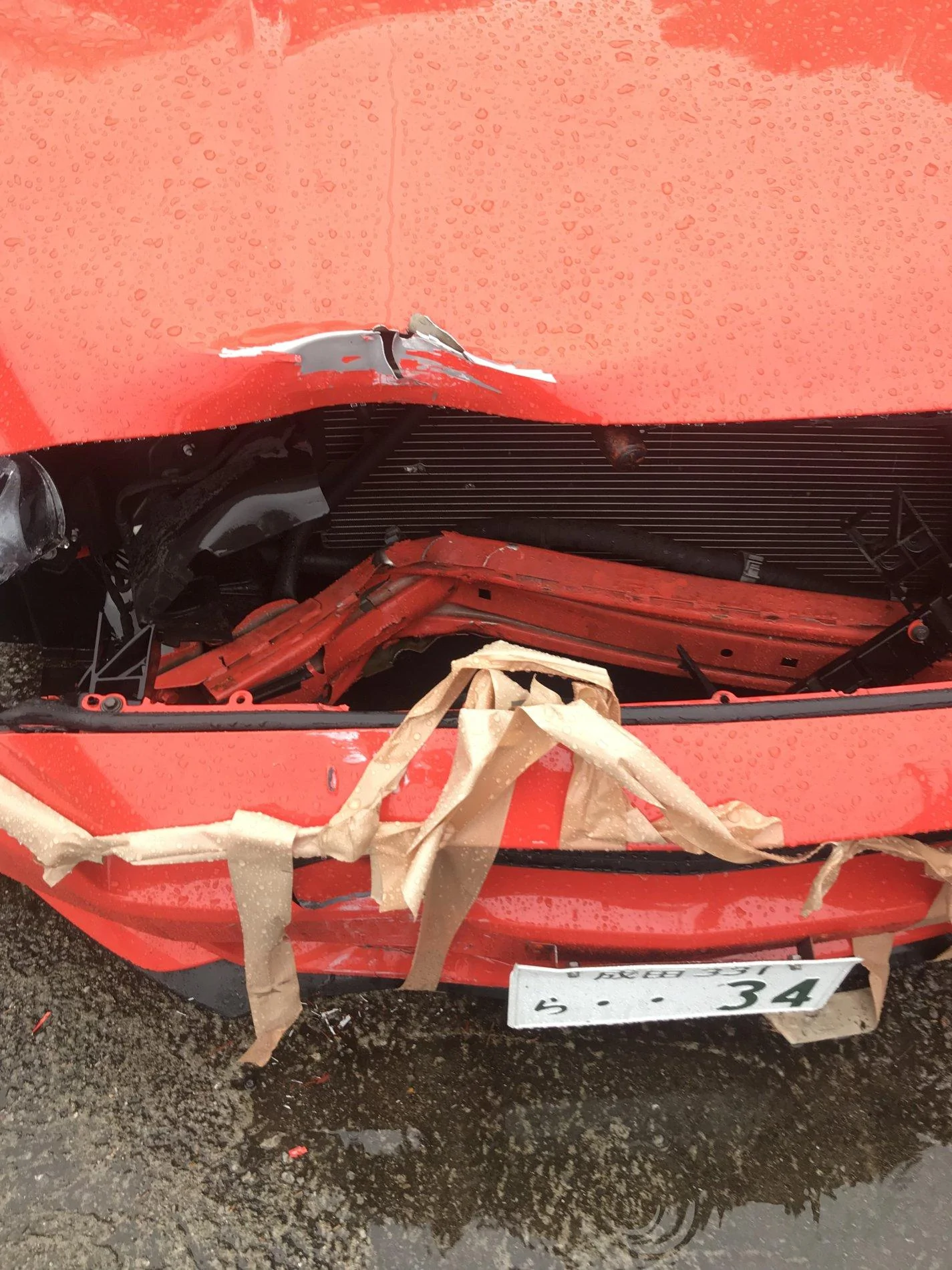

Thank you for detail
I was in parking lot and the pole suddenly hit me for no reason
Only knee airbag deployed and yes there is red light inside on
AmericanV8Guy
Sep 8, 2018
195
218
2016 Mustang GT PP, 2016 Corvette C7 Z06
I would be more concerned about quite a few other things in your case other than the airbag.
