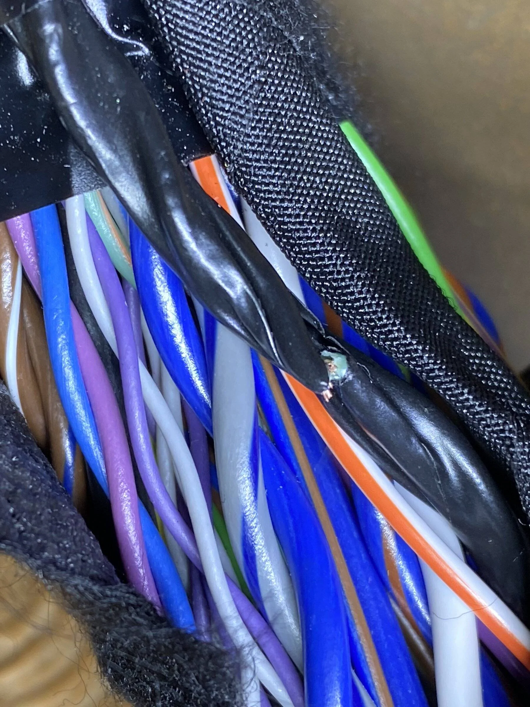

Well, after some extensive troubleshooting and following the service manual, I found my issue. I did actually swap sensors to start and the code did not change. Somehow I did this when running sub wiring. I must have snipped it accidentally when I removed some wire ties.

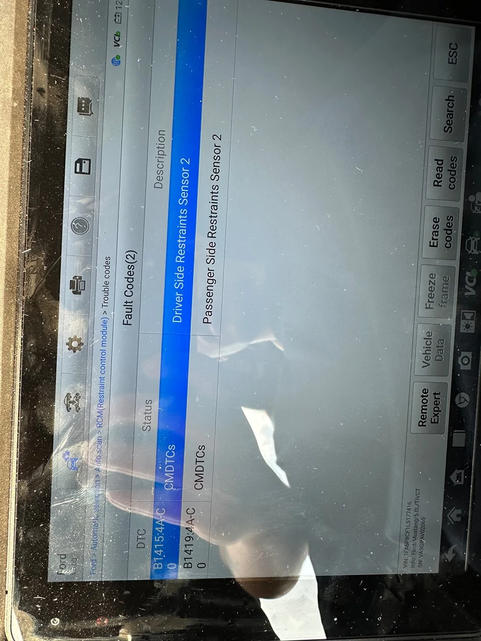

I’ve been putting a wrecked 2020 mustang gt back together and have gotten everything fixed and back together except I can’t seem to figure out these last two airbag codes that are keeping the airbag light on. You said yours is driver/passenger side restraint system sensor 3… but mine says sensor 2.. I’ve replaced the two impact sensors on the sides. And erased the codes but the CMDTC still pops up. I’m guessing there is still a fault as I’ve done a couple of drive cycles already and is still there. I’m guessing the regular dtcs have popped back up too. I can’t seem to really find anything online about diagnosing this code. I e checked wiring and it seems like I have no cuts or anything. Idk if maybe the used seats I bought actually are no good and causing this code to stay on. I don’t have forscan so idk if maybe the dealer has to reset these codes. But it’s the last thing I need to do to be able to get a brake and light inspection done to be able to register this car already
