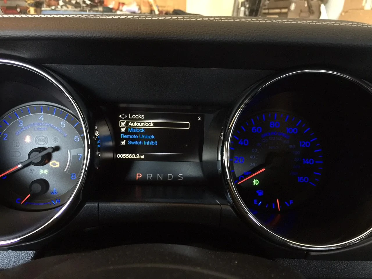

Has anyone tried to disable the passive entry through the car settings? The link that Grimmace posted seemed to show an option for this.
[/QUOTE]
Since I haven't received my car yet, I can't play with this menu and don't know what these options do.
