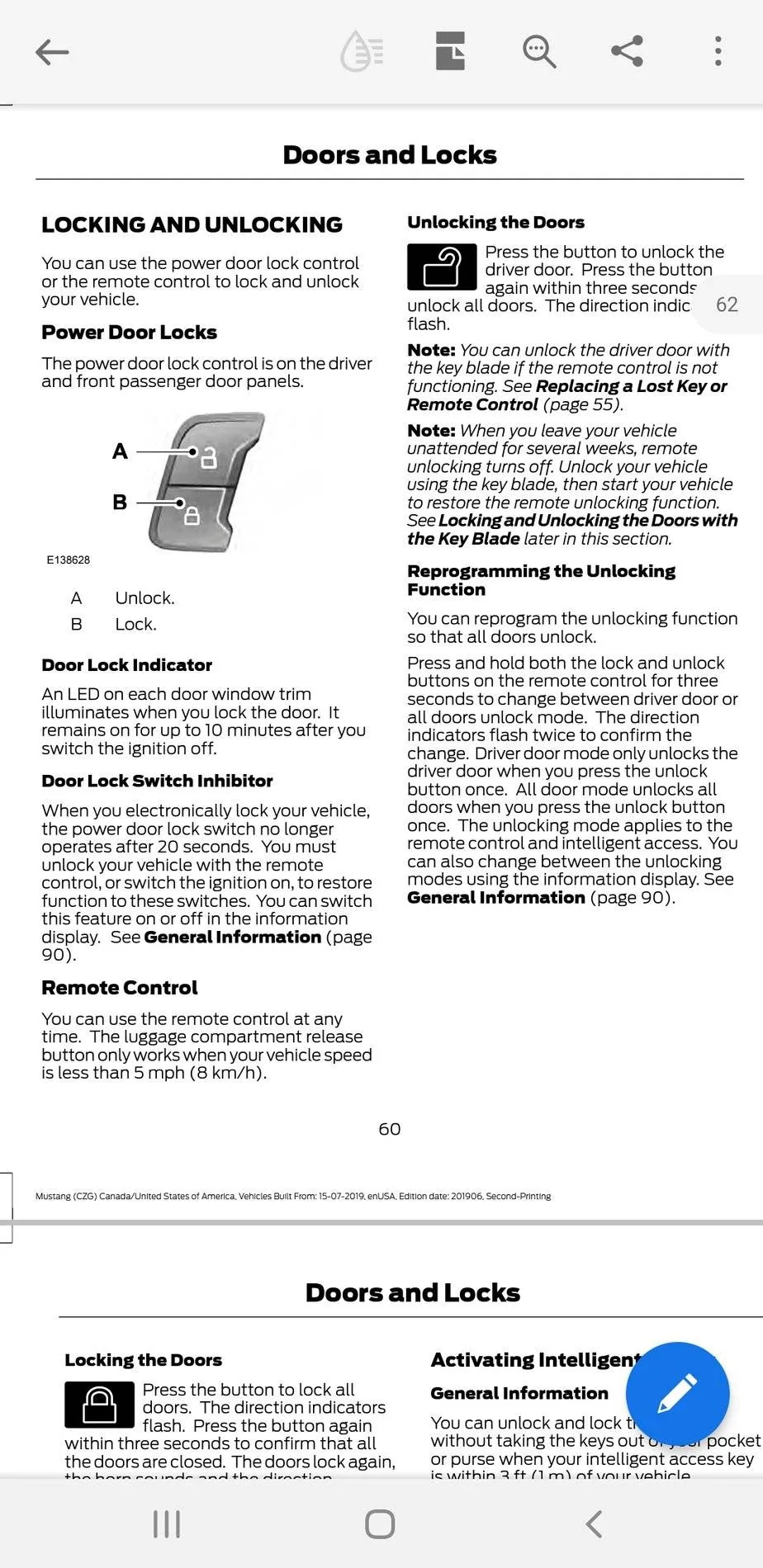

Here it is, I was right. Your issue might be a proximity sensor issue.

I think this option is for when you leave the windows down and you lock the car people cant unlock your door with the switch. I will search the owner's manual.
Yeah, this is NOT the fix. you may be right. I still had the issue and fixed my post.
