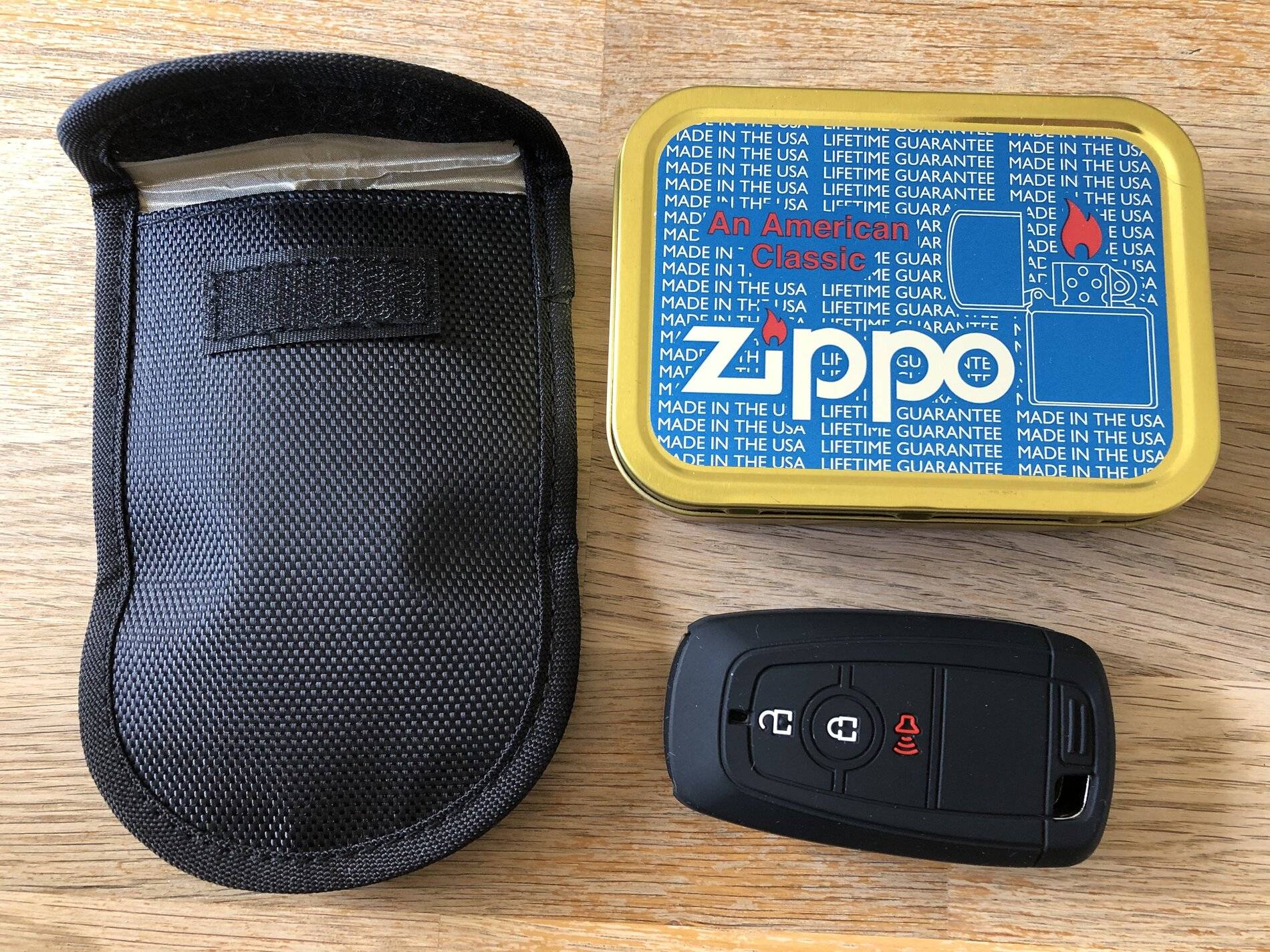

Yeah keep the keys far enough inboard from your house walls - I have seen videos of people walking around the hose walls / windows trying to pick the signal up.
Someone told me the microwave is a great place for them as it’s a professionally designed faraday cage ... lol.
The bags work (or at least mine do) - they are also easily checked and I suppose I should do that periodically to ensure the lining doesn’t break down with age.
Tins don’t work, I have tried.
WD :like:

Completely closed tins???
Norm
Yes, I was quite surprised.
I bought the tin to keep the key in it in the house and it’s pointless, I can put the key in the tin with the lid on, start the car and drive away.
Perhaps when the fob batteries age a little the tin would be more effective, but I have bought the pouches now anyway - and the type I bought work well (even with new keys ... lol) :like:
