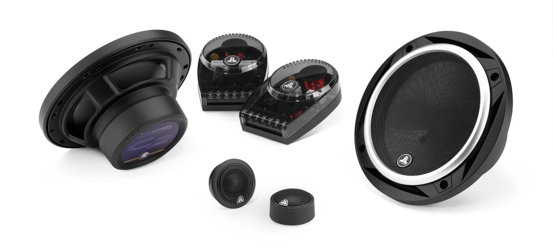

For anyone interested.
C2-650 Evolution set in doors
6.5-inch (165 mm) Woofer, 0.75-inch (19 mm) Silk Dome Tweeter

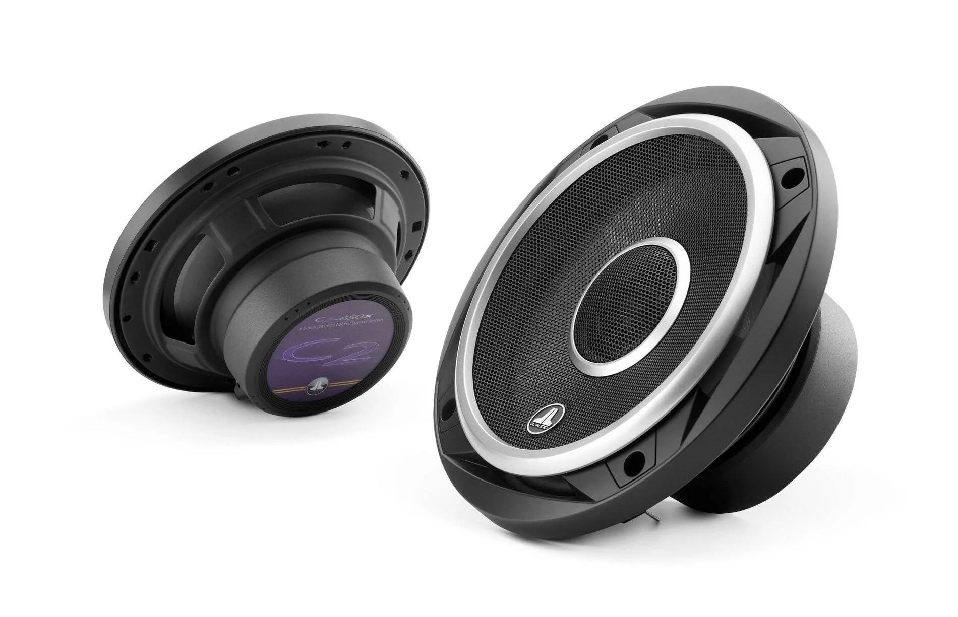

C2-650x in rear deck
6.5-inch (165 mm) Coaxial Speaker System

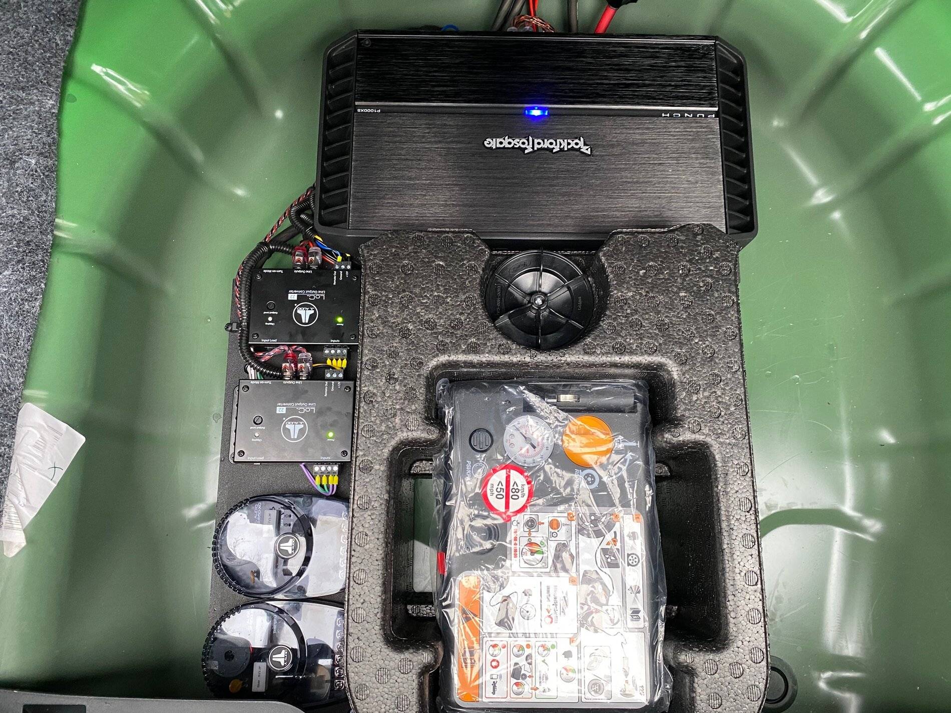

Punch 1000x5 powering the system, with JL LC's
The birth sheet had the amp at around 125x4 and 500+ on the sub channel

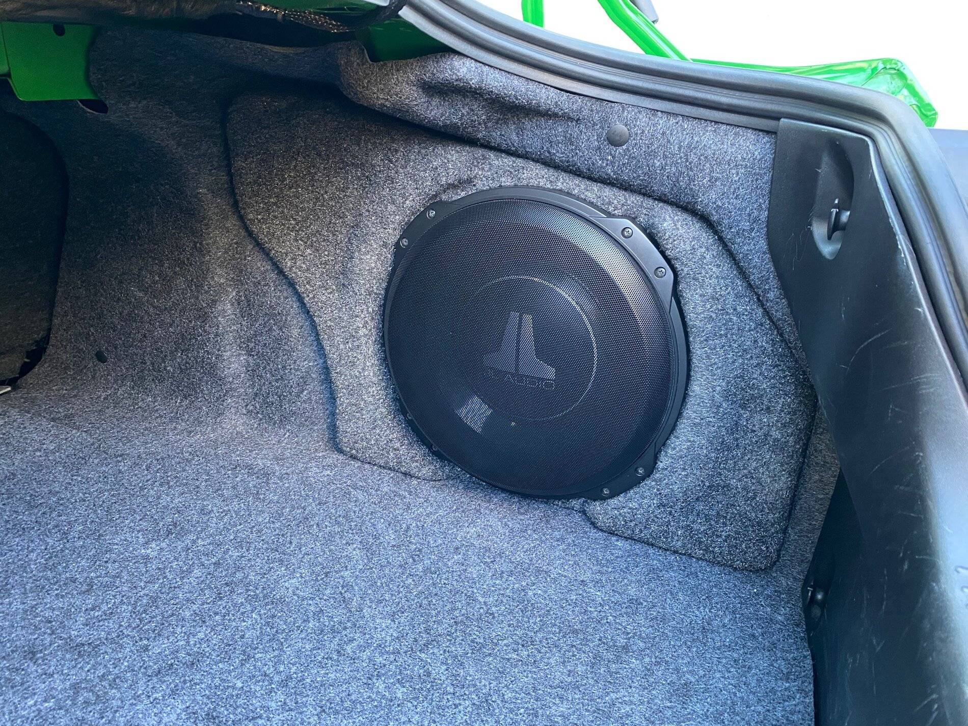

JL Stealthbox
I'm a rock, rap, dirt road/outlaw country fan, so it will take some tinkering with the radio EQ. I don't have much time today, but I played some rap with clean bass, and I took the treble a good way down, some mid boost, and some bass boost, and around 15 volume it sounds/feels great and you can see the bass working the rearview mirror. With the punch amp, you can find out the clipping point, mine was 22 volume. To be honest, with it all in, I doubt I'd exceed 15 lol. Just wanted clean sound with some thump, and this does .

Punch is $499
The six JL speakers were $470
LoC's were like $90 each
Stealthbox runs $880

Install looks good! Keep and eye on your speaker grill and let us know if if shakes itself loose from the bass. Mine did. I haven’t put it back on yet, but will before I drive the car again.

I popped the trunk one day and to my surprise, the grill was laying flat on the trunk floor. Put it back on and shortly thereafter, it came off again.

Yeah, mine was laying on trunk floor when I got home lol. I read they could be an issue, and I was thinking a few dabs of clear caulk if it keeps doing it. Dont want the sub getting hit when I drive like I stole.

Oh and the grill continues to be a PITA, I think I will be using a couple of dabs of clear silicone.

Dab of clear silicon on the top, and each side fixed the issue. Good and secure now.

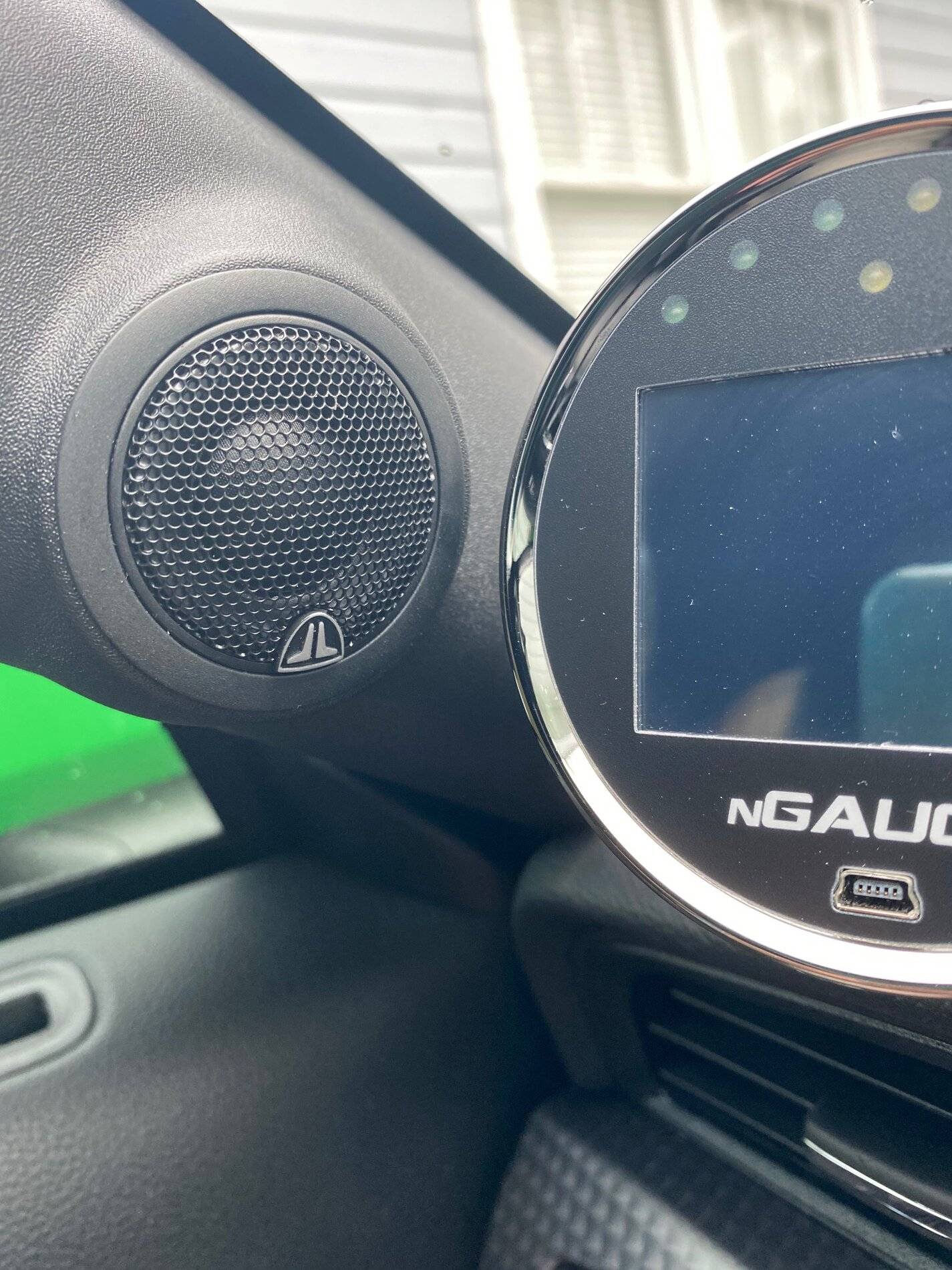

Have you tried attenuating the front tweeters at the crossover? There should be a -3db position that is recommended for tweeters mounted up high and closer to the driver than the mid/woofer. That would tame some of the harshness on the high end.

Cool! Did you put the silicone on the speaker grill, or in the channel that the grill presses into? Did you let it dry before putting the grill back on?
Looks like you have a quality setup there. :thumbsup:
No, but I will check that out! It does sound really nice, Im usually using 13-15 volume, and with the windows up it is a nice balance of rock and thump.

I put a dab on 3 spots of the outside of the speaker grill, where it flattens and goes in the channel. I then pushed it right in all the way and left it overnight. You can see anything, and with just 3 dabs, it wont be hard to remove.
