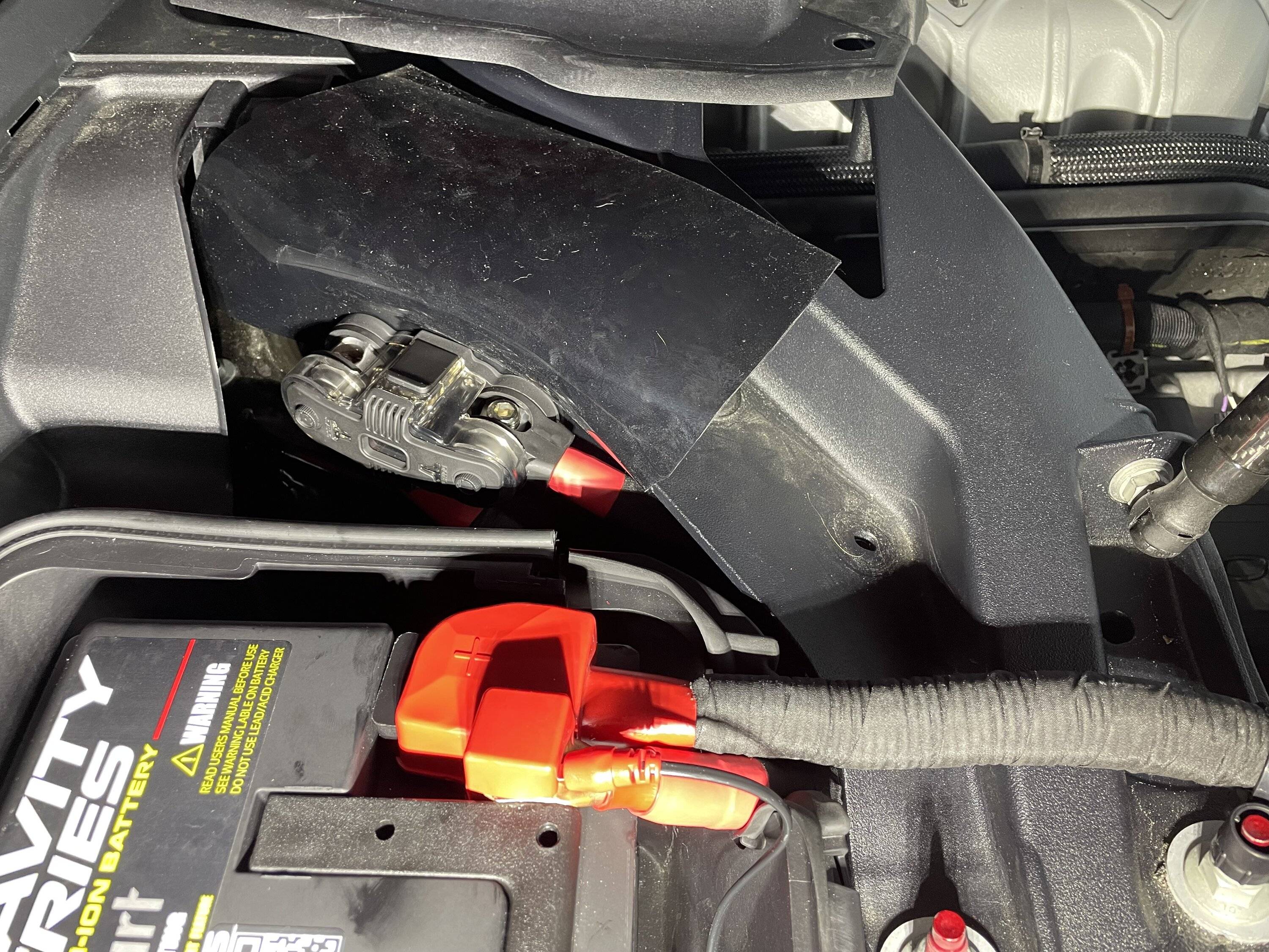

That’s an awesome and very clean professional install.
If possible I would be keen to see a photo or two of the wiring up by the stock battery.
For the sake of learning 😁
I recently was trying to do some wiring and ran into the snag of how to connect in my fused main power wire…
I mounted my fuse block to the support brace just inboard of the battery box. It’s easy enough to run my zero gauge back under the closeout panel and into the fender well.
