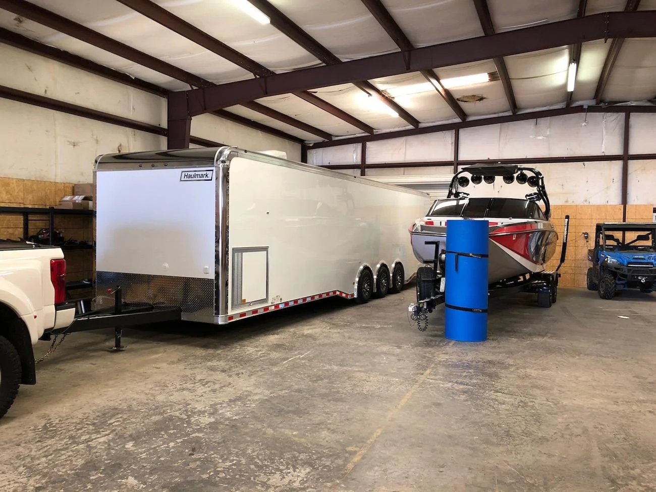

A few goodies came in today.
New trailer, last one grew legs and ran away. So this one will be staying inside the shop!!

That trailer is PIMP. But you must be skinny with no door on the driver's side to get out...or gonna winch it in? I sold my enclosed last year because couldn't get in/out of the Mustang. Need one of those ATC trailers that the whole side swings up.
Defiantly gonna winch it in and out. I’m over climbing out the window. Lol
