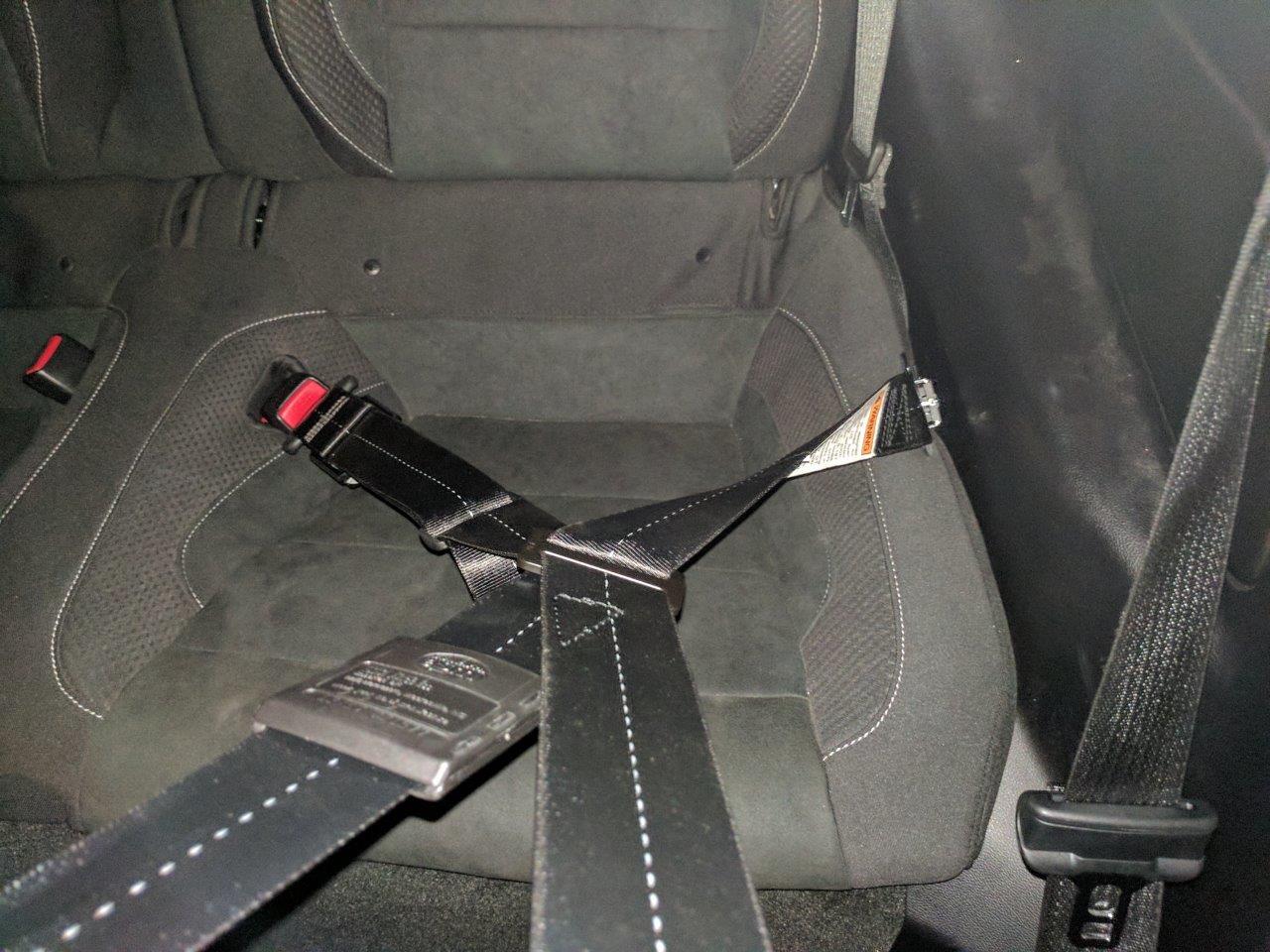

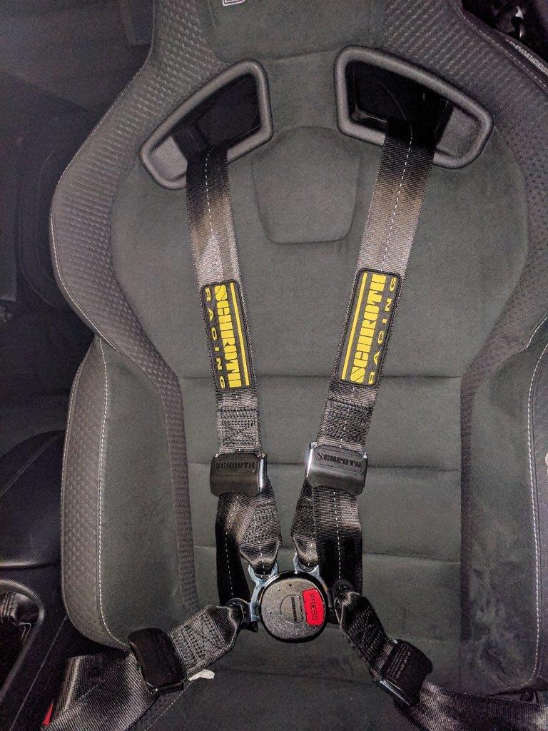

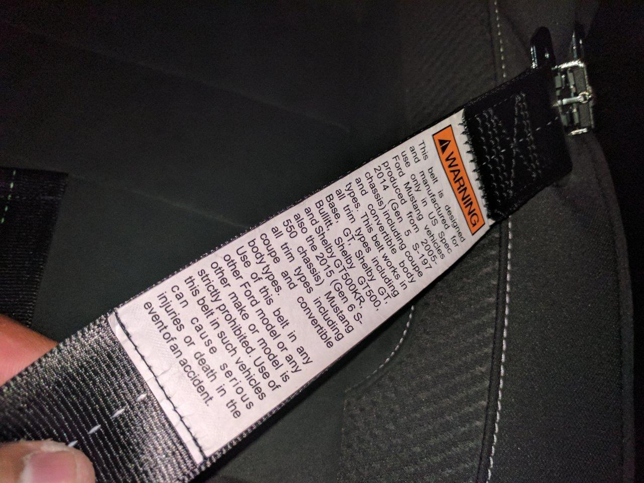

Ill cross post this. Since the GT350 is already heavy Im hesitant to do anything that will add weight. I was looking for a harness solution that would be HPDE accepted with out a harness bar. After speaking to Schrotch and NASA (the most strict apparently). The scrotch using stock mounting points and eliminates the need for a harness bar. It is also certified for the for the 6G mustang. Nasa confirmed they would accept them.
