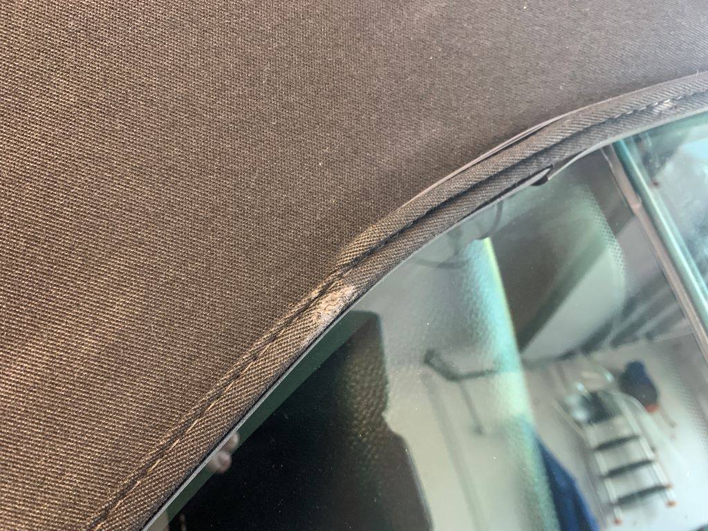

When I purchased my vert used, it had one place that concerned me. It appears to be from a snag/abrasion from somewhere down in the storage "pocket". It hasn't worsened since I purchased the car a little over 4 years ago, thankfully. I'll try to take a pic later for you to see and compare.

Here's a closeup of the damage I have. Not sure what contacted the fabric to create that issue.

Interesting. So Mines in a similar spot but on the inside of the window

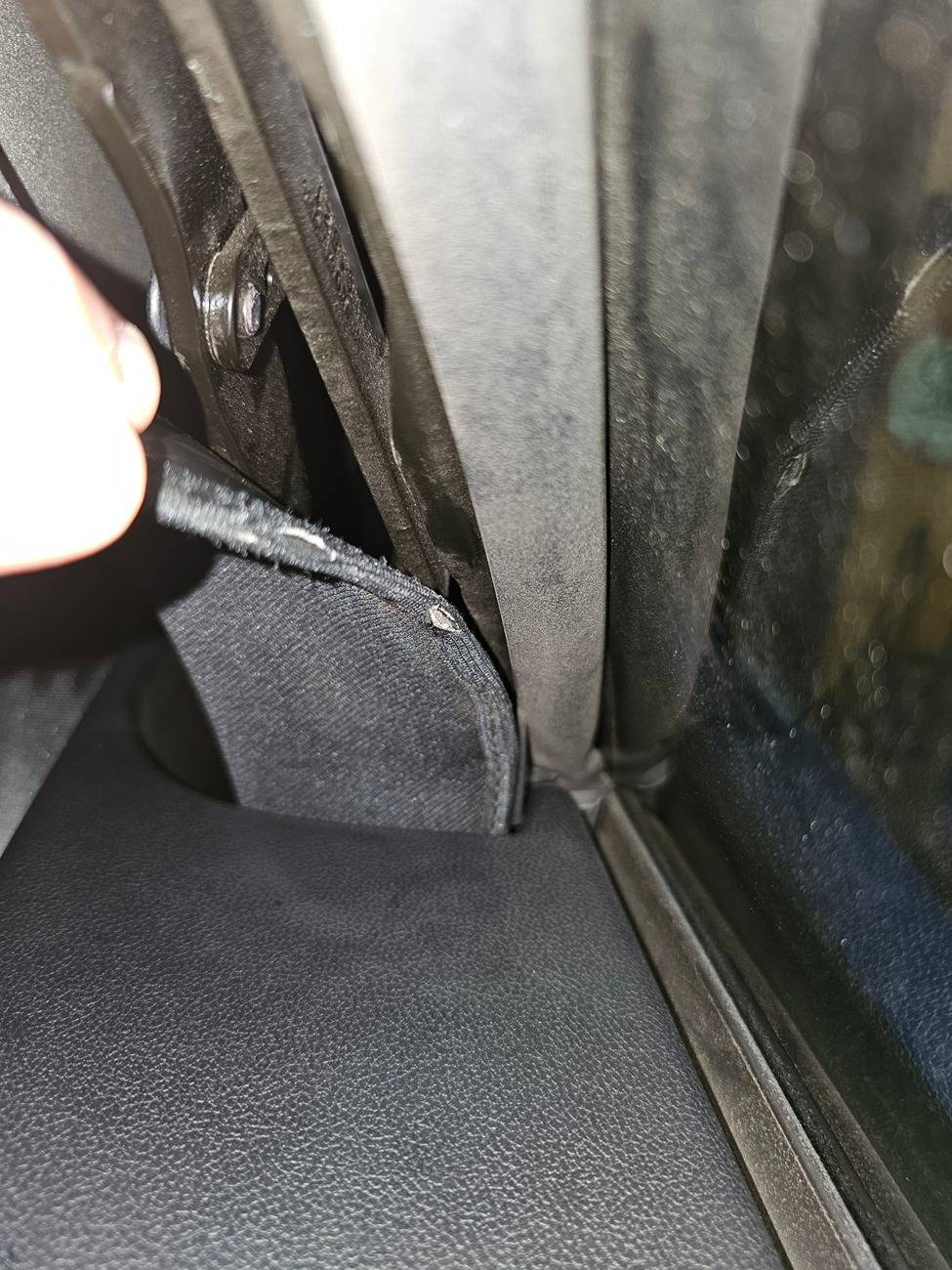

Finally got movement today after talking to the service manager. Said he got a new top on order 7 to 10 days. He didn't mention any adjustments, I'm wondering if this is going to be an issue in another 10k miles. Here's a Pic of the wear it's similar on the other side.
Indeed that is a down-the-road problem, especially if you don't have it taken care of under warranty. Hopefully I don't have an issue in that area. But it would be good for me to check, and get it fixed.
