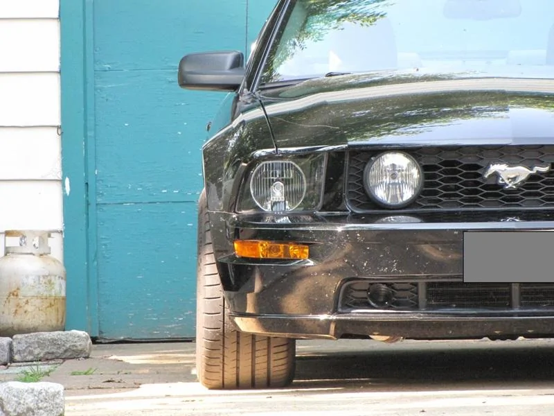

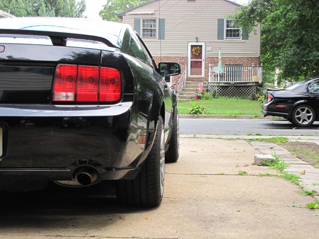

I think it's fine as long as the actual tread is under the metal as seen from above. A little sidewall bulge past the metal is OK, and I also think that you can get away with a little more poke up front.
It's a track day setup ↓↓↓ . . . but it's still entirely streetable and rock chips from my own tires hasn't been an issue at all. The bug suicides and what-not on the front of the car are what they are. 285/35 MPSS on 11" wides, all four corners.
