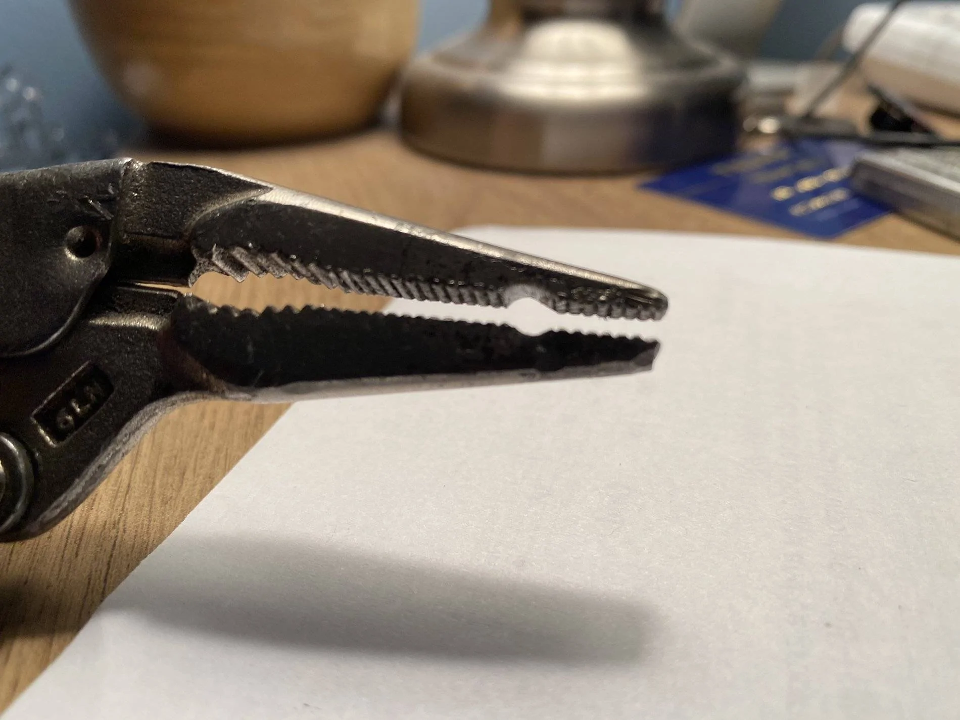

Check this video out, enlightening, With the new spring, peddle has a more consistent feel in and out. Gave the Ford spring. 1k miles of seat time to adjust to the feel.
To remove the Ford
spring grind a notch in the jaw of the channel lock needle nose. You can thank me later.
