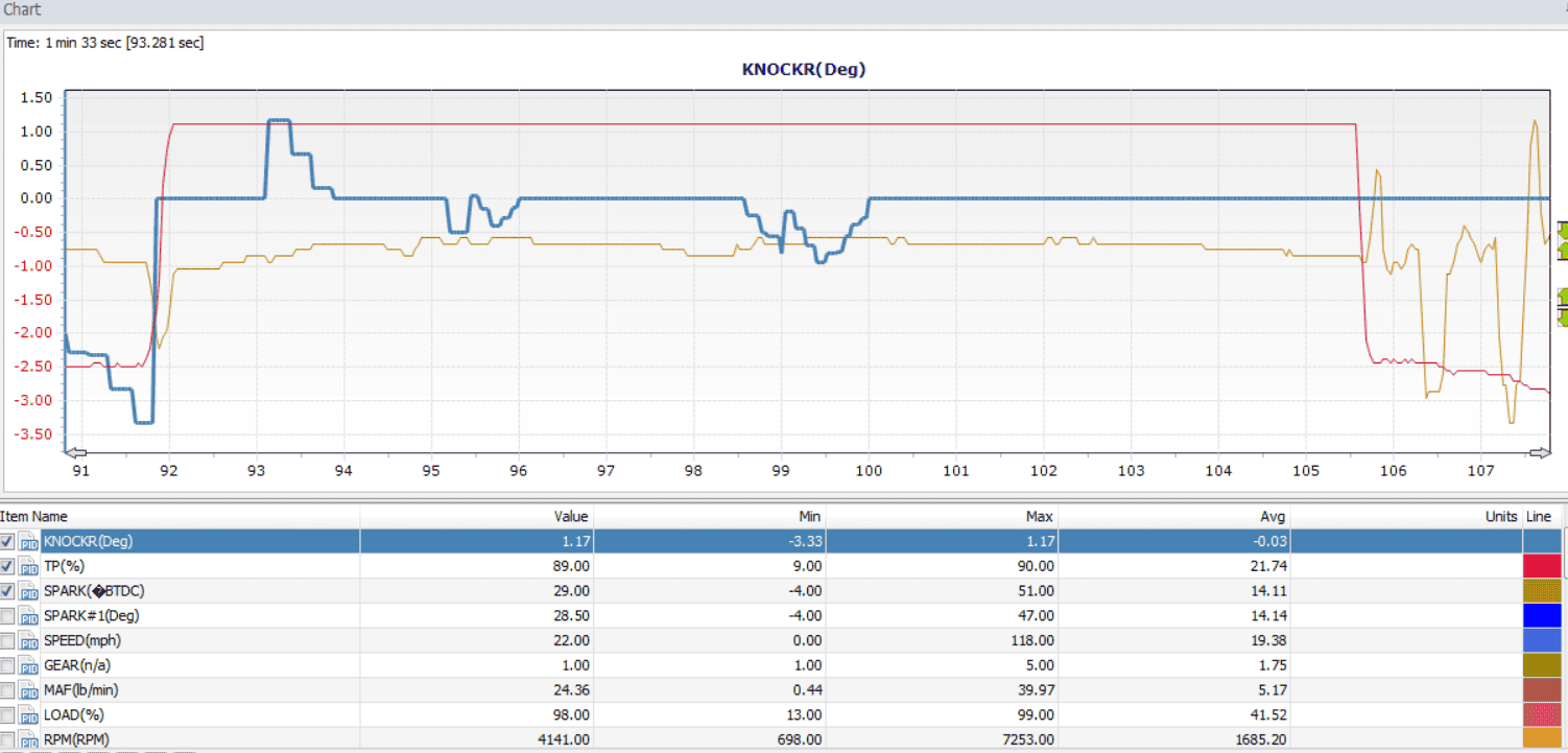

In one of my logs I found between 3600 and 5000rpm I am experiencing 1.5 knock only in 1st gear. I will check my other logs
K4fxd
Apr 2, 2020
122
13,494
12,323
NKY
Dan
2017 gt, 2002 FXDWG, 2008 C6,
When you say knock what does the number look like and what PID is it?
Can you post a screen shot? It might be adding spark and not removing it.

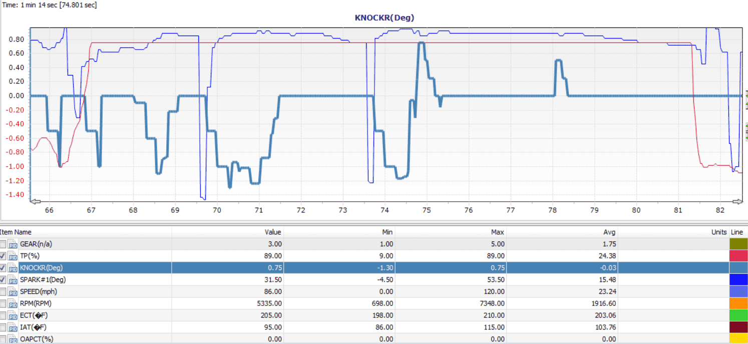

Here is another log... this time knock in 3rd gear? so weird

Yes that is pulling 1 degree from 93 to 94 adding .5 degree at 95 and adding 1 degree at 99.
I don't see anything out of whack.
