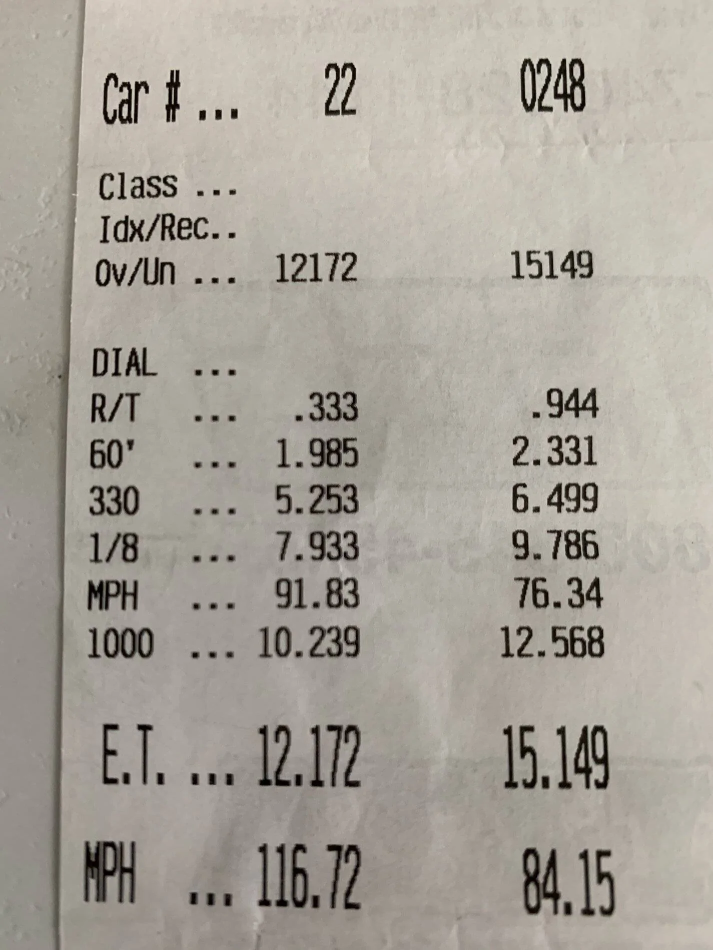

I want to make sure I am not doing something wrong. Does this run here at a track seem like a good quarter mile run considering my mods on my car? Mods are in signature.

I was just seeing if this is a good time. I am trying to get into the 11's.

By the way on this run, my track time slip was 12.1 and my 60ft was 1.8

We'd be even steven. You should be much quicker on a fabulous PBD E85 tune however.

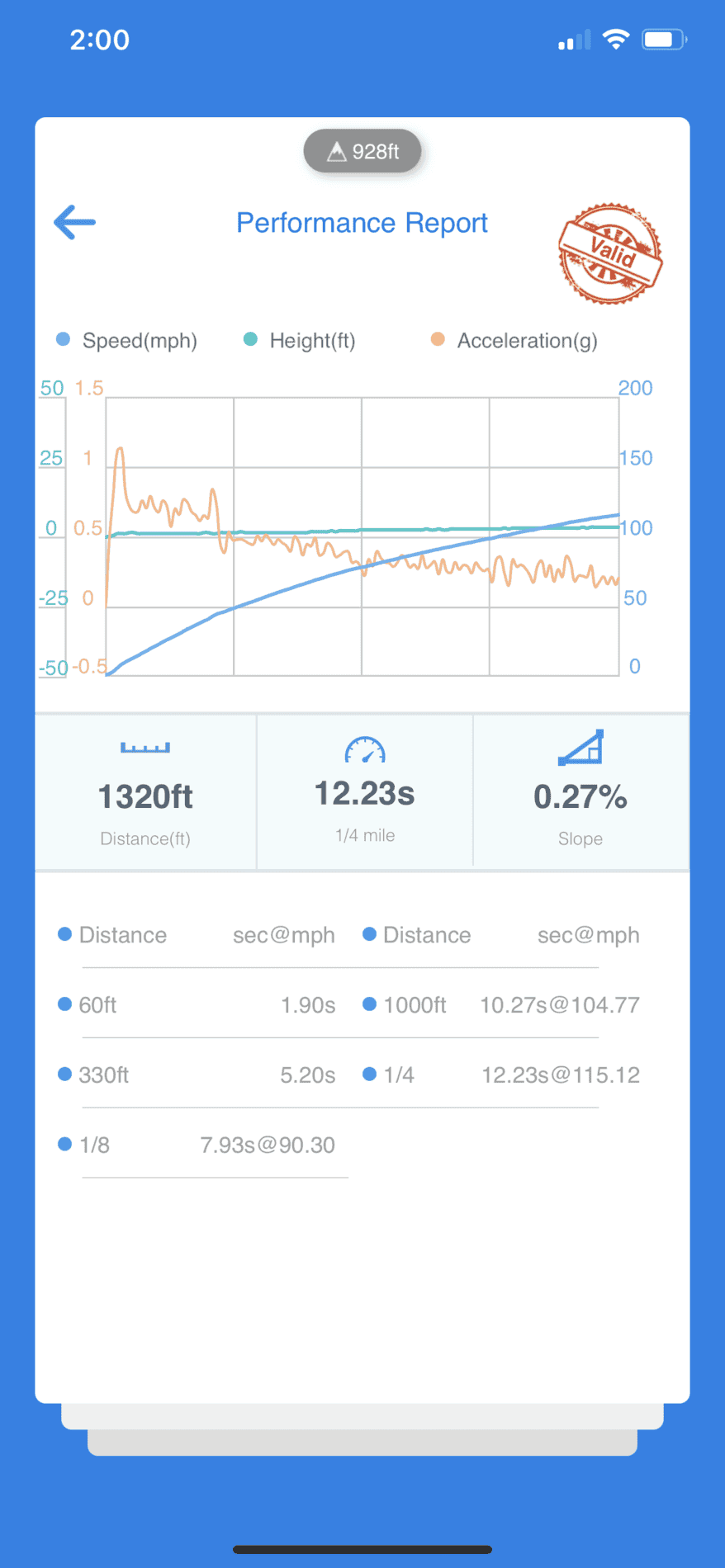

Hmmm would my DA result in a worse time than yours? I think my intake temps are killing me too. Or maybe I need a 5 gal drum of real e85?

Post the actual time slip

Actually my 60 foot was 1.9 on this run. I think I spun just a little

What was the DA?
What was the IAT at the start of the run?
Time and MPH seem low for mods but the above 2 items can make a significant impact.

DA was about 1500 and intake temp was about 80ish

I think I need a better 60ft. What is everyone launching at? Seems like my stock converter gives out around 2100rpm

Given your DA and IAT, I agree, your 60' is slower than what should be expected with MT ET Street SS. Sounds like you are launching as high as you can. Are you spinning or bogging on the launch?
What is your burnout procedure?
