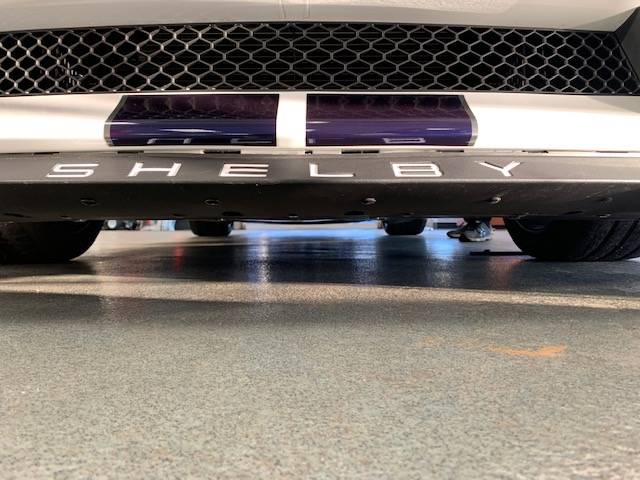

So, after reading and watching video and pictures of front splitters I looked at my(see pic below). I went to my dealer where car was purchased new. The guy who I know previously(he installed splitters before and is familiar with the process), put the car on the lift and examined the splitter. He showed me that all the hardware was installed and assured me that the splitter installed properly. When I mentioned the YT video, he said that he watched it and said that they don't like to use mallet hammer. He gave me his word that the splitter installed correctly and the gap seeing on the pic is within the Ford specs. He also said that the gap should be there to prevent rubbing splitter against bumper.

If you don't use the mallet, the tabs will not click into place. Does not look fully seated to me. Can you get a mirror to the back side to see if tabs are in? Check those 4-45deg screws in the middle too.

It is not fully seated. Mine looked the say way. I used the mallet and paper towel roll and knocked the shit out of it. Click, click, click, fully seated with no gap. Your's is not properly seated and fully secured.
The dealership guy is flat out wrong.
