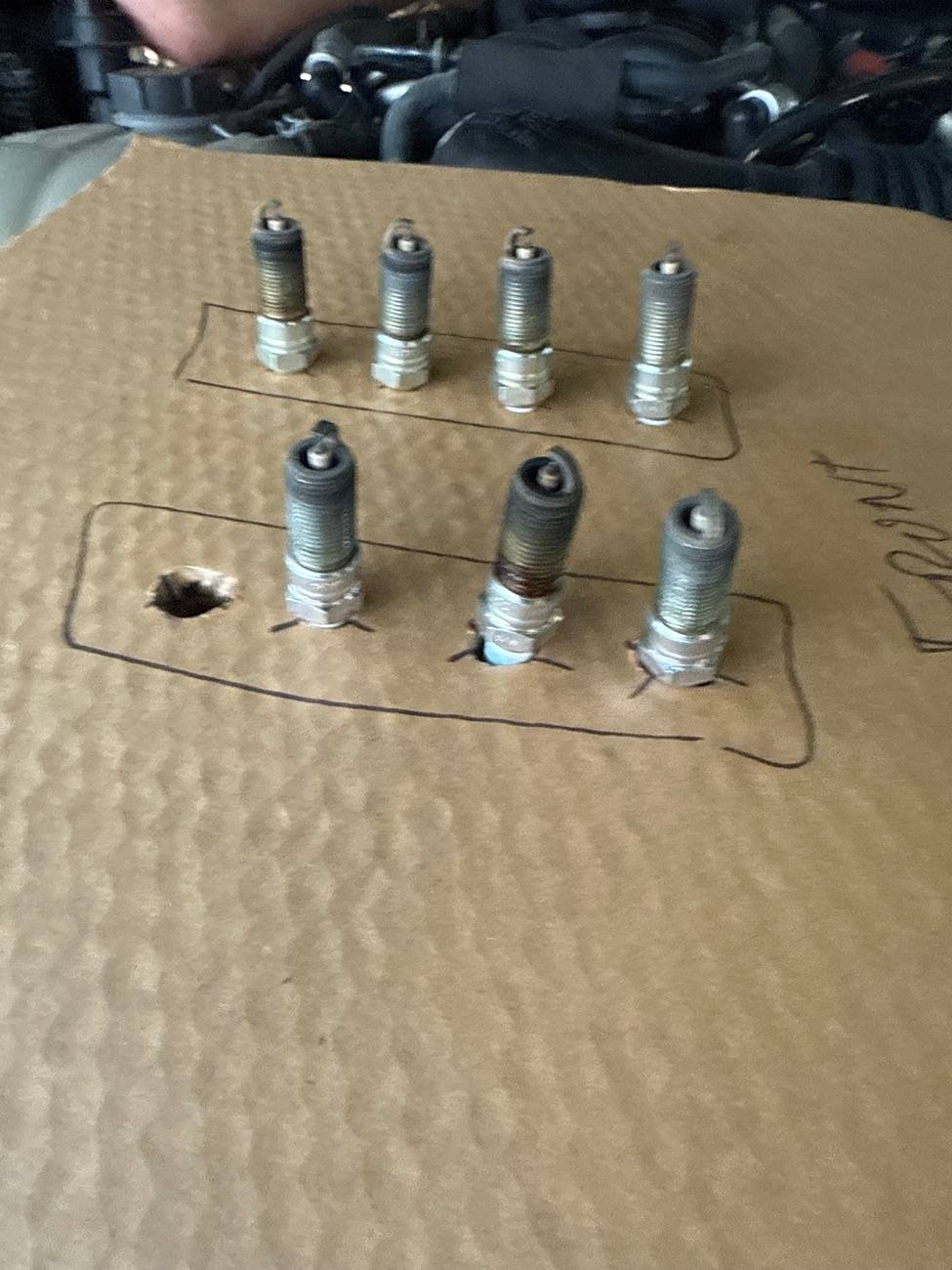

I also did my plugs a few weeks ago they looked like this only two look funky other all other ones were fine in my opinion last one was good too lmk what you think plz and thank you!!!

Why list "exhaust" and e85 as the only thing done to it when it's been tuned. Tuning brings more issues than any and everything else combined.
ORRadtech
Sep 12, 2019
4,051
3,987
Atlanta, Georgia
Doesn't e85 alone mean it's tuned? I mean I don't think these cars will run on e85 without a tune.
I agree with the sentiment that he seems to be downplaying what's been done to the car though.

Personally, see if you can find a local tuner with a Dyno. I had my car tuned by a couple different places and I got tired of sending data logs and re-tuning the car over and over to get it right. I took it to a local performance shop and let them run it on the dyno until they got it right. Been running GREAT with no issue for over two years on that tune.

I saw E85 and headers and stopped reading. All I'll say is my Gen 3 is running like a top with 93, the OEM tune and stock headers. Lmao
